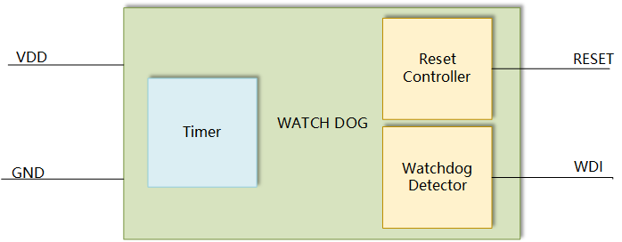

Typical hardware watchdog diagram:
As shown in the diagram, the basic structure of a hardware watchdog is like this. WDI is the input, and RESET is the output. When WDI detects a level change, it is considered as feeding the dog and clears the timer's count. If the dog is not fed within a certain period of time, the timer will time out and trigger a module restart through the RESET pin.

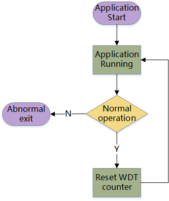

Software Watchdog
Principle of software watchdog: Similar to a hardware watchdog, a software watchdog is implemented using a software timer. It is generally used to monitor the running of specific threads, and the monitored threads need to reset the timer regularly.
In some cases, some business threads become blocked or exit abnormally, but the whole system remains normal and cannot trigger the protection mechanism of a hardware watchdog. A software watchdog can monitor one or several specific threads and trigger a reset when these threads encounter exceptions.

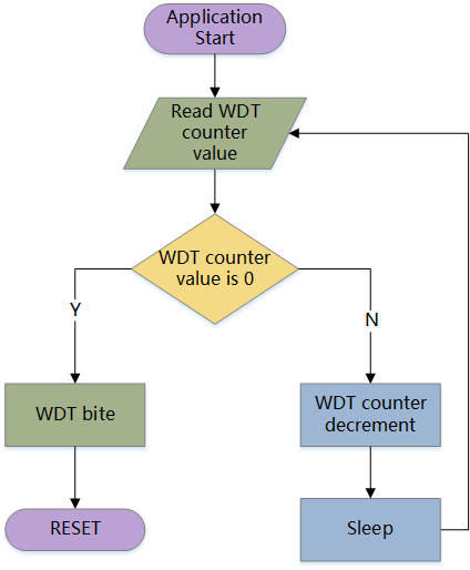

Typical software watchdog diagram:
As shown in the diagram, a software watchdog generally runs in a daemon thread. Its basic logic is shown in the diagram. The watchdog thread runs with the business and functions like a timed heartbeat. Most of the time, it is in sleep mode and performs the counter check action during the heartbeat. When the counter reaches zero, a reset is triggered.
The watchdog monitors a specific business thread, which means that this specific business thread needs to perform the feeding action, i.e., resetting the watchdog timer regularly. If this thread exits abnormally or becomes blocked, it cannot reset the watchdog timer. When the watchdog thread's counter decreases to 0, a reset is triggered.
As a daemon thread, it is important to note that if the feeding thread exits actively, the watchdog thread must also be stopped to prevent false triggering of a reset.

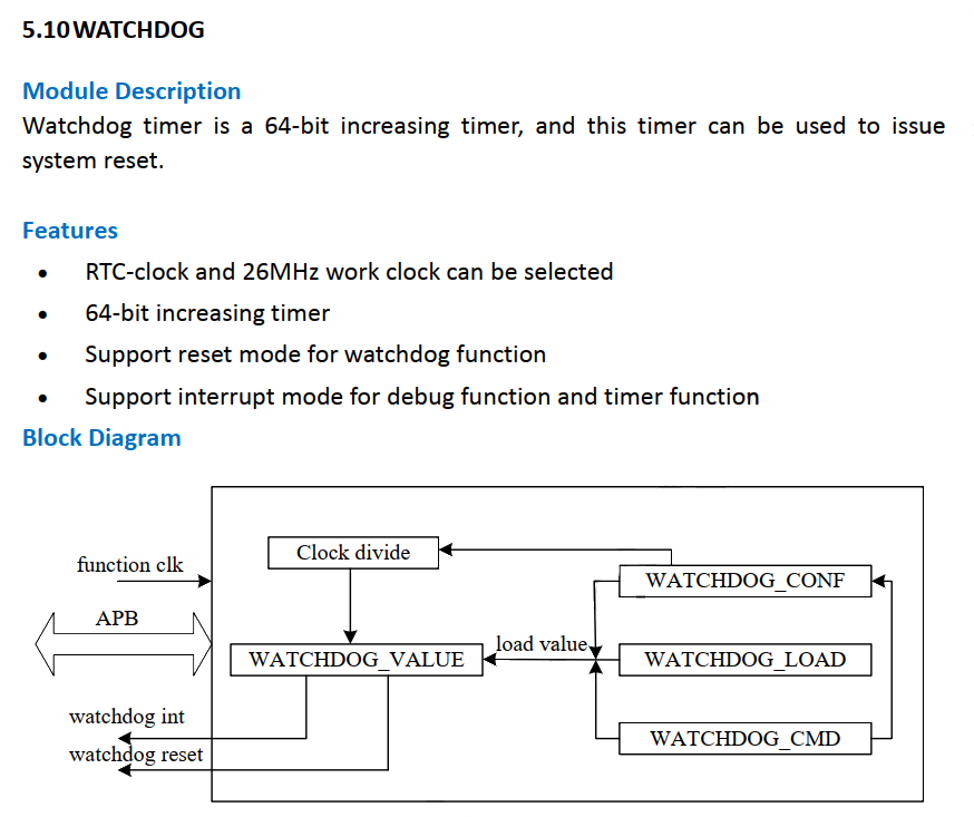

Built-in Watchdog in the Module
Cellular modules generally have a built-in hardware watchdog, which mainly monitors the running of the RTOS. When the watchdog bites, it may trigger a reset or a watchdog interrupt. The feeding mechanism is usually implemented by the task with the lowest priority, and system crashes, long-term CPU usage by threads or interrupts can all trigger the watchdog bite.
Compared to a general hardware watchdog, the built-in watchdog usually starts with the module's CPU and needs to obtain the clock source from the module (a hardware watchdog usually has its own clock source). In addition to triggering a RESET, the action of the watchdog bite can also choose to trigger a watchdog interrupt.(used for outputting debug information or entering dump mode).

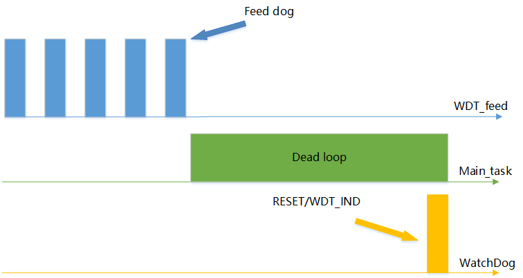

Timing Diagram of Watchdog Biting due to an Infinite Loop:
During normal operation, the low-priority feeding thread runs periodically, with most of the time being idle. When a business thread enters an infinite loop, the feeding thread cannot preempt the CPU and cannot perform the feeding action. When the watchdog times out, a reset or a watchdog interrupt is triggered.

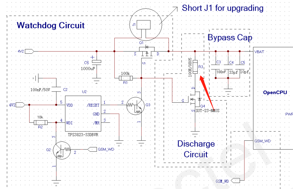

External Watchdog Solution

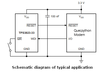

Schematic of an External Watchdog
Recommended Watchdog Chip:
TPS3823-33DBVR
Working voltage: DC 1.1V~5V
Maximum feeding time: 1.6S
Reset pin: Low level effective
Current consumption: 15uA
Feeding the External Watchdog under Special Circumstances:
- During the boot-up process: If the boot process time will be significantly longer than the threshold value that triggers the watchdog to bite, it is necessary to trigger a WDI level change in the boot or delay the effective time of the watchdog.
- During the FOTA process: Use the callback of the FOTA progress to operate the WDI interface level change. When FOTA has not adapted the callback and cannot operate IO, you need to find a way to stop the operation of the watchdog.
- You can choose a watchdog with a longer maximum feeding time, so that its feeding time is longer than the boot-up and FOTA time. This method is applicable to both situations above, but the disadvantage is that it takes a long time to reset when an exception occurs.

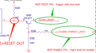

Typical Circuit Design for Whether the Watchdog Is Effective:
Use a transistor, when the gate is connected to a high level, the watchdog and the RESET pin of the module are conductive.
