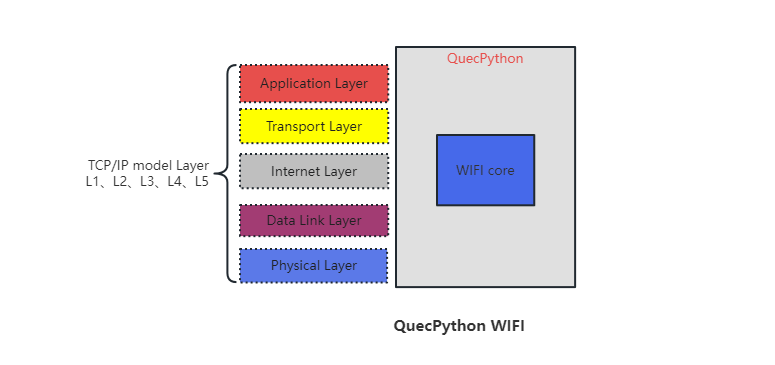

How does QuecPython support Wi-Fi?
Normal network communication is based on the TCP/IP model, and QuecPython supports the LwIP protocol stack (a lightweight open-source TCP/IP protocol stack). Therefore, you can choose the QuecPython + MAC + PHY method to mount Wi-Fi (integrating MAC and PHY chips through the UART/SDIO hardware interface, such as ESP8266/ASR5803) or by porting QuecPython to the corresponding chip platform, such as FCM360W, based on the size of the Wi-Fi platform resources.

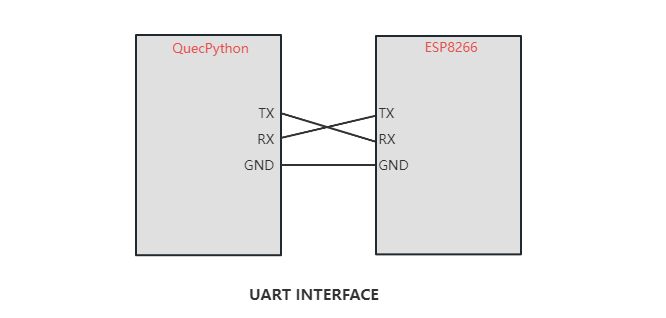

Hardware Connection
The UART interface has a relatively simple hardware connection, making it easy to integrate into devices.
The hardware connection for UART is as follows:
Pin Description
TX Serial data transmission pin
RX Serial data reception pin
GND Ground pin

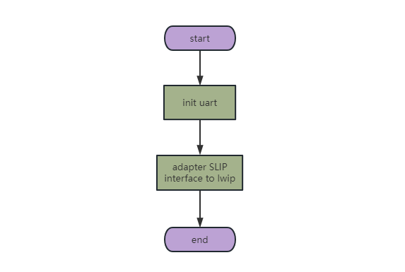

Initialization Process
The UART connection has a simple initialization process, only requiring the availability of the serial port. QuecPython does not verify external devices during the initialization of the serial port and SLIP. As long as the end device integrates the SLIP protocol, it can be used without restrictions on the device type. You can also try integrating SLIP with other devices as needed.

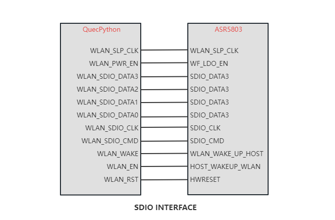

SDIO Interface
SDIO is a serial communication interface protocol used for storage cards and other external devices. It is a standard developed by the SD Card Association, which allows devices to perform bidirectional data transfer with the host through the SDIO interface. The SDIO protocol defines the physical interface, electrical characteristics, and communication protocol, supporting high-speed data transfer and the connection of multifunctional devices such as Wi-Fi NICs and cameras. The SDIO interface supports high-speed transmission with speeds of up to several tens of megabytes per second (MB/s).
Hardware Connection
The hardware connection for SDIO is as follows:
Pin Description
WLAN_SLP_CLK WLAN sleep clock
WLAN_PWR_EN WLAN power enable control
WLAN_SDIO_DATA3 WLAN SDIO data bit 3
WLAN_SDIO_DATA2 WLAN SDIO data bit 2
WLAN_SDIO_DATA1 WLAN SDIO data bit 1
WLAN_SDIO_DATA0 WLAN SDIO data bit 0
WLAN_SDIO_CLK WLAN SDIO clock
WLAN_SDIO_CMD WLAN SDIO command
WLAN_WAKE WLAN wake-up module
WLAN_EN WLAN enable control
WLAN_RST WLAN reset control

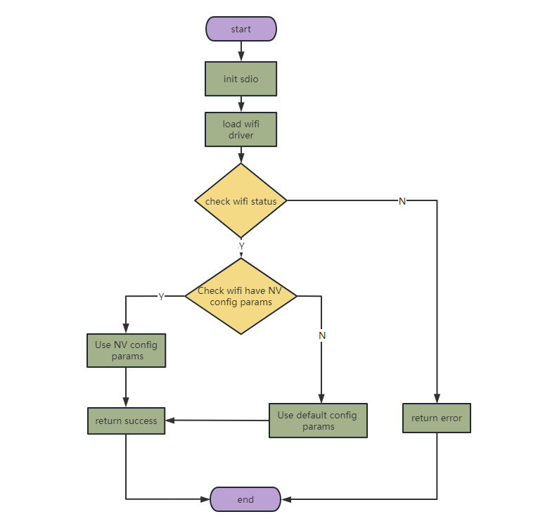

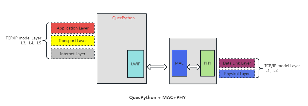

The built-in Wi-Fi of QuecPython refers to the direct porting of QuecPython onto a Wi-Fi chip, adapting the interfaces for Wi-Fi, and controlling the Wi-Fi chip directly.

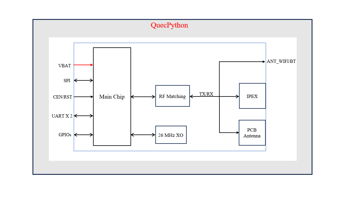

Hardware Structure
As shown in the figure below, QuecPython is ported to the Wi-Fi chip, and the hardware interface of the Wi-Fi platform is also adapted to fully utilize the Wi-Fi hardware resources.

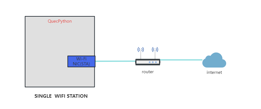

Data Flow
In QuecPython solution, configuring Wi-Fi for different working modes involves distinct workflows. In Station mode, the module is connected to external devices to access the external Internet, while the AP mode provides a 4G network to local area devices.
Note: For built-in Wi-Fi NICs, the module only has a Wi-Fi NIC and cannot perform 4G network forwarding.

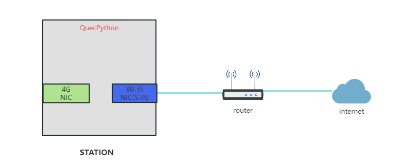

  1. STATION
Configuring the Wi-Fi NIC as Station mode allows the module to connect to an external hotspot through the Wi-Fi NIC, providing network access for the module. The module can access the Internet through the external hotspot (such as a router).

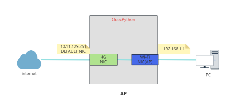

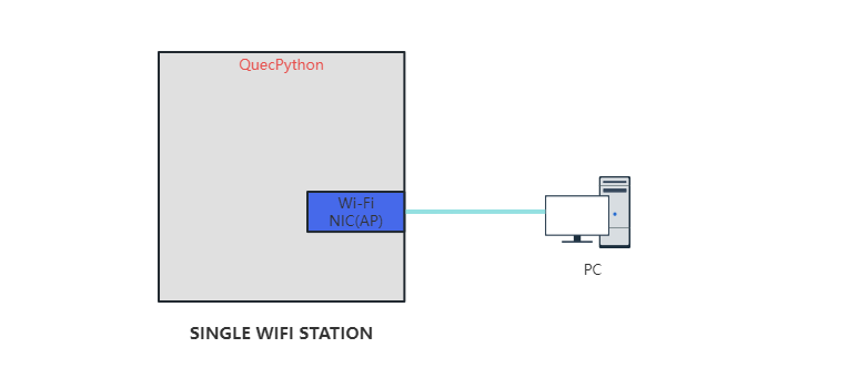

  1. AP
Configuring the Wi-Fi NIC as AP mode allows Wi-Fi to act as an access point, providing network access for other devices that connect to this access point. Through network forwarding, other modules can access the Internet through the 4G network of the module.

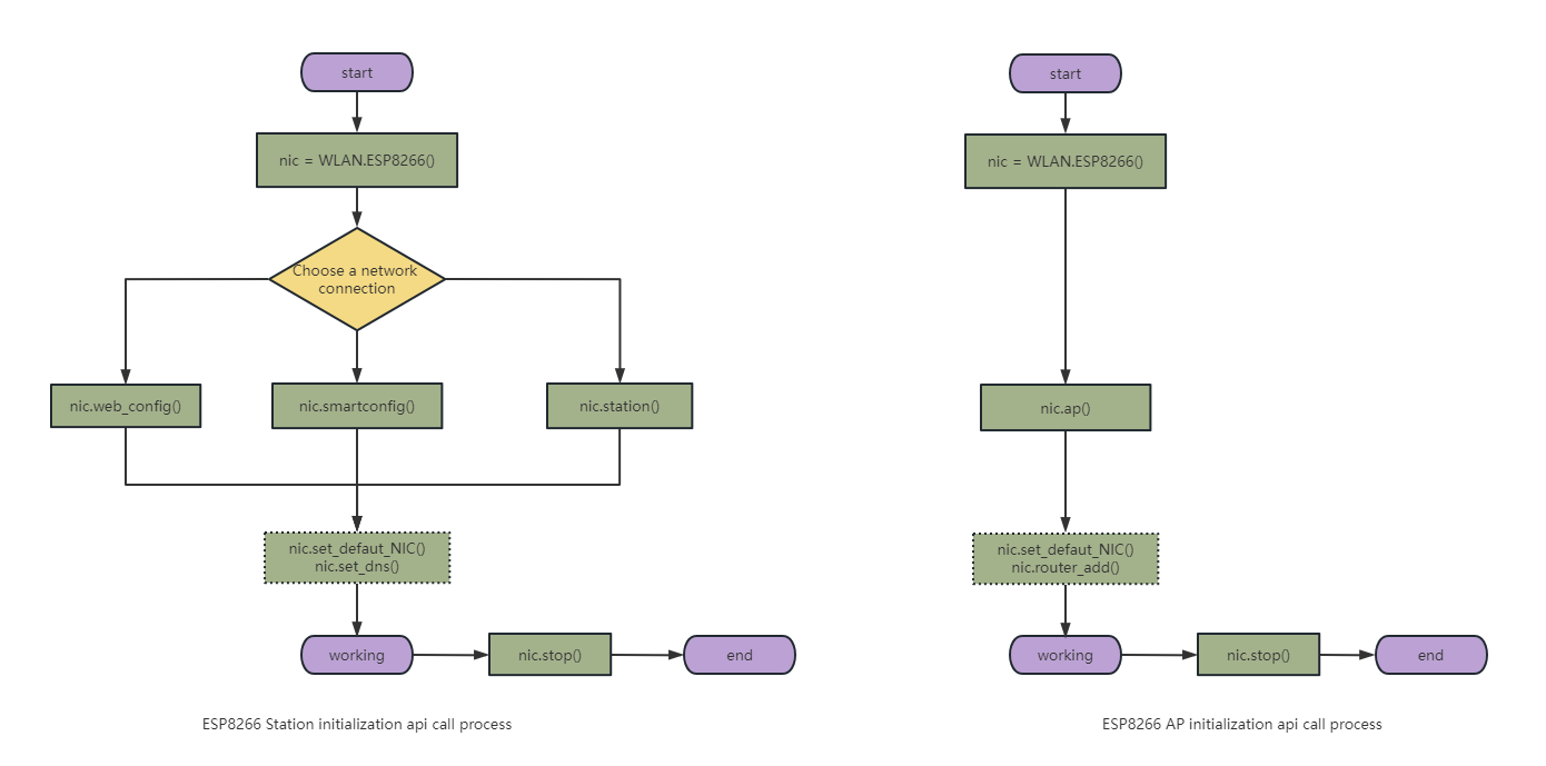

The interface call relationship is shown in the following figure:
Initialize Wi-Fi NIC Working Mode
Initializing the Wi-Fi NIC to confirm the serial port channel connected to the external Wi-Fi NIC and the working mode of the Wi-Fi NIC.
# Initialize the Wi-Fi NIC STA mode configuration
esp8266=ESP8266(UART.UART2,ESP8266.STA)
Enable AP Mode
Enable AP mode, and you can configure the username and password to establish the corresponding hotspot. Note that the configuration here needs to be consistent with the mode set in the Wi-Fi NIC initialization interface.
# Initialize the Wi-Fi NIC AP working mode configuration
esp8266=ESP8266(UART.UART2,ESP8266.AP)
# Configure the username/password for hotspot establishment
esp8266.ap('user', 'password')
STATION Mode
Connect to a hotspot and connect to the corresponding Wi-Fi access point based on the username and password of the hotspot.
# Initialize the Wi-Fi NIC STA working mode configuration
# Connect to a hotspot and connect to the corresponding Wi-Fi access point based on the username and password of the hotspot
esp8266.station('user', 'password')
WEB Configuration
Enable WEB configuration. Configure the connection to the Wi-Fi hotspot through the WEB In STATION mode.
# Configure the username and password required for enabling a WEB configuration hotspot
esp8266.web_config('user', 'password')
SMARTCONFIG Configuration
Based on the smart configuration solution provided by Espressif, it is mainly used in STATION mode to configure the connection to the Wi-Fi hotspot through SMARTCONFIG.
# Enable smartconfig. The mode can be configured as ESPTOUCH mode / AIRKISS mode / ESPTOUCH mode and AIRKISS mode / ESPTOUCH-V2 mode
esp8266.smartconfig(mode)

Provides a method for the Wi-Fi NIC data to be forwarded through the 4G NIC. Two steps are required: configuring the default NIC to confirm which NIC is used for forwarding, and configuring the routing forwarding settings by specifying the forwarding IP rule. Only data within the hotspot's network segment will be forwarded. Generally, when the Wi-Fi NIC is working in AP mode, the 4G network provides network services to Wi-Fi terminals.
  1. When the module performs socket communication, the module will perform routing lookup and match the corresponding NIC for sending. If no NIC is bound for sending, the network will be sent through the default NIC. If the default NIC does not exist, an error will be reported and exited.
  2. In the case of multiple NICs, when the network forwarding performs routing lookup to determine which NIC to send from, for non-local data, if there is no default NIC, it will be directly discarded. If a default NIC is configured, it will be forwarded through the default NIC. For ESP8266, it is necessary to determine the forwarding rules.
# Configure the default NIC to perform network forwarding through the default NIC
esp8266.set_default_NIC(ip)
# Add a routing rule to forward only the IP in the specified network segment
esp8266.router_add(ip, mask)

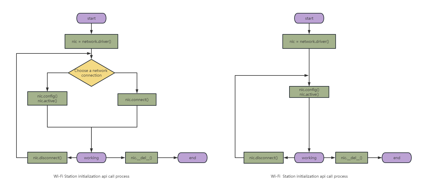

STATION Mode
Method 1:
# Initialize the Wi-Fi NIC in STATION mode
nic = network.WLAN(network.STA_IF)
# The username/password for connecting to the hotspot
nic.connect('user', 'password')
Method 2:
# Configure the username/password for connecting to the hotspot
nic.config('ssid'='user', 'key'='password')
# Activate the Wi-Fi NIC
nic.active(True)

Application Examples
The following examples demonstrate the use of Wi-Fi functionality on the QuecPython EC600NCN_LE EVB (referred to as the "EVB") connected to ESP8266 via UART2:
6.4.3.1 Station Mode
6.4.3.2 AP Mode
