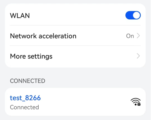

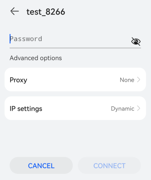

Connect to the Wi-Fi Hotspot on a Mobile Phone
Open the WLAN interface on your mobile phone, find the Wi-Fi named test_8266, enter the password, and connect to it.
Check the Network Connection
You can see that the mobile phone has successfully connected to the Wi-Fi hotspot. At this point, close all other network connections on the phone and only keep this Wi-Fi connection. You can open a browser and access websites normally.
Note: The ESP8266 is connected to the module via a serial port, and the communication speed is relatively low. It is recommended to use the phone for browsing news, and smooth video communication is not allowed.
