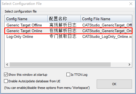

Step 1: Select Configuration File
Open CATStudio, and the following window will pop up by default. Select "Generic Target Online" and click "OK".

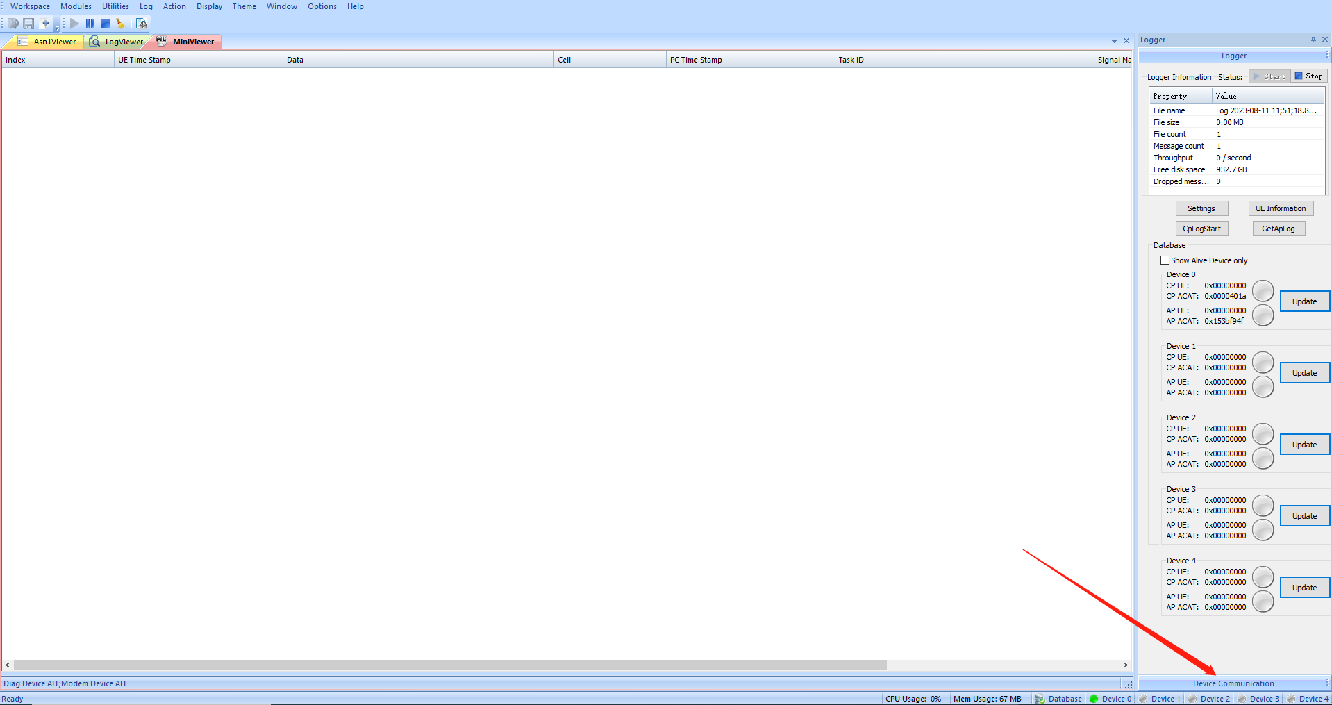

After finishing "Step 1", you will enter the following interface. Click "Device Communication" in the lower right corner to open the corresponding configuration window. By default, select "Device 0" and click "Settings".

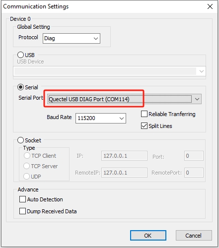

In the following interface, select "Serial" and click the drop-down button of the "Serial Port" selection box. Choose "Quectel USB DIAG Port", and leave the baud rate as default. Click "OK", and you can see the window start outputting logs.
If the main window of CATStudio does not output any logs after this step, you may need to restart your computer and reopen CATStudio.

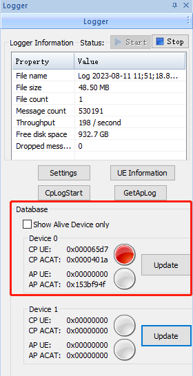

Step 3: Match DB Files

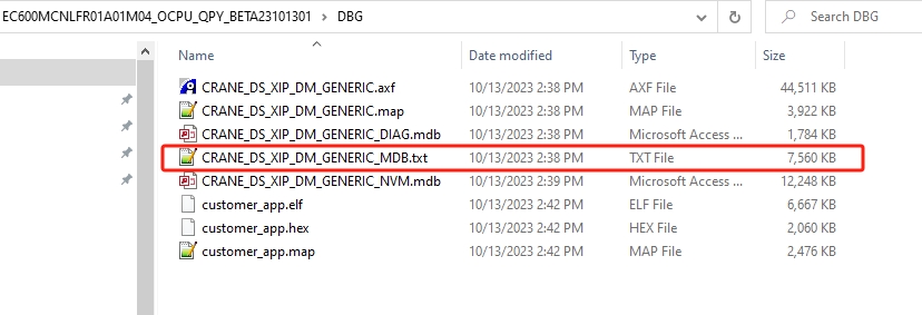

When no DB file is matched, many logs on the CATStudio interface will remain undecoded. To better view logs, you can match the DB file corresponding to the module firmware. DB files are usually contained in the corresponding firmware package, as shown below.
If the DBG directory is not available in your firmware package, you can provide the firmware version number to Quectel Technical Support to obtain the corresponding DB file.
If there is no matched DB file, you will see a red indicator light on the tool interface, as shown in the following figure.

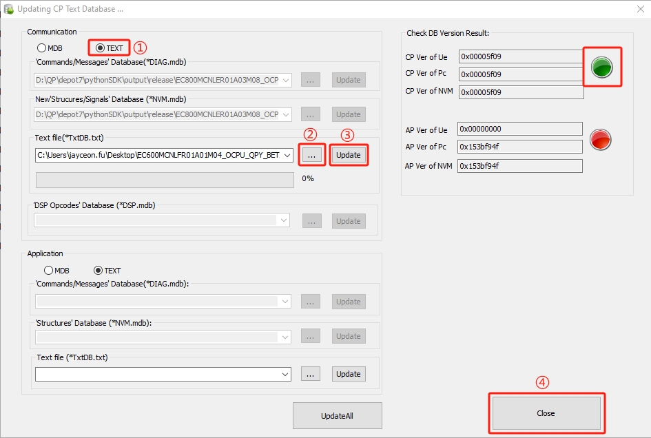

Click "Update" next to the red indicator light to enter the following interface, and then follow the steps below.

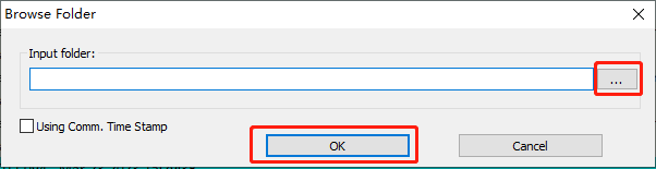

Select "TEXT" at position ①.
Click "..." at position ②, and in the file selection window, navigate to the path where the module firmware package is located, and then go to the DBG directory in the firmware package to select the corresponding DB file.
Click "Update" at position ③. If the selected DB file matches the firmware in the module, you will see the indicator light on the right side of the CP section turn green.
After successfully matching the DB file, click "Close" at position ④ to return to the log output interface. At this point, the indicator light for Device 0 should also turn green.
It is not necessary for you to match the DB file. If you only need to capture logs and provide them to Quectel Technical Support for analysis, "Step 3" can be skipped. Quectel Technical Support will match the DB file itself.

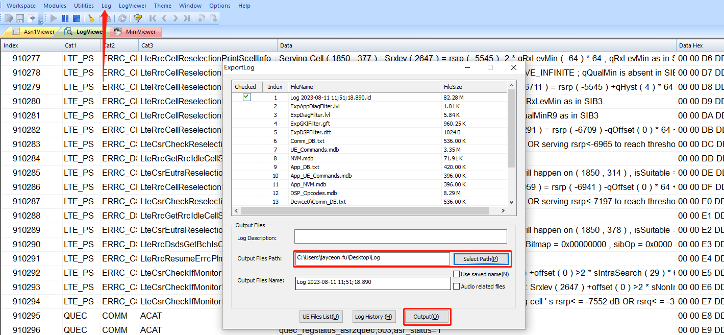

Step 4: Export Log Files
After capturing logs, you need to export the log file and provide it to Quectel Technical Support or software engineers for analysis. Follow the steps below to export the log file.
Click "Log" in the menu bar, and then click "Export Log-File" in the drop-down list to open the "ExportLog" window.
In the "ExportLog" window, click "Select Path(P)" to choose the path for saving logs.
Click "Output" and wait for the log file to be exported.
The exported log file contains both AP and CP logs. If you need any assistance in analyzing related issues, please provide the exported log file to Quectel Technical Support or software engineers.

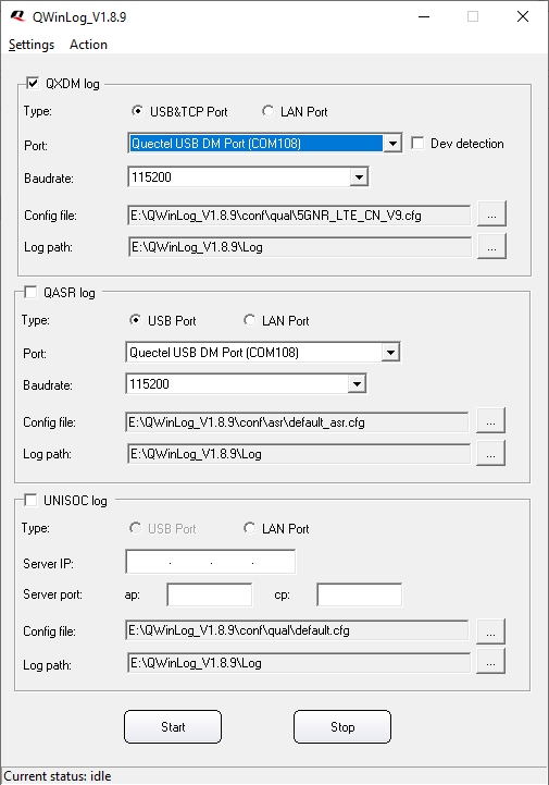

Since you are using QWinLog to capture logs of the ASR platform, you only need to configure parameters related to the ASR platform, as shown in the figure below.
Follow the steps below.

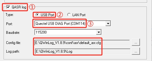

Tick "QASR log" at position ①.
Select "USB Port" at position ②.
Click the drop-down button of the "Port" selection box at position ③ and choose "Quectel USB DIAG Port," which is the port for capturing AP and CP logs on the ASR platform.
"Config file" is the configuration file used by QWinLog for log capture. You can use the default configuration file provided by the tool or contact Quectel Technical Support for the configuration file.
"Log path" is the path where the captured logs will be saved. You can keep the default setting or modify it as needed.

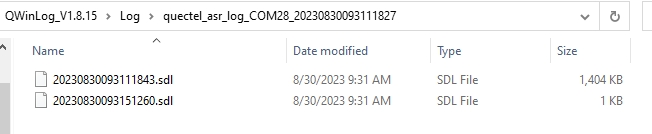

After capturing the required logs, click "Stop" to stop capturing, and then you can find the saved log files in the directory specified in the "Log path" option, as shown in the figure below.
You only need to compress these log files into a zip and send it to Quectel Technical Support or software engineers.

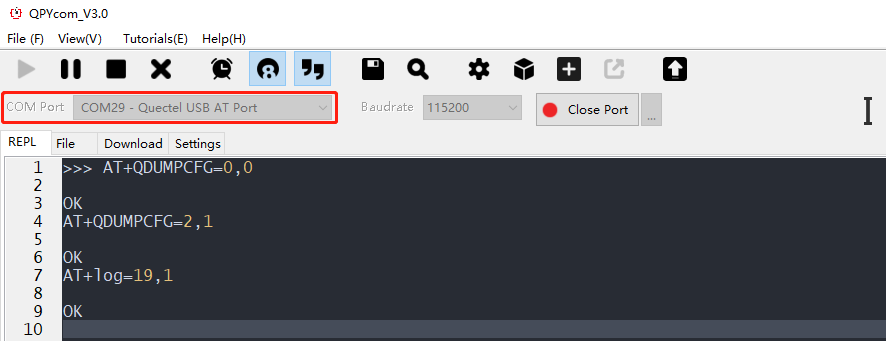

Step 1: Configure Dump Mode
By default, ASR platform modules will reboot when a dump occurs, making it impossible to export dump files. To export dump files, you need to configure the module's dump mode by sending the following AT commands when the module runs normally to ensure the module will not reboot automatically when a dump occurs but stays in dump status.
AT+QDUMPCFG=0,0
AT+QDUMPCFG=2,1
AT+log=19,1
While the module is running normally, you need to open QPYcom, select "Quectel USB AT Port" for "COM Port," and click "Open port". Then, send the three AT commands above one by one, as shown in the figure below.

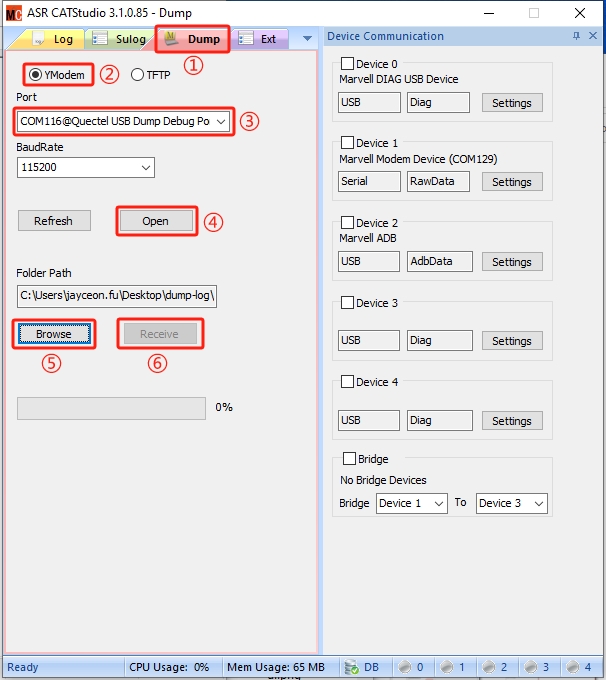

Step 4: Configure Parameters and Export Dump Files
After following "Step 3", a window will pop up as shown below. Click "Dump" at position ① to open the dump export page, and configure the parameters as indicated by the numbers in the figure.
- Select "YModem" at position ②.
- Click the drop-down button at position ③ and select the dump port you identified in "Step 2".
- Click "Open" at position ④ to open the corresponding port.
- Click "Browse" at position ⑤ to select the path where you want to save the dump file.

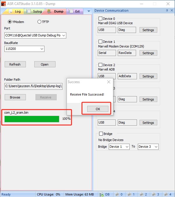

- Click "Receive" at position ⑥ to start exporting the dump file. Until the export is completed, a window will pop up, and you can click "OK."
After executing these steps, the dump files have been successfully exported. You can compress the exported dump files into a single zip and provide it to Quectel Technical Support or software engineers for analysis.

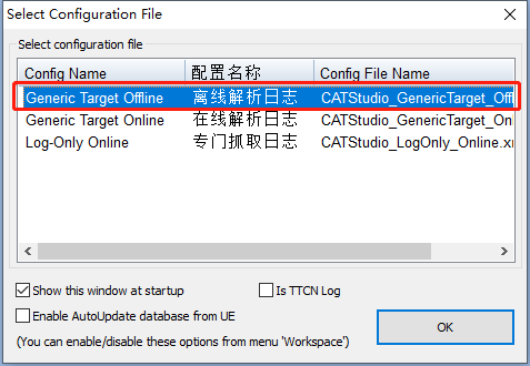

Step 2: Select Configuration File
Open CATStudio, and the following window will pop up by default. Select "Generic Target Offline" and click "OK".
Please note that in this case, you should select "Generic Target Offline". In the Capture AP and CP Logs section, you should select "Generic Target Offline".

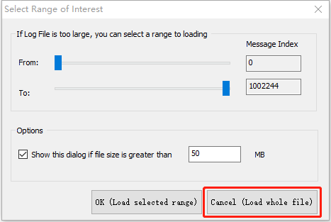

After entering the CATStudio main interface, click "Open ZIP/ICL..." in the upper right corner. In the pop-up window, select the log file zip you exported earlier and wait for the zip to be decompressed and loaded.
If, during the file loading process, you see the window below, it means that the selected log file zip is relatively large and exceeds the default file size limit. In this case, click "Cancel (Load whole file)," which means loading the whole file.

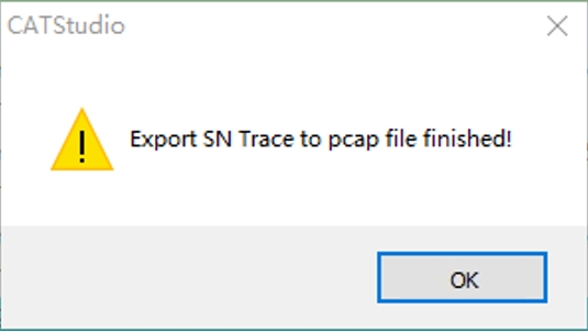

Click "Action" in the menu bar, then select "Export SN Trace to pcap file" from the drop-down list. A window will pop up as shown below.
In this window, select the location where you want to save the export file, then click "OK". Until the export is completed, a window will pop up, and you can click "OK."

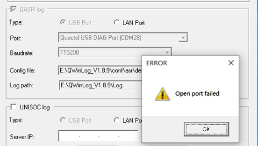

Q1: Why did I fail to capture logs using QWinLog with a window like the one shown below popped up?
There may be two reasons:
Reason 1: Another program occupies "Quectel USB DIAG Port". You can check whether the port is occupied. If the port is occupied, close the program occupying the port and try to capture logs again.
Reason 2: The USB driver has loaded abnormally. You can disconnect the module from the computer, and then reconnect the module with the computer via a USB cable, or power cycle the module. If the issue still exists, restart your computer.
