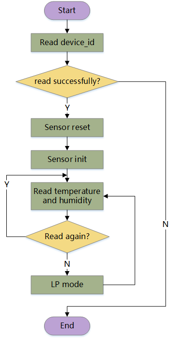

Workflow
The following diagram shows a typical workflow of a temperature and humidity sensor.
