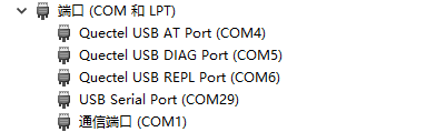

After completing the hardware connection work, long press the button labeled 'PWK' on the development board until the network light flashes or a COM port containing the words' Quectel USB 'appears in the port list of the computer device manager, indicating successful boot.

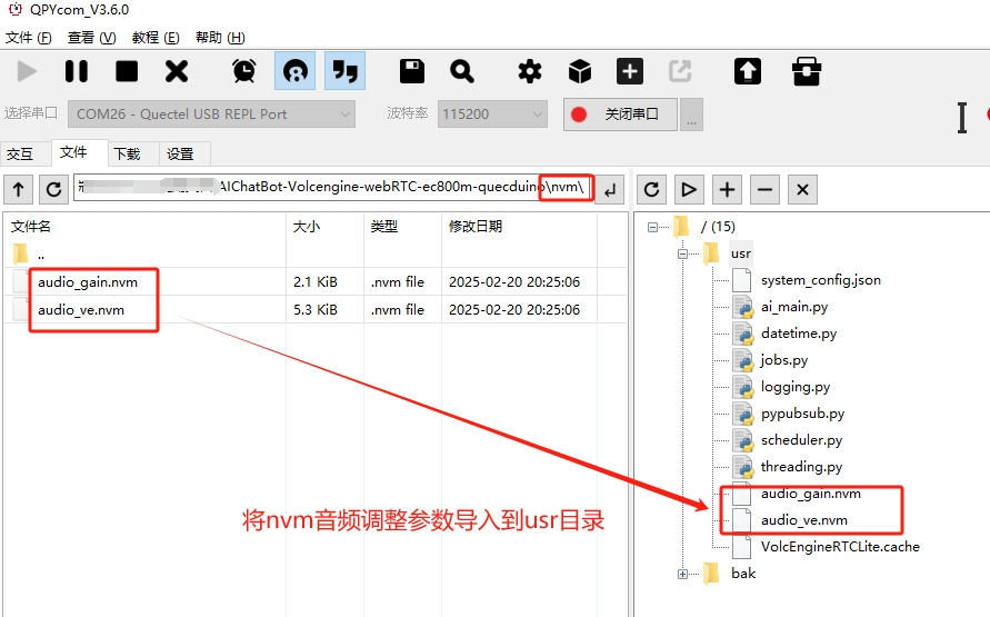

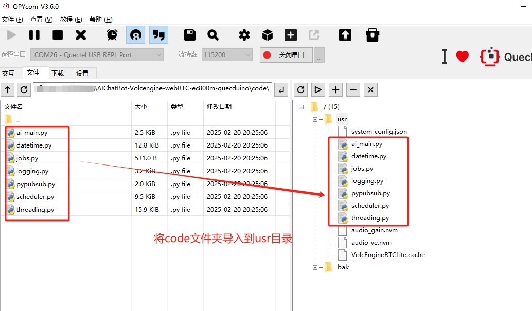

  1. Refer to this chapter Import all files from the 'code' folder in the source code directory into the module file system, as shown in the following figure:
