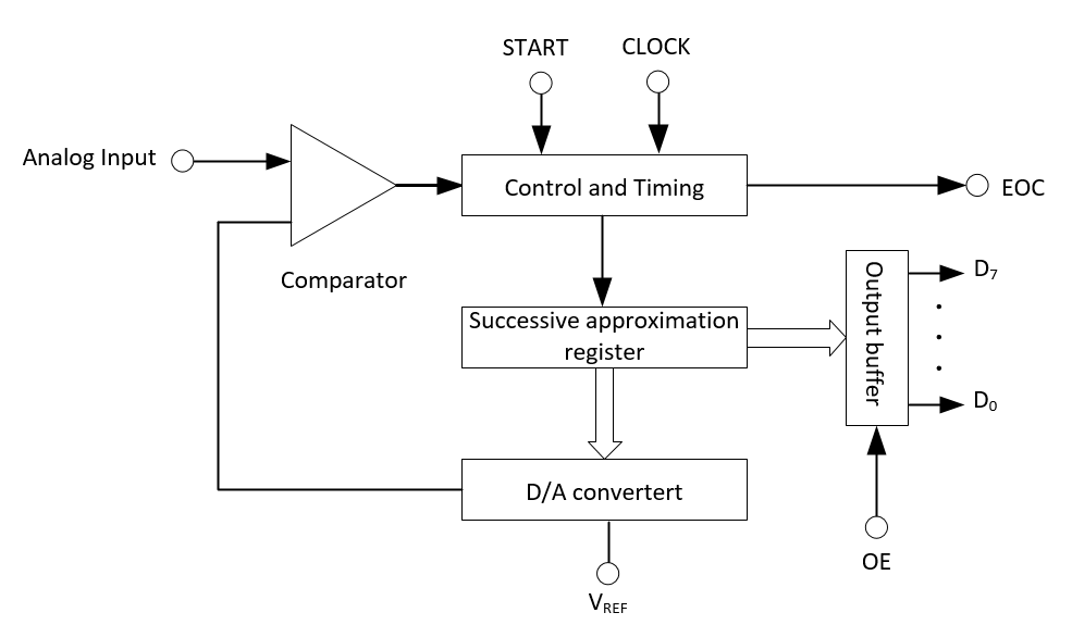

ADC, short for Analog-to-Digital Converter, plays the role of transforming analog signals that computers cannot directly recognize in the physical world into binary digital signals that can be recognized by the CPU.

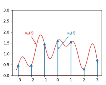

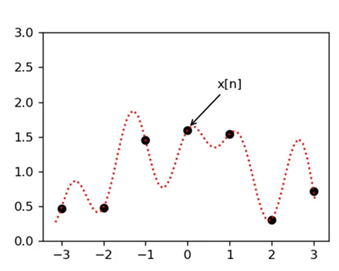

The basic working principle of ADC involves sampling and quantization. First, ADC samples the analog signal, which means it measures the value of the analog signal at regular time intervals. Then, the sampled analog signal is quantized, which means it is discretized into a series of discrete numerical values. These numerical values are typically represented in binary.

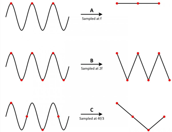

The sampling rate of an ADC is the number of times it samples per second. A higher sampling rate results in a more faithful representation of the original analog signal. According to the Nyquist Sampling Theorem, the sampling rate must be at least twice the maximum frequency of the signal being measured to avoid distortion in the sampled waveform. In practical applications, the sampling frequency is often much higher, sometimes even up to 10 times or more the maximum frequency of the signal being sampled.

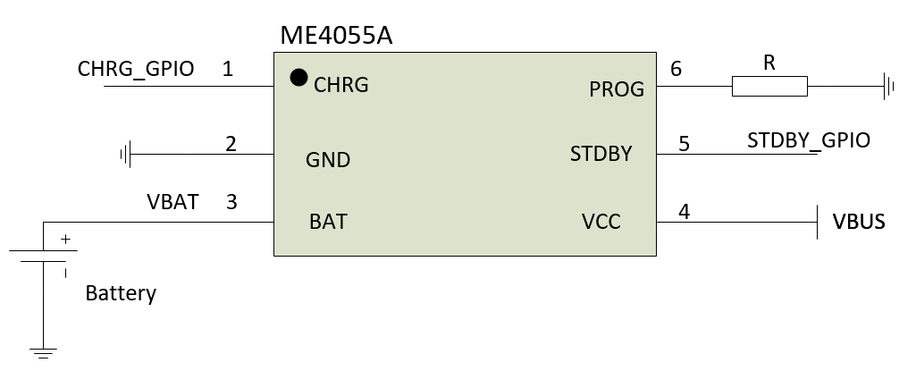

Battery Voltage Acquisition and Charging Detection
Materials Needed: Battery, EC600U Module, ME4055A.
Principle:
ME4055A is a dedicated battery charging chip designed to provide constant current or constant voltage linear charging for a single battery. Its packaging is as shown below.
The CHRG pin is the charging status indicator pin. When the battery is charging, the CHRG pin is pulled low by the internal circuit. Otherwise, the CHRG pin is in a high-impedance state.
The BAT pin is the battery connection pin, where the positive terminal of the battery is connected. The voltage output at the BAT pin is constant at 4.2V.
The VCC pin is the power supply input pin, providing power to ME4055A.
The STDBY pin is the charging completion indicator pin. When charging is complete, STDBY is pulled low by the internal circuit. Otherwise, STDBY is in a high-impedance state. The module determines the charging status by monitoring the levels of the CHRG and STDBY pins.
The PROG pin is used for charging current setting and detection. When the PROG pin is connected to ground through a resistor RPROG, the charging current IBAT=(VPROG/RPROG)*1100, where VPROG=0.1V in pre-charge mode, and VPROG=1V in constant current charging mode.
The principle of battery voltage detection involves using the voltage divider method with resistors. In hardware, two resistors are used to proportionally divide the battery voltage, and the divided voltage is sent to the module's ADC pin for detection. The software calculates the battery voltage based on the voltage value read by the module's ADC, using conversion calculations.
Hardware Connection: As shown in the diagram below, ME4055A's CHRG and STDBY are connected to the module's GPIO pins, BAT is connected to the positive terminal of the battery, and VCC is connected to the power supply. By dividing the battery voltage and connecting it to the module's ADC pin, the battery voltage is measured.

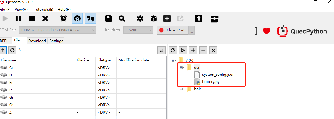

After downloading battery.py to the module's usr partition, you can import the Battery class using the following:

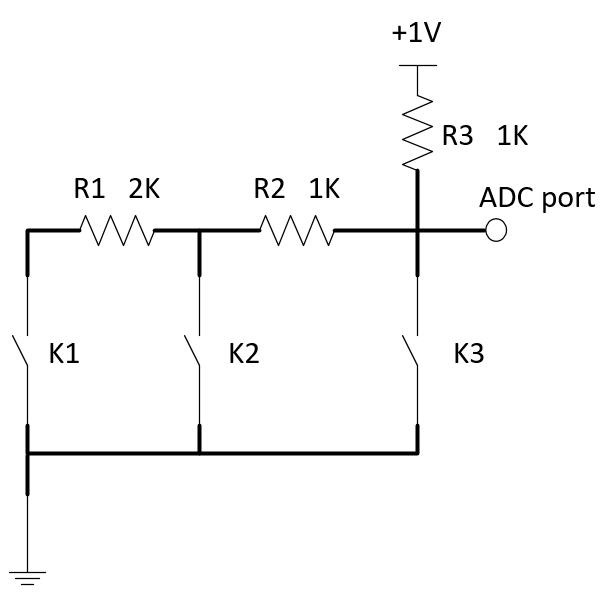

ADC-Based Button Detection
When IO resources are limited, you can use ADC to implement multi-button recognition with a single ADC pin.
Materials Needed: EC600U module, relevant hardware circuit.
Principle:
Different button presses are determined by the varying voltage levels at the ADC pin.
- When the upper end of R3 is connected to a voltage of 1V and no button is pressed, the voltage at the test point is 1V.
- When K1 is pressed, the voltage at the test point drops to 0.75V.
- When K2 is pressed, the voltage at the test point drops to 0.5V.
- When K3 is pressed, the voltage at the test point drops to 0V.
The software can periodically read the voltage at the ADC pin and use this information to determine which button is pressed. In practical applications, you can adjust the pull-up voltage, resistor values, and the number of switches as needed.
The hardware circuit is as shown in the diagram below, consisting of three buttons (K1, K2, K3) and three resistors. The ADC port in the diagram is connected to the module's ADC0 pin.
To improve the accuracy of ADC voltage measurements, it is recommended to ground the ADC interface during wiring.

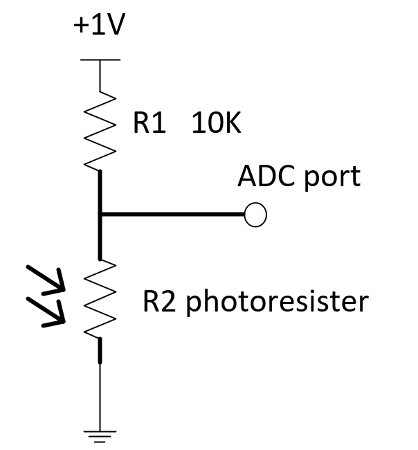

By reading the ADC voltage values, you can calculate the resistance value of the LDR. Based on the relationship between the light intensity and the resistance of the LDR, you can determine the intensity of the light.
The hardware circuit is as shown in the diagram below: R2 is the LDR, R1 is 10K (you can choose the value of R1 based on the specific parameters of the LDR), and the ADC port is the test point connected to the module's ADC pin.
In this example, you can observe the impact of different light levels on the LDR by printing the ADC-measured voltage values and the resistance values of the LDR.
