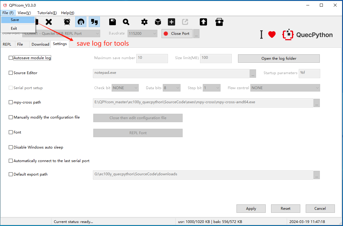

"File" Tab in Toolbar

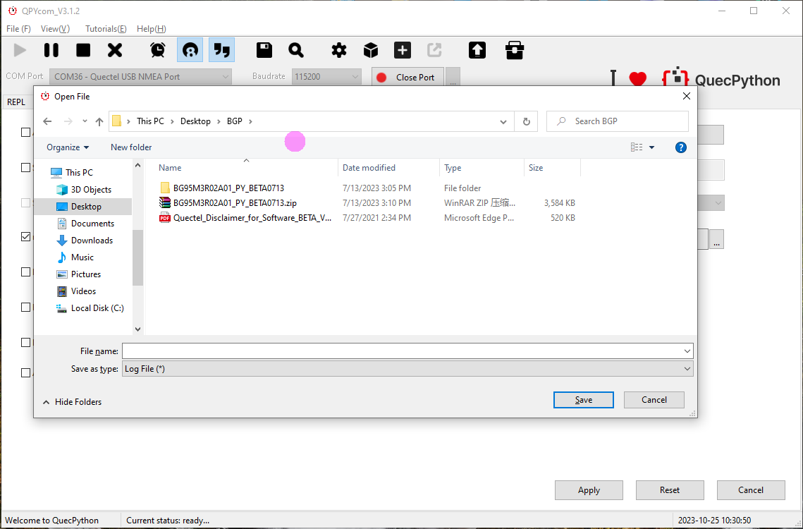

Save
- Click "Save" to select the path for saving logs.
Exit
- Click "Exit" to exit the tool application.

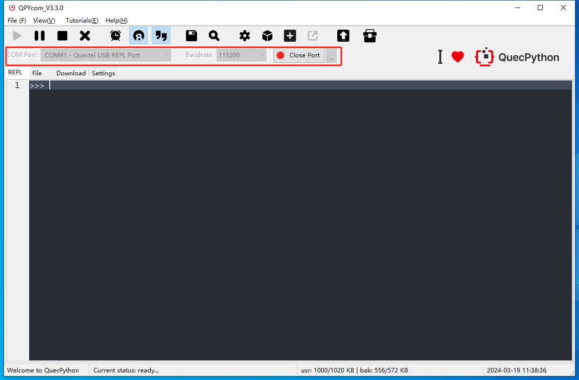

Interactive Command Line
By clicking "View > Interactive command line", you can enter the "REPL" page, where you can manually send commands to interact with the module through the interactive window. The "REPL" page is shown below.

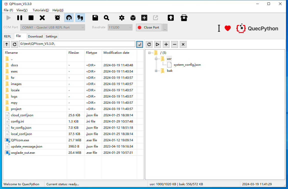

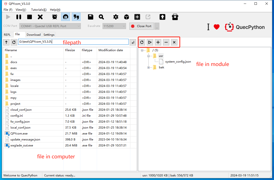

File Browsing
By clicking "View > File browsing", you can enter the "File" page, where you can upload, view, add, and delete the Python files in both your local disks and the module.
In addition to uploading files by clicking "+" on the page, you can also upload a local file to the module by drag-and-drop. Select the local file on the left and drag it to the folder on the right to upload the file. The download progress will be displayed in the status bar. Note that files can only be dragged and dropped into folders. If you drop a file to a wrong location, an error will be prompted. You can call uos.mkdir() to create a new folder in the module and then drag and drop the local file to the new folder in the module. Note that files can only be dragged and dropped into folders indicated with "+" and "-". For folders with no symbols, refresh the page.

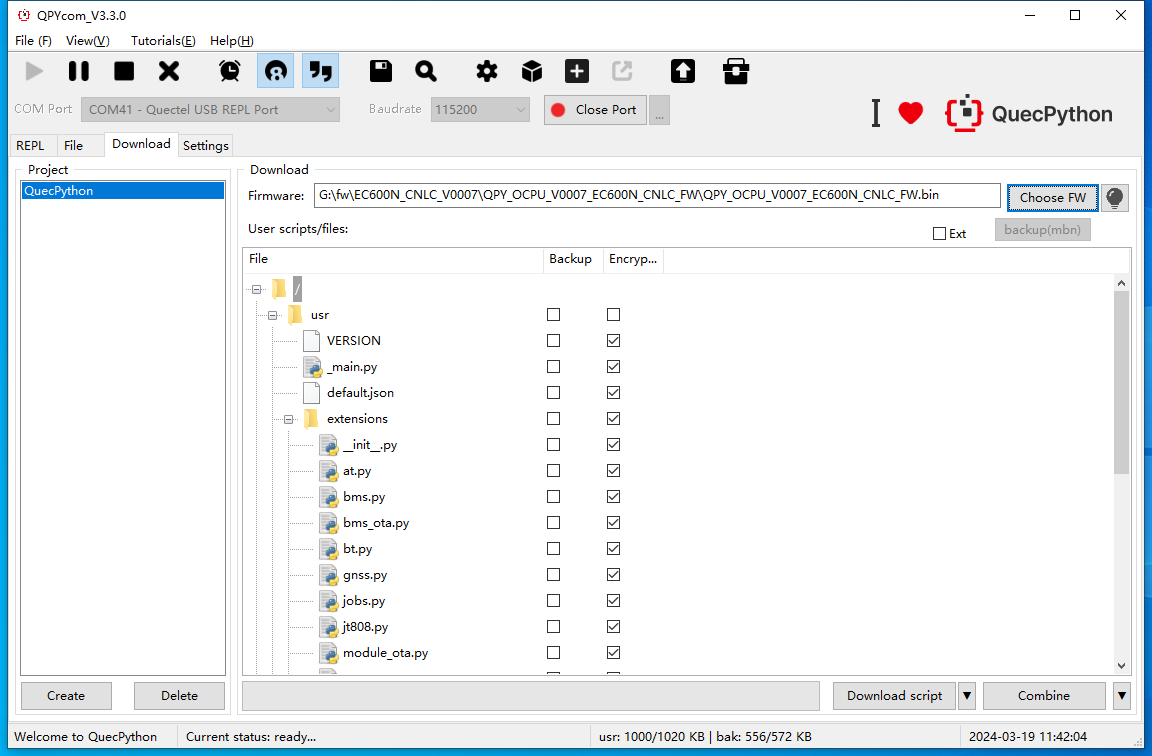

FW/Script Download
By clicking "View > FW/script download", you can upload Python script files in batches and download firmware to modules. The operation steps are as follows:
- Create a project on the left navigation bar.
- Click "Choose FW" to choose the firmware from the local disk. The firmware is located in the firmware directory of the SDK. Note that the firmware format can only be .zip.
- Select the script to download as indicated in the figure below. You can also select a script and click "-" in the lower left corner to delete it.
- Switch between "Download script" and "Download FW" by clicking the inverted triangle icon in the lower right corner.
- After selecting the firmware and the required script files, click "Combine" to generate the file for mass production. During the combination process, all controls except the progress bar are disabled. Please make sure that the USB AT Port is not occupied during the download progress.

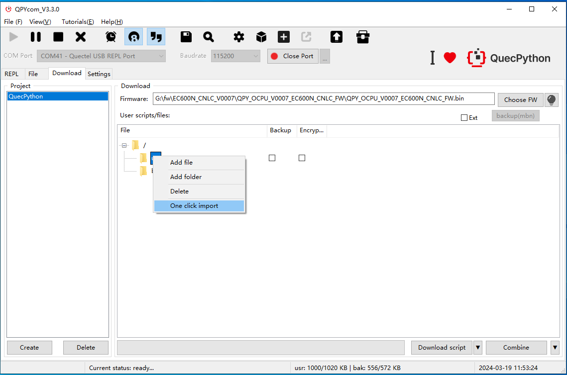

- Note that on the "Download" page in the versions 1.6 and above, scripts have been downloaded as files in a directory format to the module. The original buttons have been removed. You can right-click a file or folder for addition, deletion and modification. You can also drag and drop a file from the local disk to the QPYcom. Click "Download script" to download the script to the module.
As shown in the figure:

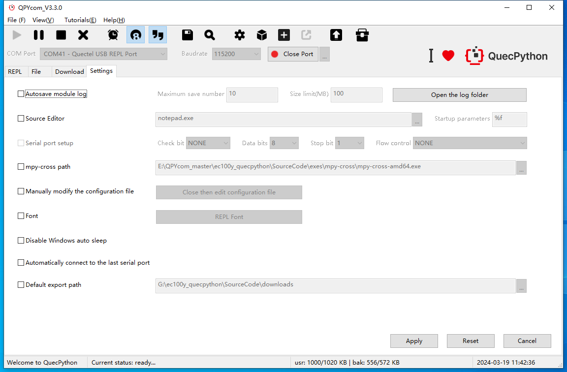

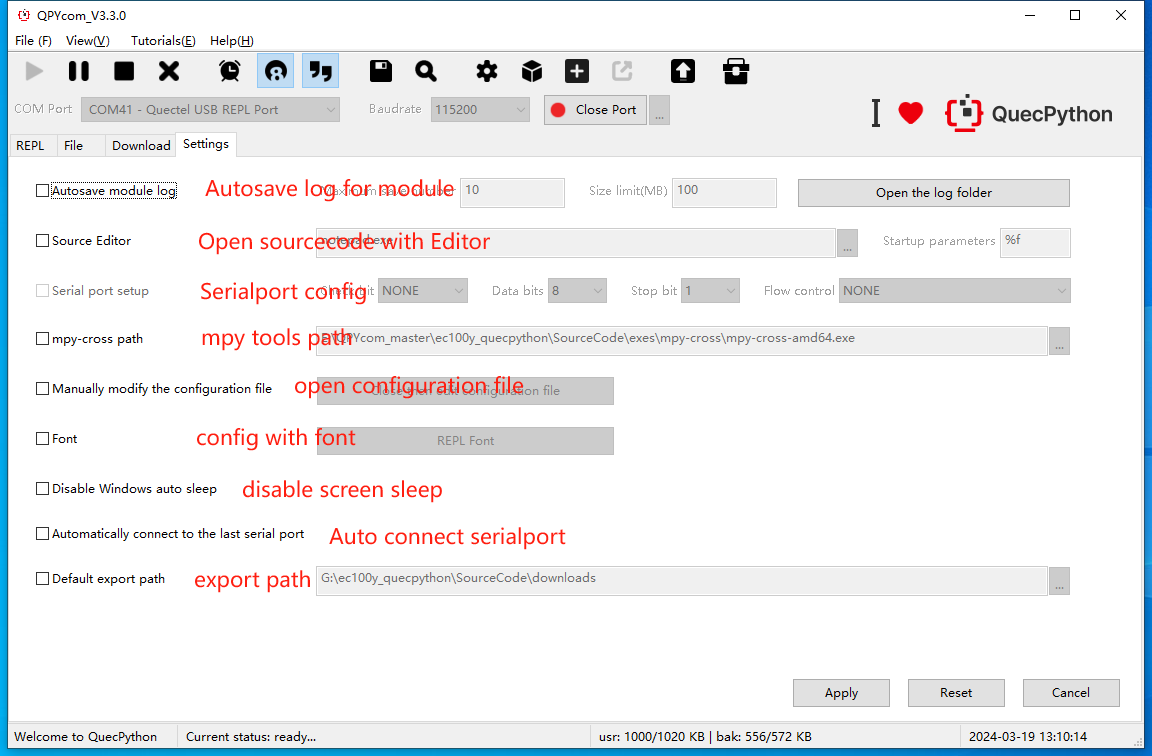

Software setting
By clicking "View > Software setting", you can enter the "Settings" page, where you can set whether to automatically save the module log, the size limit of a single log for saving, the maximum number of logs that can be saved, serial port parameters (including the parity bit, data bit, stop bit and flow control), mpy-cross path, and the font for the "REPL" page. These settings can be saved persistently.

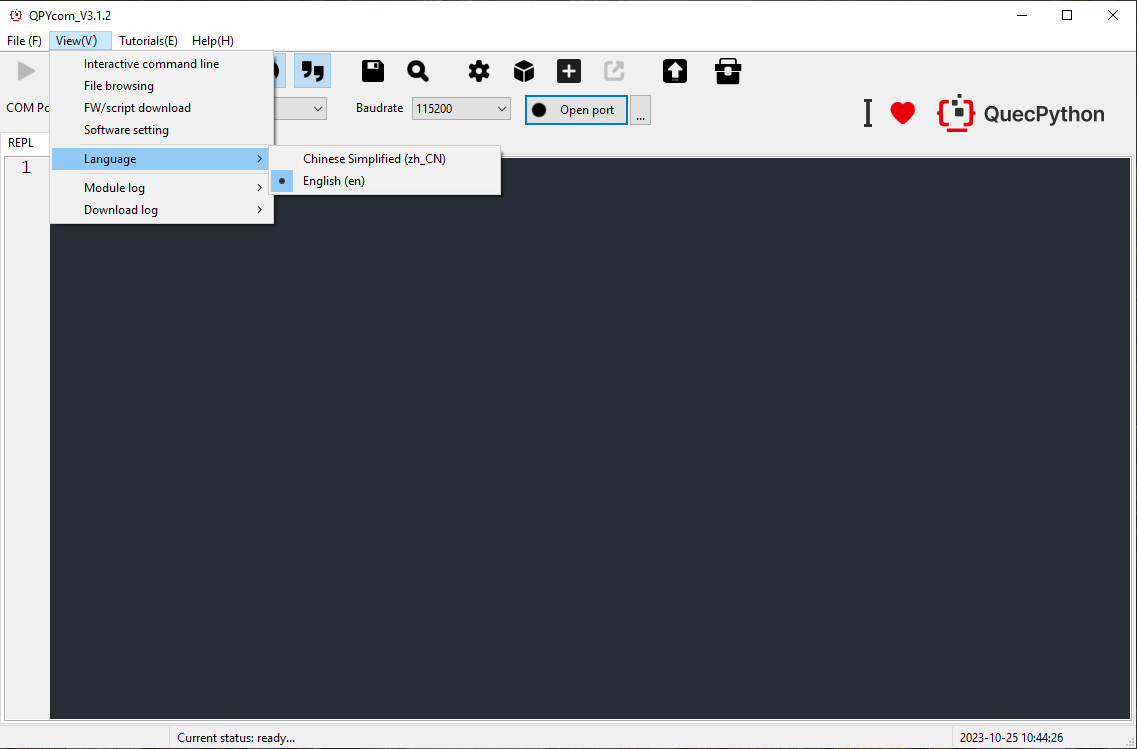

Language
- By clicking "View > Language", you can switch the tool's language. Currently, only simplified Chinese and English are supported.

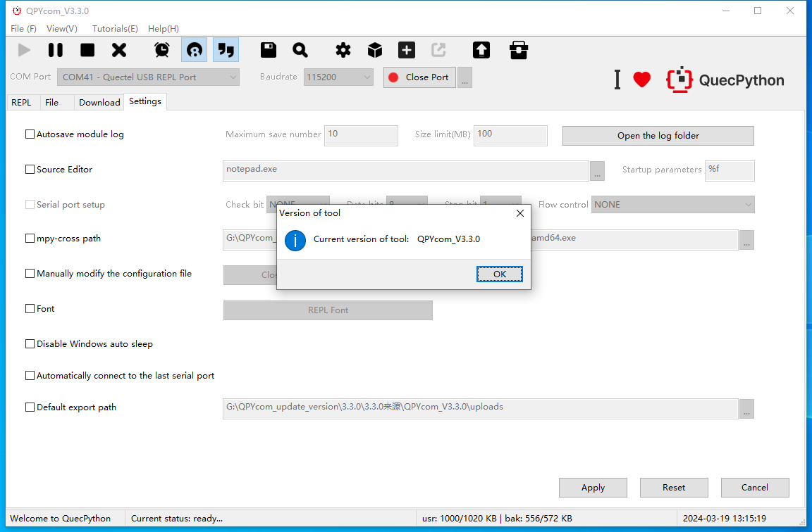

Version
- By clicking "Help > Version", the current version number of QPYcom will be displayed.
