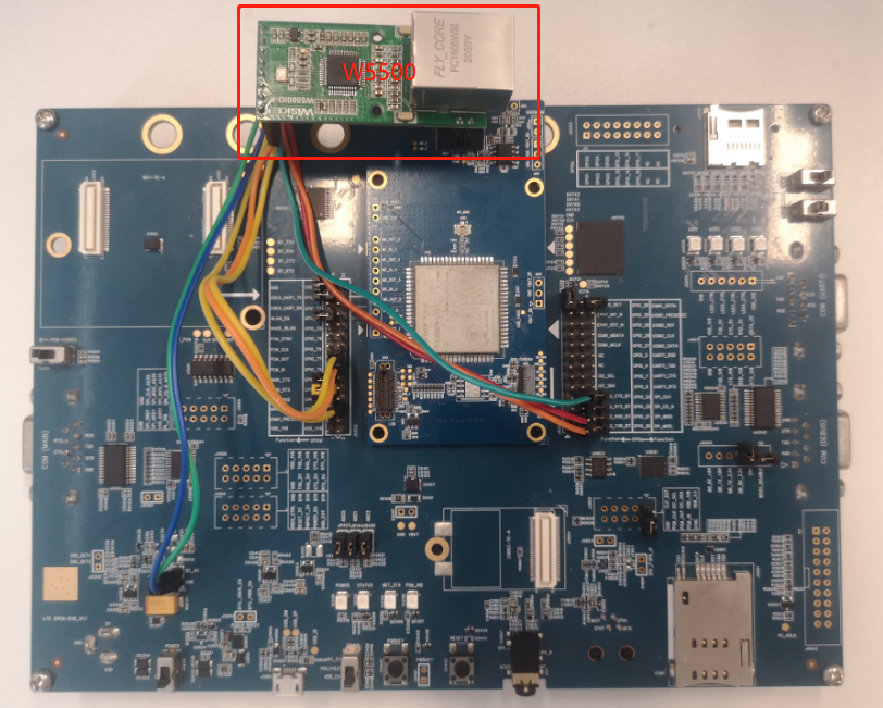

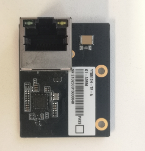

Hardware Preparation
To use the external Ethernet feature, you need to prepare an external Ethernet NIC, cable, router, and DuPont wires.

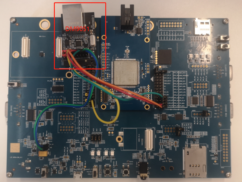

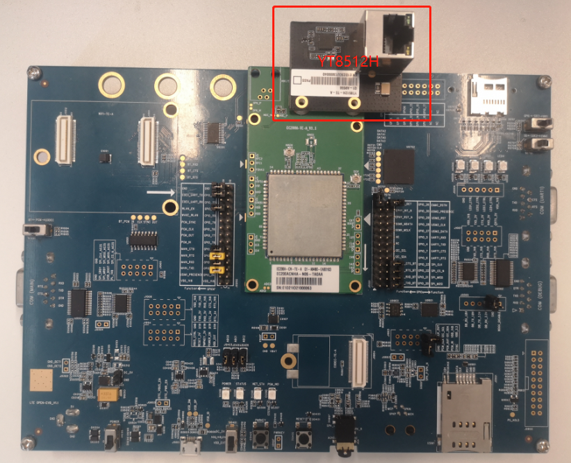

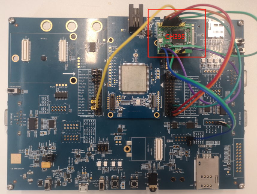

Connect the module to the Ethernet NIC with DuPont wires according to your actual needs (Refer to ethernet - Ethernet Driver for specific interface configuration parameters), and then connect the Ethernet NIC to the router with a cable.

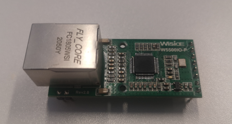

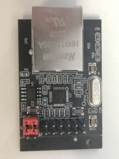

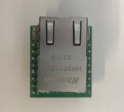

| Ethernet Chip Model | Ethernet Module Picture | Hardware Connection Picture | Chip Manual | Code Example |
| W5500 | W5500 Module Picture | W5500 Hardware Connection Picture | W5500 Chip Manual | Download Code Example |
| DM9051 | DM9051 Module Picture | DM9051 Hardware Connection Picture | DM9051 Chip Manual | Download Code Example |
| CH395 | CH395 Module Picture | CH395 Hardware Connection Picture | CH395 Chip Manual | Download Code Example |
| YT8512 | YT8512 Module Picture | YT8512 Hardware Connection Picture | YT8512 Chip Manual | Download Code Example |
- The hardware connection pictures are just for reference and you need to configure the connection according to your actual environment.
- SZ18201/J1101 has the same connection and usage method as YT8512, both using the RMII interface, so they are not listed here.
