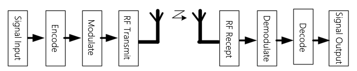

Imagine a scenario where two individuals are located on adjacent mountaintops and need to communicate with each other in the absence of modern electronic devices.
Modern communication systems also encompass similar elements but in a more complex and efficient manner. Users who have used dial-up access may be familiar with the term "modem". Telephone lines and networks are designed to transmit analog audio signals ranging from 300 Hz to 3400 Hz and are not suitable for direct transmission of network data. To enable bidirectional communication between computers over telephone lines, two basic requirements must be met:
- Through the operating system and network interface, convert user raw data into standardized data formats that can be recognized and transmitted between network devices. This process, which involves standardizing data formats to improve information transmission efficiency and system effectiveness, is typically referred to as "coding". The corresponding process at the receiving end is known as "decoding".
- Through the modem, convert digital signals into analog signals suitable for transmission over telephone lines, and vice versa. This process, which involves various transformations of the original signal to enable publication through different communication media or carriers, is typically referred to as "modulation". The corresponding process at the receiving end is known as "demodulation". The purpose of modulation and demodulation is to adapt to the channel characteristics, overcome channel interference, and enhance signal transmission quality.

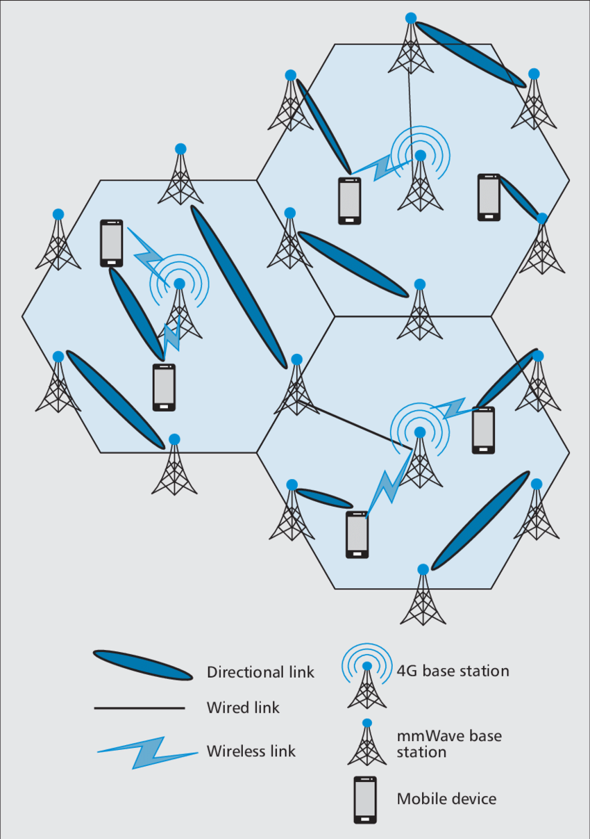

What Is a Cellular Network?
A cellular network, also known as a mobile network, is a wireless communication technology that enables mobile devices, such as smartphones and tablets, to transmit voice, data, multimedia, and other services in different geographical areas. The cellular network is the foundational infrastructure of modern mobile telephone and personal communication systems, playing a crucial role in driving the process of society digitization.
As shown in the diagram above, the core idea of a cellular network is to divide a large service area into multiple smaller cells. Each cell is equipped with a base station responsible for wireless communication with mobile devices within that cell. These base stations are interconnected through wired or wireless connections, forming a network that covers the entire service area. In traditional theory, these cells are designed as hexagonal, circular, or square shapes, with hexagons being the most common. The interconnection between cells enables complete coverage of the region, resembling a honeycomb, which is why this technology is referred to as cellular networks. Nowadays, the coverage areas of many base stations no longer have a cellular shape, but the term has persisted.

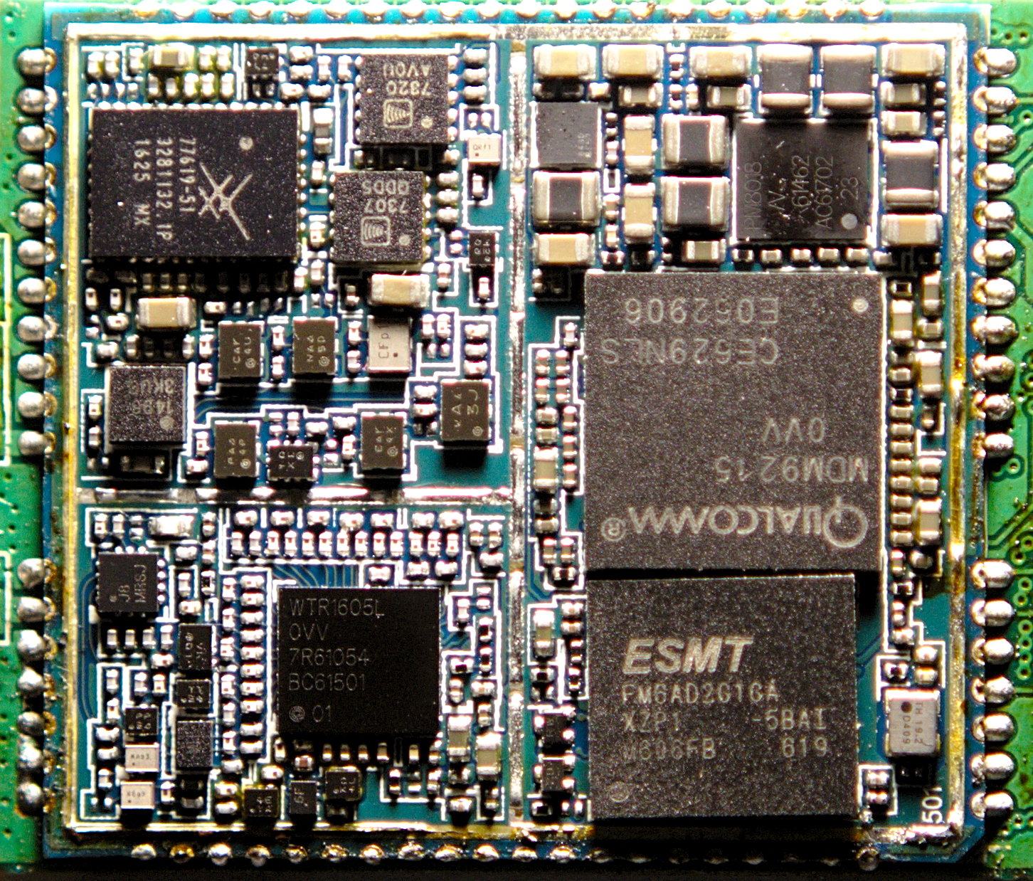

A wireless communication module, also known as a module or module unit, is an essential component for achieving data connection to IoT platforms and remote communication. It has been widely used in various IoT scenarios. From the perspective of functionality, a module serves as a bridge between local devices and networks. Just like plugging a USB network card into a computer to start accessing the internet, adding a module to an embedded system enables the connection to a wireless network.
Many users who encounter modules for the first time may feel unfamiliar with this strange device covered by a metal shield. Modules are different from traditional chips and discrete components. In reality, the essence of a module is a small Printed Circuit Board Assembly (PBCA). When we remove the metal shield on the surface of the module, we can still see a familiar (but denser) PCB circuit structure inside.
Users with experience in embedded system development should be familiar with "core boards" or System on Modules (SoM). Similarly, modules can be understood as "core boards" with high density, small size, shielding covers, and integrated various components required for wireless communication. They are used to complete the communication functions between local circuits and IoT platforms efficiently. In the introduction to communication at the beginning of this section, we talked about the concepts of encoding (decoding) and modulation (demodulation). In wireless communication processes, especially cellular communication processes, these steps tend to evolve and expand to be extremely complex. The role of the module is to help us complete these complex steps to achieve simple and efficient communication.

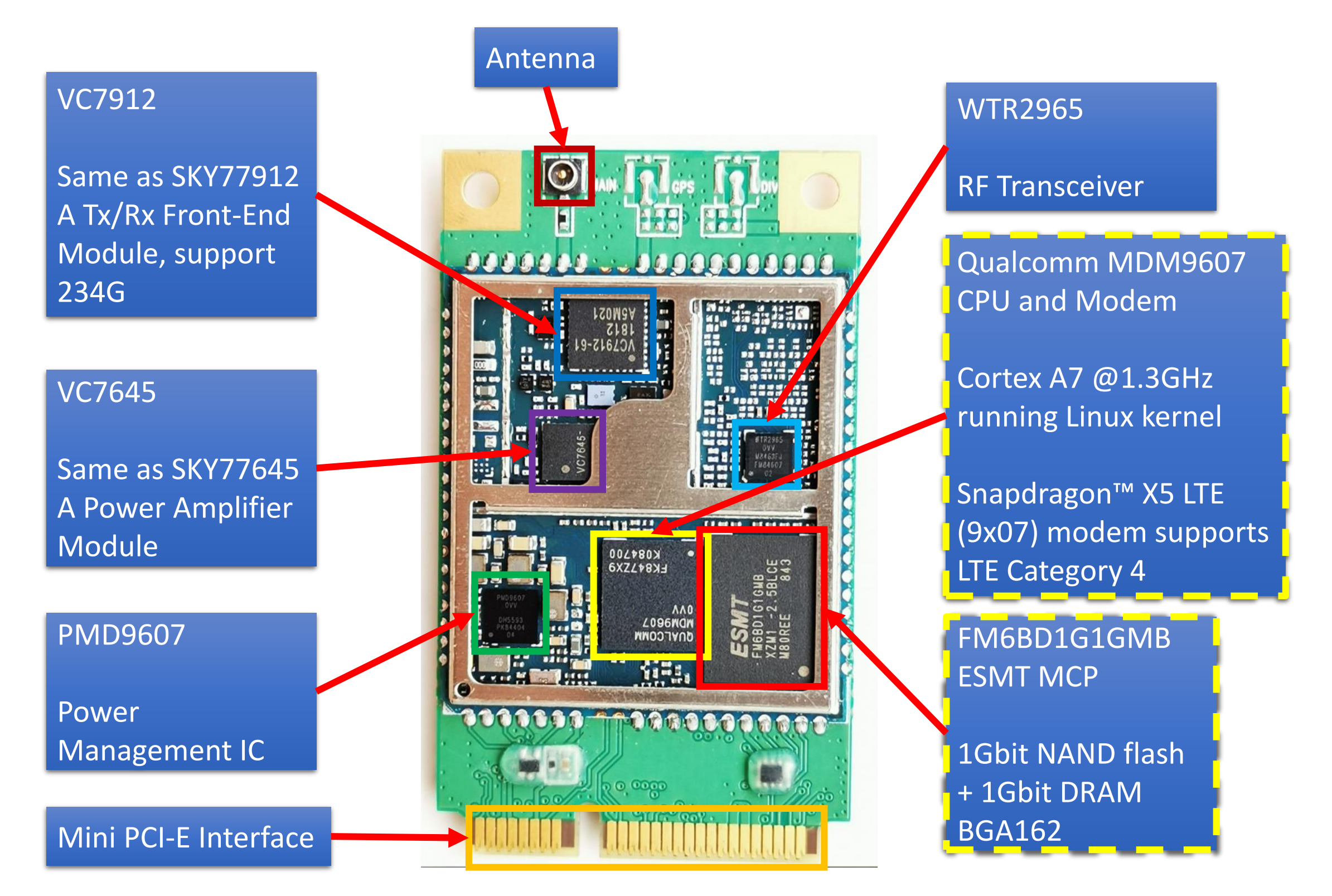

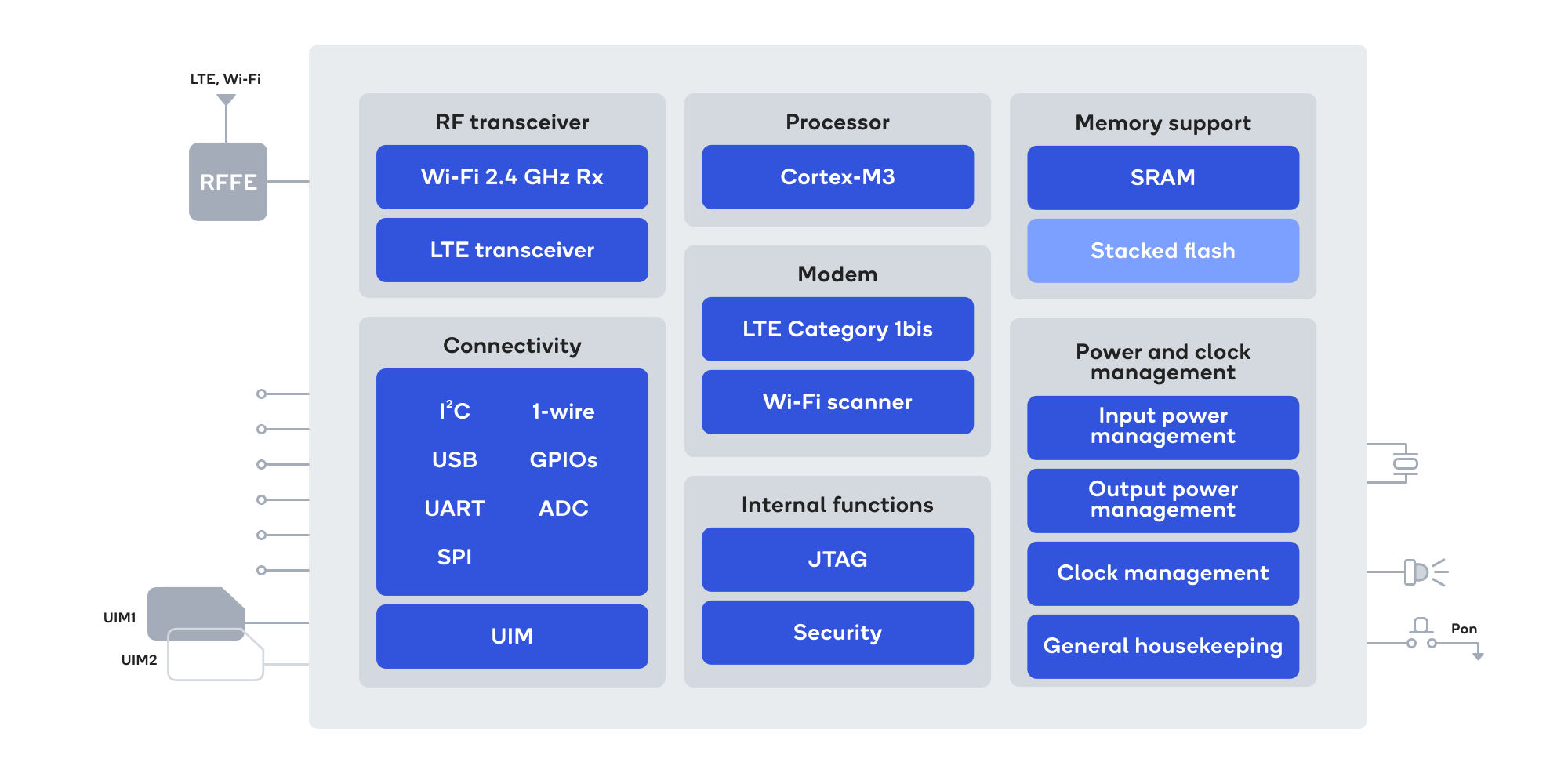

The internal structure of a module is complex. As shown in the following image, it includes various integrated components such as the main chip (Qualcomm MDM9607), memory, power management chip, power amplifier, RF front-end, as well as numerous small-sized packaged resistors and capacitors. Clearly, the complexity and precision of modules are much greater than that of traditional circuit boards.
The main chip, also referred to as the baseband chip or modem chip by some manufacturers, is the core of the entire module. Its role, functions, and features are similar to the SoC (System on Chip) in smartphones. With technological advancements and improvements in chip manufacturing processes, the main chip in modern modules usually integrates application processors (APs), baseband and RF functionalities, runs a complete operating system (RTOS or Linux), provides various interfaces such as GPIO and USB, and can perform various communication operations as required. In this sense, a module is both like a smartphone without a screen and battery and a more complex MCU.

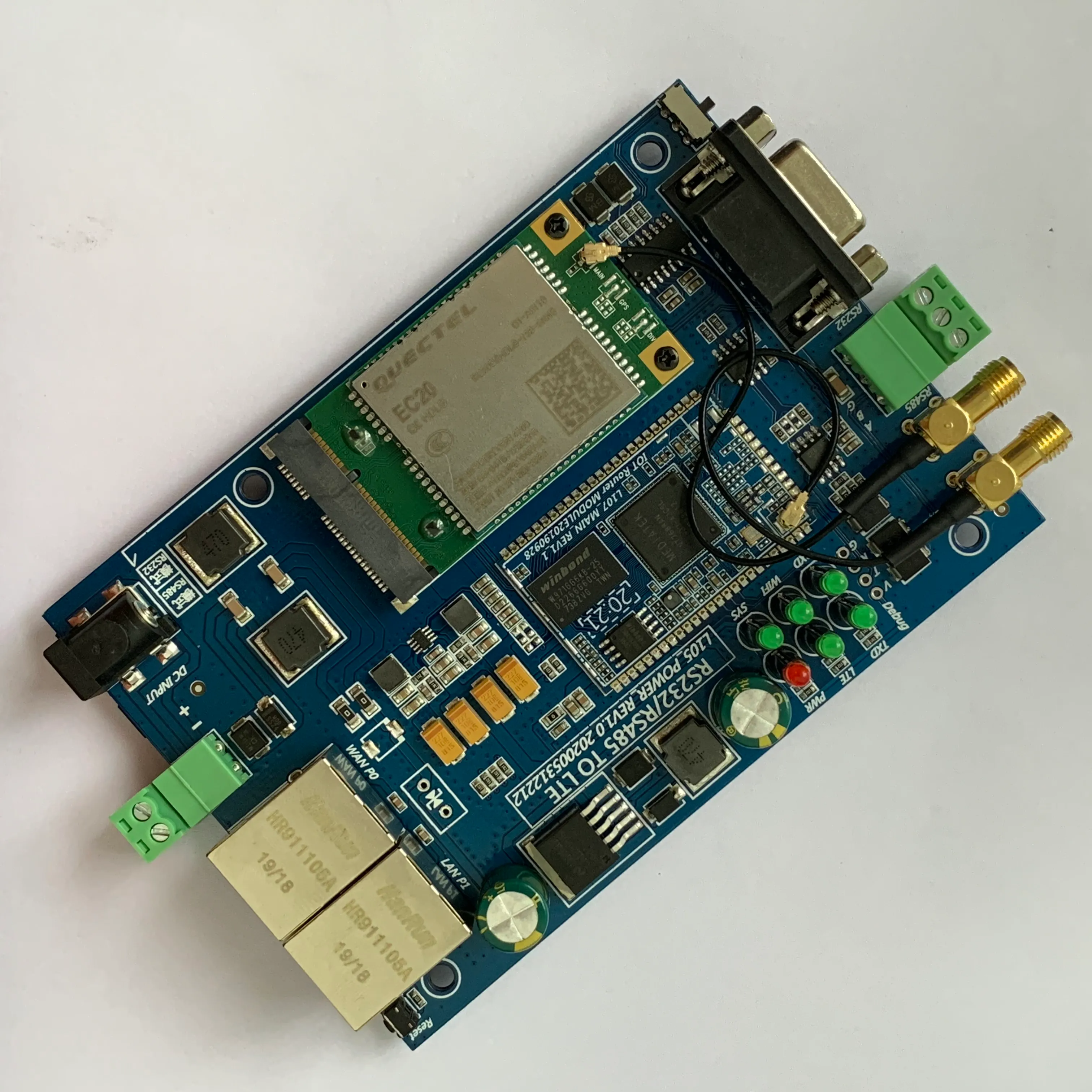

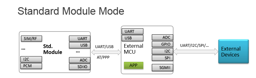

Standard Mode
Similar to regular smartphones, modules typically come with a built-in operating system and pre-installed applications. For many users, the preconfigured features of the module are sufficient to meet their network communication needs. This mode, known as Standard Mode or Traditional Mode, involves using the module as a ready-made functional unit without the need for further development or customization. It is currently the most common application mode for modules.
As shown in the diagram, in Standard Mode, the module is connected to the main controller (MCU), such as an STM32, via UART or USB interface for two-way communication using AT commands. The MCU serves as the core of the system, with the communication module acting as an independent peripheral device to the MCU. The main business logic (user app) runs on the MCU, and other external devices are connected to the MCU via interfaces like UART and I2C, controlled by the MCU.

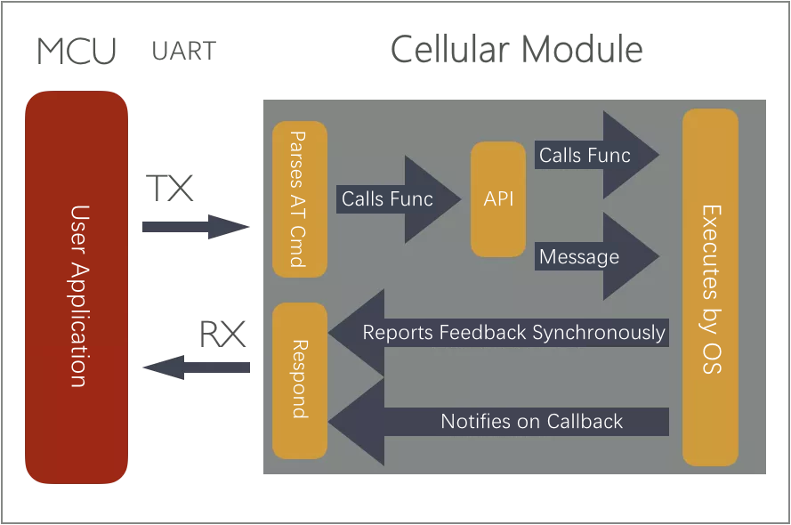

About AT Commands
AT command is one of the oldest and most widely-used communication command sets in the industry. It establishes a complete bidirectional communication mechanism between users (or MCUs) and modules. Users (or MCUs) control the module by sending AT commands, which include various functions such as network connection, voice call, and positioning. The module then returns the execution results and status to the user. This "send and receive" mechanism and the simple processing method are well-suited for embedded environments with limited resources. Nowadays, most modules on the market come with built-in AT server programs that can receive, parse, and execute specific AT commands.
For developers using modules in Standard Mode, the main development effort lies in the user app running on the MCU. The business codes in the app need to include complex functionalities such as sending AT commands and parsing return values, including handling Unsolicited Result Codes (URC), which is challenging for beginners.

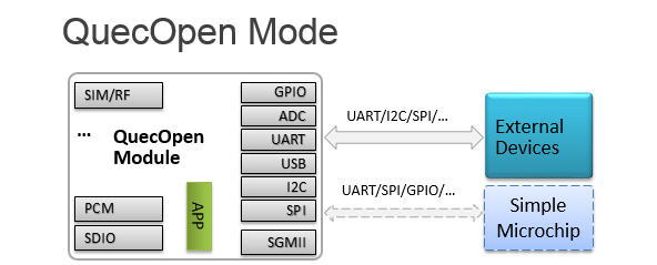

Custom Development Mode
In the content above, we mentioned that modules are like more advanced MCU. In fact, the main chips used in modules typically have higher performance and more resources to meet the requirements of wireless communication. These chips are equipped with various peripheral interfaces such as GPIO, ADC, and I2C. However, in Standard Mode, these resources are not directly accessible to users. "Lifting" these limitations and unleashing the full potential of modules requires custom development.
Custom development, in essence, involves combining and extending the basic functionalities and interfaces provided by the software to develop new features that meet specific user needs. In the context of module development, Custom Development Mode allows developers to call APIs and write their own applications on top of the underlying operating system, fully utilizing the module's resources and enabling additional possibilities.
The most significant advantage of custom development is that it allows modules to have the ability to replace the MCU to some extent. Therefore, this mode is also known as OpenCPU or OpenMCU (Different manufacturers may have different specific terms, such as QuecOpen by Quectel). As shown in the diagram, in comparison to Standard Mode, the OpenCPU mode utilizes the module itself as the MCU, where the user application runs within the module. The external devices are connected directly to the module, eliminating the need for an external processor (MCU) or requiring only a simple external chip (referred to as "Simple Microchip" in the diagram). This solution effectively simplifies hardware design, reduces component costs, and reduces the product size. With the high cost of MCUs today, the OpenCPU solution has gained popularity among many companies.
However, the OpenCPU solution also has some limitations. Since this solution typically involves developing directly on the underlying operating system running on the module, it requires a higher level of technical expertise. Traditional MCU developers without system-level development experience may be challenging. Additionally, due to the complexity of OpenCPU technical support, module manufacturers usually provide relevant tools and materials only to key customers, making it less accessible for newcomers. Finally, different manufacturers and module models may have significant differences in the OpenCPU development environment and tools, which can make porting programs between different modules difficult.
