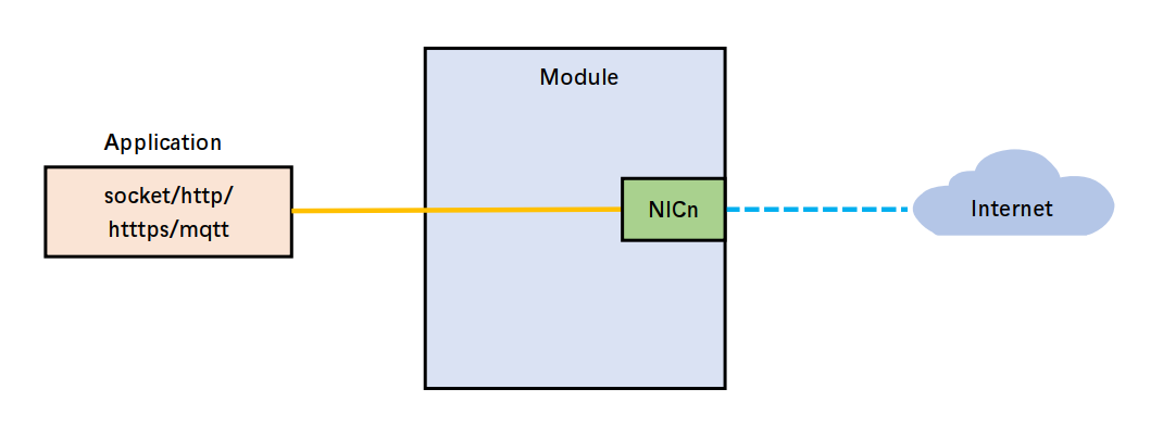

Automatically Activate One NIC at Startup Without Configuring APN
This scenario refers to the situation where the module has not configured any APN for any NIC and automatically activates one NIC at startup. There are two situations as follows.
Scenario 1: You have not configured any NIC to be automatically activated at module startup. In this case, QuecPython will automatically activate the first NIC by default. NICn in the following diagram represents the NIC1.
Scenario 2: You have configured a specific NIC to be automatically activated at module startup by calling dataCall.setAutoActivate. In this case, QuecPython will activate the NIC specified by you at module startup.
In both cases, only one cellular NIC is automatically activated at module startup. When using protocols such as socket, HTTP, and MQTT for network communication, the module does not need to specify the NIC and will automatically select the activated cellular NIC for network communication.
In this scenario, you should follow the steps below to write the application code.
Step 1: Use checkNet to wait for the network to be ready.
Step 2: Perform network communication.
Take the socket communication as an example:
import checkNet
import usocket
def main():
stage, state = checkNet.waitNetworkReady(20)
if stage == 3 and state == 1:
print('Network connected successfully.')
# Create a socket object
sock = usocket.socket(usocket.AF_INET, usocket.SOCK_STREAM)
# Resolve the domain name
try:
sockaddr = usocket.getaddrinfo('python.quectel.com', 80)[0][-1]
except Exception:
print('Domain name resolution failed.')
sock.close()
return
# Connect to the server
sock.connect(sockaddr)
# Send data to the server
ret = sock.send('GET /News HTTP/1.1\r\nHost: python.quectel.com\r\nAccept-Encoding: deflate\r\nConnection: keep-alive\r\n\r\n')
print('send {} bytes'.format(ret))
# Receive data from the server
data = sock.recv(256)
print('recv {} bytes:'.format(len(data)))
print(data.decode())
# Close the connection
sock.close()
else:
if __name__ == '__main__':
main()
The above sample code download link:Download
In this scenario, you do not configure any APN for the cellular NIC, but the module can still communicate normally after startup. However, there is a major issue: you may find that the application program written according to the above example can run normally in some places but fail in others, especially in countries or regions outside China. The specific manifestation is that the return value of the checkNet.waitNetworkReady() is not (3,1). The module fails to register on the network due to the lack of APN configuration.
Whether the cellular NIC can be successfully activated when no APN is configured depends on whether the automatic APN correction feature of the current base station is enabled. The automatic APN correction feature means that when the UE attaches to the network, if you do not configure an APN for the cellular NIC or configure an incorrect APN, the base station will automatically send a correct APN to the device and allow the UE to attach successfully.
That's why the above application program can run normally in China. Currently, most base stations of operators in China have the automatic APN correction feature, but some do not. We cannot determine in advance whether a base station supports this feature, so you are recommended to configure APN when using QuecPython modules. This is the scenario we are going to introduce next.

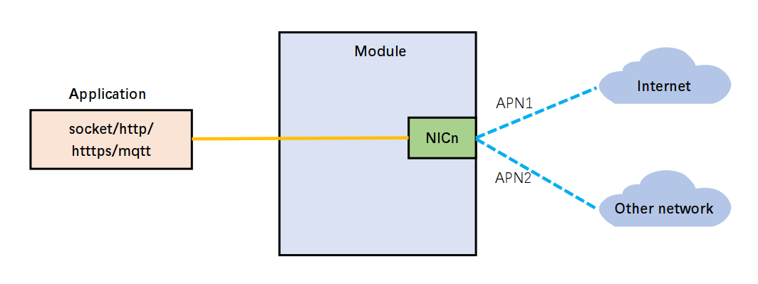

Automatically Activate One NIC at Startup and Configure APN
This scenario refers to the situation where you configure the correct APN for a specific cellular NIC based on the SIM card used, and the NIC with the configured APN is automatically activated at module startup.
In this case, when using protocols such as socket, HTTP, and MQTT for network communication, the module does not need to specify the NIC and will automatically select the activated cellular NIC for network communication. Depending on the configured APN, the module can access different networks, as shown in the following diagram. Please note that APN1 and APN2 in the diagram do not mean that the module can configure two APNs for one NIC at the same time, but represent different networks that can be accessed when different APNs are configured for one NIC.
Step 1: Check the current APN configuration of the NIC automatically activated at module startup and determine whether the APN needs to be configured. If the current APN is already the one you need to configure, there is no need to configure it again; otherwise, you need to configure the APN and reboot the module.
Step 2: Use checkNet to wait for the network to be ready.
Step 3: Perform network communication.
Take automatically activating the first cellular NIC at module startup as an example:
import checkNet
import usocket
import dataCall
from misc import Power
# Configure the APN information according to your actual needs
usrCfg = {'apn': '3gnet', 'username': '', 'password': ''}
```def checkAPN():
# Get the APN information of the first cellular NIC and check if the current one is the one you specified
pdpCtx = dataCall.getPDPContext(1)
if pdpCtx != -1:
if pdpCtx[1] != usrCfg['apn']:
# If it is not the APN you need, configure it as follows
ret = dataCall.setPDPContext(1, 0, usrCfg['apn'], usrCfg['username'], usrCfg['password'], 0)
if ret == 0:
print('APN configuration successful. Ready to restart to make APN take effect.')
print('Please re-execute this program after restarting.')
# Make a data call according to the configured information after the module reboots
Power.powerRestart()
else:
print('APN configuration failed.')
return False
else:
print('The APN is correct and no configuration is required')
return True
else:
print('Failed to get PDP Context.')
return False
def main():
checkpass = checkAPN()
if not checkpass:
return
try:
except Exception:
sock.close()
return
sock.close()
else:
print('Network connected failed, stage={}, state={}'.format(stage, state))
main()

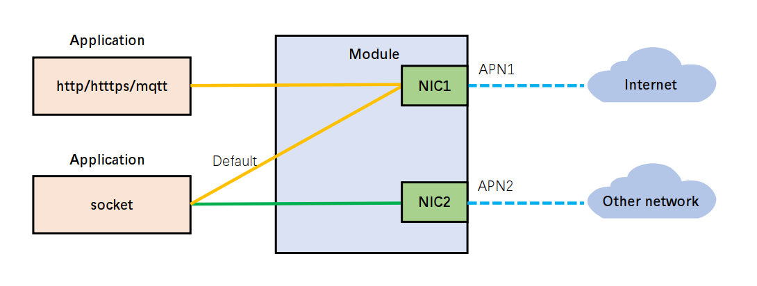

Automatically Activate Multiple NICs at Startup and Configure APN
This scenario refers to a situation where you need the module to automatically activate multiple cellular NICs at startup. The application program can access different networks using different NICs, for example, one NIC for public network access and another for private network access.
In this scenario, you need to configure the automatic activation of multiple cellular NICs at module startup and configure different APNs for each of the activated NICs. We will take the diagram below as an example to illustrate the automatic activation of NIC1 and NIC2 at startup.
When you configure the automatic activation of NIC1 and NIC2 at module startup, and configure an APN that allows access to the public network for NIC1, and an APN that only allows access to a specific private network for NIC2, the situation is as follows:
Features like HTTP, HTTPS, and MQTT can only use NIC1 for network communication by default, and you cannot specify which NIC to use.
The socket feature can be used to bind IP addresses and ports to determine which cellular NIC to use for network communication. If you do not specify, the NIC1 is used by default.
In QuecPython, when the module activates multiple cellular NICs and uses the socket feature for network communication, if you do not specify which NIC to use, the system will use the NIC with the smallest index by default. For example, if the module activates NIC1 and NIC2, NIC1 will be used. If the module activates NIC2 and NIC3, NIC2 will be used.
Step 1: Configure which cellular NICs should be automatically activated at module startup.
Step 2: Configure APNs for the NICs that need automatic activation.
Step 3: Reboot the module to make the configuration take effect.
Step 4: Use checkNet to wait for the network to be ready.
Step 5: Perform network communication.
Below is a sample routine - NIC1 and NIC2 are configured for automatic activation with different APNs. Two socket objects are created - socket1 uses default NIC1, while socket2 specifies NIC2 for private network access.
import checkNet
import usocket
import dataCall
usrCfg1 = {'profileID': 1, 'apn': '3gnet', 'username': '', 'password': ''}
usrCfg2 = {'profileID': 2, 'apn': '3gwap', 'username': '', 'password': ''}
def checkAPN(usrCfg, reboot=False):
if type(usrCfg) != dict:
print("Error: Input is not a dictionary.")
return False
print('Check the APN configuration of the {} network card.'.format(usrCfg['profileID']))
# Get the APN information of the cellular NICs and check if the current one is the one you specified
pdpCtx = dataCall.getPDPContext(usrCfg['profileID'])
if pdpCtx != -1:
ret = dataCall.setPDPContext(usrCfg['profileID'], 0, usrCfg['apn'], usrCfg['username'], usrCfg['password'], 0)
if ret == 0:
print('APN configuration successful.')
if reboot:
print('Ready to restart to make APN take effect.')
else:
return True
else:
return False
else:
return True
else:
return False
def main():
# Enable automatic activation for NIC1
dataCall.setAutoActivate(1, 1)
# Enable automatic reconnection for NIC1
dataCall.setAutoConnect(1, 1)
# Enable automatic activation for NIC2
dataCall.setAutoActivate(2, 1)
# Enable automatic reconnection for NIC2
dataCall.setAutoConnect(2, 1)
# Check the APN configuration of NIC1. Do not reboot now.
checkpass = checkAPN(usrCfg1, reboot=False)
if not checkpass:
return
# Check the APN configuration of NIC2. Reboot the module after configuration.
checkpass = checkAPN(usrCfg2, reboot=True)
if not checkpass:
return
# Get the IP addresses of NIC1 and NIC2
ret1 = dataCall.getInfo(usrCfg1['profileID'], 0)
ret2 = dataCall.getInfo(usrCfg2['profileID'], 0)
print('NIC{}:{}'.format(usrCfg1['profileID'], ret1))
print('NIC{}:{}'.format(usrCfg2['profileID'], ret2))
ip_nic1 = None
ip_nic2 = None
if ret1 == -1 or ret1[2][2] == '0.0.0.0':
print("Error: Failed to get the IP of the NIC{}.".format(usrCfg1['profileID']))
return
else:
ip_nic1 = ret1[2][2]
if ret2 == -1 or ret2[2][2] == '0.0.0.0':
print("Error: Failed to get the IP of the NIC{}.".format(usrCfg2['profileID']))
return
else:
ip_nic2 = ret2[2][2]
print('NIC{} IP:{}'.format(usrCfg1['profileID'], ip_nic1))
print('NIC{} ip:{}'.format(usrCfg2['profileID'], ip_nic2))
print('---------------sock1 test-----------------')
sock1 = usocket.socket(usocket.AF_INET, usocket.SOCK_STREAM)
try:
except Exception:
sock1.close()
return
sock1.connect(sockaddr)
ret = sock1.send('GET /News HTTP/1.1\r\nHost: python.quectel.com\r\nAccept-Encoding: deflate\r\nConnection: keep-alive\r\n\r\n')
data = sock1.recv(256)
sock1.close()
print('---------------sock2 test-----------------')
sock2 = usocket.socket(usocket.AF_INET, usocket.SOCK_STREAM, usocket.TCP_CUSTOMIZE_PORT)
sock2.bind((ip_nic2, 0))
sock2.settimeout(10)
# Configure server IP address and port number. The IP address and port number below are for example only
server_addr = ('192.0.2.2', 8305)
sock2.connect(server_addr)
ret = sock2.send('test data.')
try:
data = sock2.recv(256)
except Exception:
print('No reply from server.')

Manually Activate Multiple NICs
The scenario is similar to that of "Automatically Activate Multiple NICs at Startup and Configure APN". The only difference is that you need to disable the automatic activation at startup, and then manually activate the NICs when needed.
When you configure an APN that allows access to the public network for NIC1, and an APN that only allows access to a specific private network for NIC2, the situation is as follows:
- Features like HTTP, HTTPS, and MQTT can only use NIC1 for network communication by default, and you cannot specify which NIC to use.
- The socket feature can be used to bind IP addresses and ports to determine which cellular NIC to use for network communication. If you do not specify, the NIC1 is used by default.
Step 1: Disable the automatic activation feature of the NICs at startup. This configuration takes effect after the module is rebooted.
Step 2: Configure the APN for the NICs that need to be manually activated. This configuration takes effect after the module is rebooted.
Step 4: Manually activate the cellular NICs when needed.
Step 5: Confirm whether the activation is successful.
Step 6: Perform network communication.
Step 7: Decide whether to deactivate the NICs after communication ends as needed.
