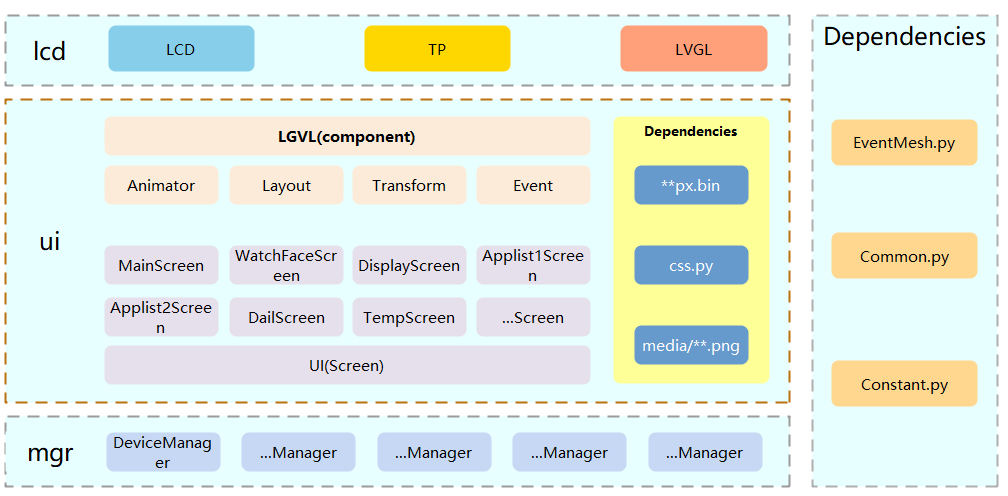

Software design
Software framework
Software design diagram
image-20231124112722602
Business system startup process
image-20231124140245780
Implementation
Code Catalog
The code for the wearable solution is hosted on GithubThe directory structure of the code is as follows:
|-- EventMesh.py
|-- common.py
|-- constant.py
|-- lcd.py
|-- css.py
|-- ui.py
|-- mgr.py
|-- main_t.py
|-- img
  • EventMesh.py is an event manager module that, when an event on a screen control is triggered, users only need to call the relevant interface to send the event, EventMesh It will automatically switch screen content.
  • common.py mainly provides common abstract base classes and common dependency classes, such as class Abstract which provides abstraction of the lifecycle.
  • constant.py mainly provides constant configuration.
  • lcd.py mainly providing driver initialization for LCD, The initialization of TP drivers and LVGL will only be displayed on the screen when this file is successfully initialized.
  • css.py mainly provides CSS functionality, static styles, font styles, etc. for use by screen objects in UI files.
  • ui.py
    • Provides the base class class Screen() for screen objects, providing common methods required for all screen objects, such as creating screens and displaying status bar information (operator name, signal strength, system time, battery level, etc.).
    • Class **Screen implements a class that inherits from class Screen(), which is the code implementation corresponding to the image that the screen needs to display. The main content of the interface code is automatically generated by the GUI Guider tool and then modified slightly, mainly by modifying the object initialization method __init__() and the control event handling callback function (__xxx_event_cb()), or modifying it during the lifecycle of the control
  • mgr.py mainly providing backend functions, allowing the interface to interact with various managers at different lifecycles or event triggers.

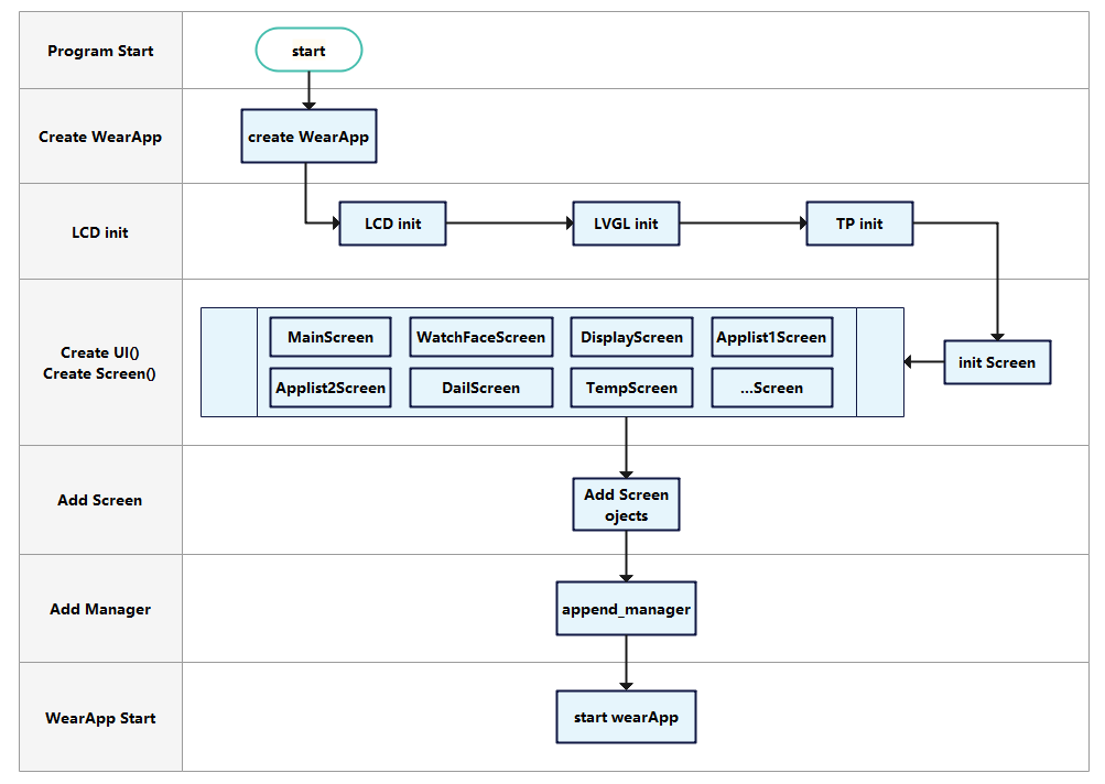

  • main_t.py is an application entry script file.
    • Call lcd.py to initialize the screen driver and display.
    • Initialize the APP and wear the app.
    • Call the class UI() provided by ui. py to create a GUI object for the wearing scheme, and call the screen object adder of the GUI object to add the required screen objects. When adding, the instantiation method of the page will be executed.
    • Call APP to add a manager and execute the instantiation method of the manager.
    • startup APP.
    • Jump to the main screen.

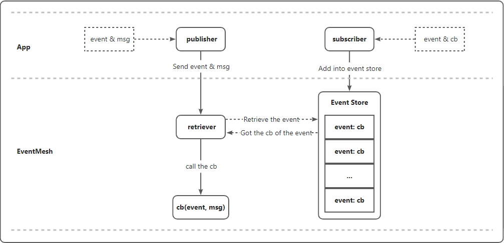

Screen switching mechanism
EventMesh Management Framework
As mentioned earlier, the interface switching is driven by the EventMesh event management framework.
  • EventMesh is an application framework based on subscription and publishing mechanisms, where users can subscribe to any topic of interest, which represents an event.
  • At the same time as subscribing to the topic, you also need to register a callback function to handle the generated events.
  • Users can post the event anywhere it occurs and carry the message content. At this point, the callback function registered by the subscriber will be called and the event will be processed.
EventMesh design framework is shown in the following figure:

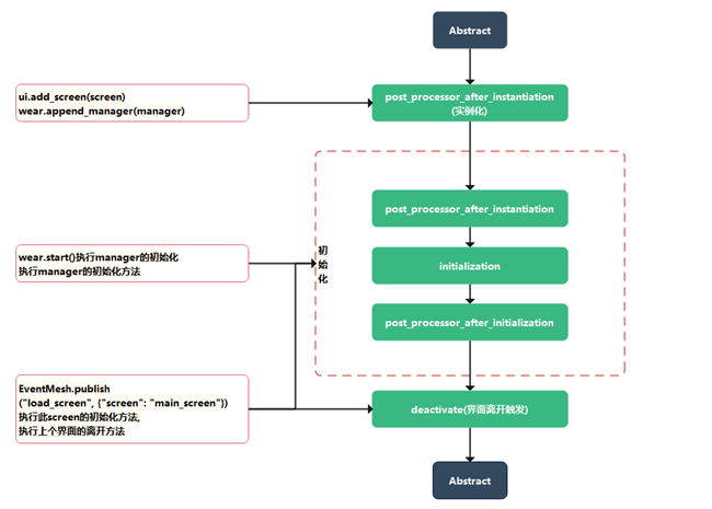

Principle of screen switching implementation
Sample lifecycle of page templates and redirects
# ui.py
# Any new class **Screen must inherit from Screen. The lv_obj must be predefined.
class DemoScreen(Screen):
    # NAME is required, it is used to find the screen when switching
    # For example we use EventMesh.publish("load_screen", {"screen": "demo_screen"}) to find this screen
    NAME = "demo_screen"
    def __init__(self):
        super().__init__()
    	# meta is the core switching object
        self.meta = app_list_screen
    	# prop contains info passed during the jump
    	# if EventMesh.publish("load_screen", {"screen": "demo_screen", “test”:1}) is called
    	# then prop = {"screen": "demo_screen", “test”:1}
        self.prop = None
    # Called only once when ui.add_screen(DemoScreen())
    # Users can implement initialization here
    def post_processor_after_instantiation(self, *args, **kwargs):
        """Called after instantiation"""
        pass
    # These methods will be called in sequence whenever
    # EventMesh.publish("load_screen", {"screen": "demo_screen"}) switches to this screen
        # post_processor_before_initialization
    	# initialization
    	# post_processor_after_initialization
    # Users can implement functionality here, called every time when switching to this screen
    def post_processor_before_initialization(self, *args, **kwargs):
        """Called before initialization"""
        pass
    def initialization(self, *args, **kwargs):
        """initialization"""
        pass
    def post_processor_after_initialization(self, *args, **kwargs):
        """Called after initialization"""
        pass
    # Called when leaving this screen, for example below will
    # first call deactivate() before calling main screen init()
    def deactivate(self, *args, **kwargs):
        """initialize load"""
        pass
# Note: If the screen is in a tileview, the mapping must be added for switching with
# EventMesh.publish("load_screen", {"screen": "main_screen"}) to work
# See example mapping below in UI class
class UI(Abstract):
    def __init__(self):
        self.screens = []
        self.current = None
        # display_screen maps to tile at column 0 row 0
        # main_screen maps to tile at column 0 row 1, etc
        self.tileview_map = {
            "display_screen": [0, 0, lv.ANIM.OFF],
    		"main_screen": [1, 0, lv.ANIM.OFF],
            "watch_face_screen": [2, 0, lv.ANIM.OFF],
            "app_list_1_screen": [3, 0, lv.ANIM.OFF],
    	# Reverse mapping of above
        self.tileview_position_map = {
            (0, 0): "display_screen",
            (1, 0): "main_screen",
            (2, 0): "watch_face_screen",
# What is tileview? For example, tile1 is at position column 1 row 0, supports left/right slide
tile1 = tileview.add_tile(1, 0, lv.DIR.RIGHT | lv.DIR.LEFT)
# Put main_screen on tile1, swiping left enters tile at (0,0), swiping right enters tile at (2, 0)
main_screen = lv_obj(
    parent=tile1,

The core statement of this code is EventMesh.publish("load_screen", screen_info), which sends an event called load_screen, meaning to load a new screen interface; The carried message is screen_info, screen_info is the name of the interface to be redirected to by {"screen": "blood_streen"}, indicating that the blood oxygen display interface is being loaded.
UI startup
The load_screenevent is subscribed to in the start() method of the class AgriUi(object) class in the Agri_ui.py script file.
code:
class UI(Abstract):
    def __init__(self):
    def lv_load(self, event, msg):
        for screen in self.screens:
            if screen.NAME == msg["screen"]:
                scr = screen
                if self.current != scr:
                    if self.current:
                        self.current.deactivate()
                        scr.last_screen_info = {"screen": self.current.NAME}
                    scr.set_prop(msg)
                    scr.post_processor_before_initialization()
                    scr.initialization()
                    scr.post_processor_after_initialization()
                    self.current = scr
                    if msg["screen"] in self.tileview_map:
                        lv.scr_load(tileview_screen)
                        tileview.set_tile_id(*self.tileview_map[msg['screen']])
                    else:
                        lv.scr_load(self.current.meta)
    def post_processor_after_instantiation(self):
        EventMesh.subscribe("load_screen", self.lv_load)
        EventMesh.subscribe("load_tileview", self.lv_tileview)
    def add_screen(self, screen):
        screen.post_processor_after_instantiation()
        self.screens.append(screen)
    def start(self):
        self.post_processor_after_instantiation()
The start() method in the above code is used to launch the graphical interface of the wearable solution, and its workflow is as follows:
  • Call the add_streen method to create metadata for each screen interface.
  • Call the EventMesh.subscribe() method to subscribe to an event named load_screen. When the event occurs, call the lv_load() method to process it.
    The lv_load() method matches the corresponding interface object based on the message carried when publishing the event, that is, the name of the screen interface, and calls lvgl's lv.scr_load() method to load a new interface.
    Observant readers will notice that in every class implemented in the screen interface script file, there will be statements similar to NAME=' main_streen'under its class. This statement records the name of the screen interface.
  • EventMesh.publish("load_screen", {"screen": "main_screen"}) is used to trigger the first interface display, which is the main interface.
At this point, the graphical interface of the wearable solution has been launched, and the subsequent interface switching is controlled by the user's touch.
