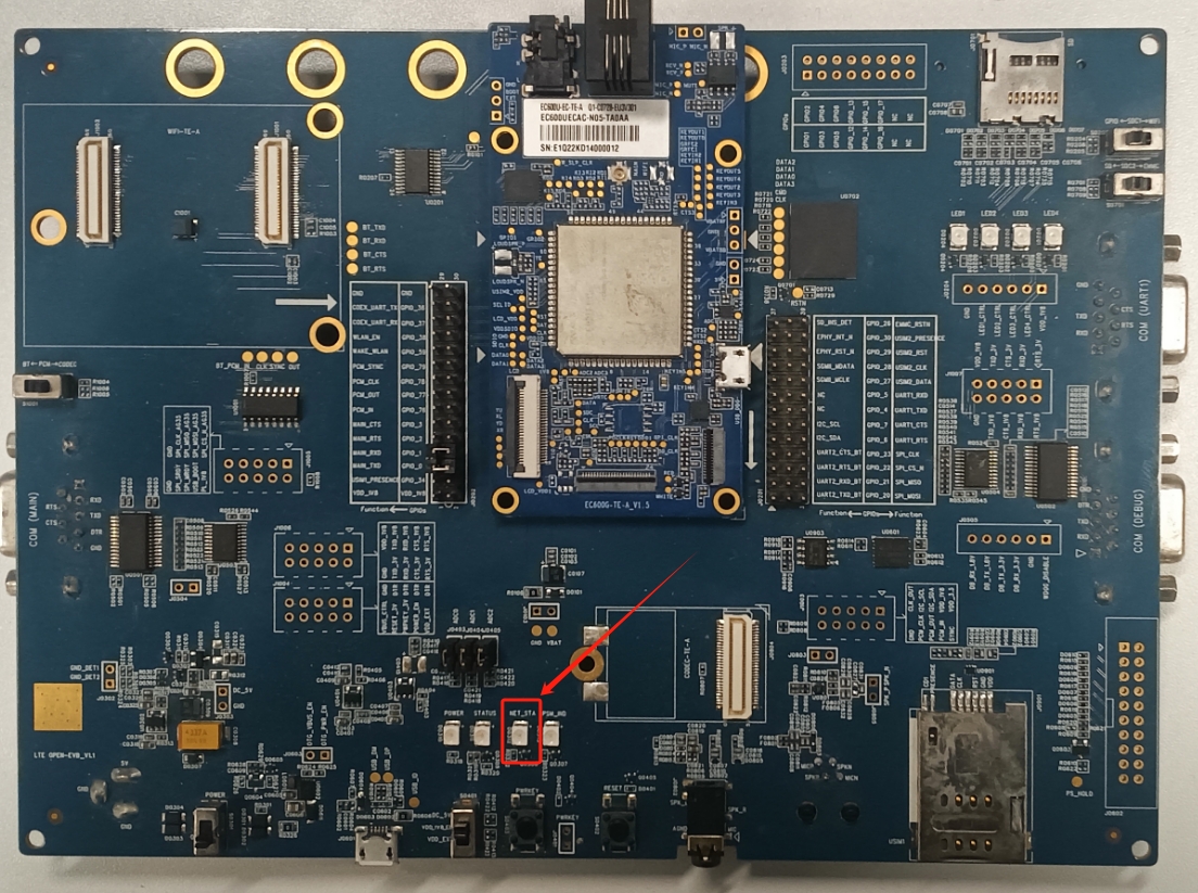

Test
In this section, it will perform how to manipulate LED using EC600U TE-A and LTE OPEN-EVB_V1.1.
Component: LED, QuecPython EC600U module and LTE OPEN-EVB_V1.1.
In convenience of test, the LED in LTE OPEN-EVB_V1.1 such as NET_STATUS can be deployed directly.
The NET_STATUS will be taken as network indicator by default. However, it is mandatory to disable network indicator via API beforehand. See misc in detail.
Moreover, it is available to turn off network indicator via following commands in EC600U module
import misc misc.net_light(0)# Reboot module after disabling network indicator funtion Parameter:0- OFF. 1- ON
Execute following steps once above procedure is done
- Reach pin that controls network indicator in EC600U module via Hardware_Design. It is found the NET_STATUS of EC600U is controlled by pin 54.
- After acquring pin number, it is available to find the exact GPIO 14 that corresponding to pin 54 in EC600U module based on the mapping relationship between GPIO pin number and physical pin via machine.Pin
- Compile script to control LED and run it
By running above codes via QPYcom, it is vivid that the NET_STATUS will blink with an interval of 1s.
Please note the GPIO number used to control NET_STATUS will be varied in accordance with different platforms.
