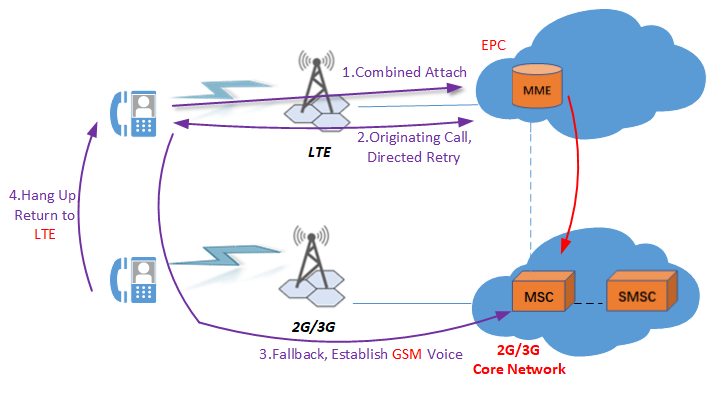

CS-based Voice Call Solution
Circuit Switched Fall Back is a mechanism that sends terminals that do not support IMS services in areas covered by both LTE and 2G/3G networks back to 2G/3G where it can successfully complete a CS Voice Call to maintain data service continuity.
In the CSFB solution, LTE terminals usually camp in the LTE network. When a voice call service is required, the network assists the terminal in falling back to the CS domain of the 2G/3G network. After the call ends, the terminal returns to the LTE network.
In addition to CS voice calls, the CSFB solution also supports other CS services, such as SMS.

CSFB Flow
CSFB_Flow_chart
The CSFB-based voice call solution can meet the requirements of mobile communication operators to provide voice communication in LTE networks and ensure the reliability of calls.

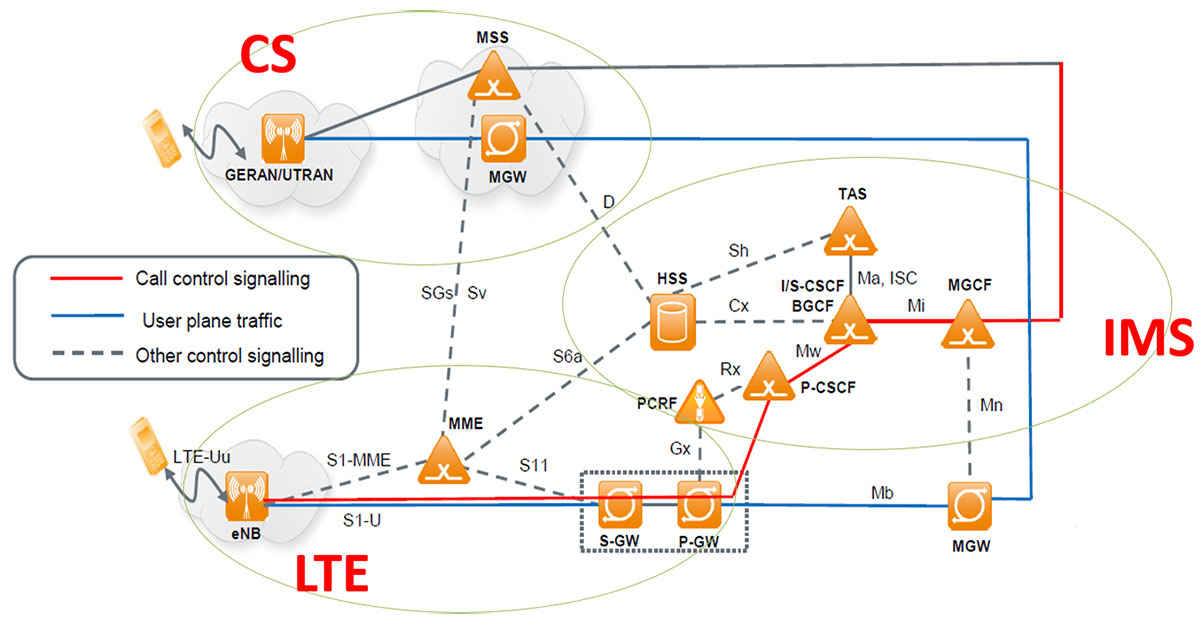

VoLTE-based Voice Call Solution
VoLTE (Voice over LTE) is a high-definition voice communication technology based on 4G networks. Compared to traditional CSFB technology, it provides better voice quality, faster call connection speed, and fewer call interruptions, thus better meeting users' needs for voice communication.
The VoLTE-based voice call solution is a way to implement voice communication on 4G networks. It uses IP networks for voice transmission without the need to convert to analog signals like traditional circuit-switched networks, enabling simultaneous high-definition voice calls and data transmission. With the VoLTE-based voice call solution, users can maintain high-quality voice calls and data transmission simultaneously, while also reserving more network bandwidth to make the entire network more stable and efficient.
Although implementing the VoLTE-based voice call solution requires more network construction and equipment upgrades, with the popularity of 4G networks and the arrival of 5G networks, more and more communication operators are adopting VoLTE technology to improve user call experience and network efficiency.

IMS
What is IMS
IMS (IP Multimedia Subsystem) is an IP-based multimedia service subsystem architecture that enables the integration of voice, video, data and multimedia content delivery over telecom networks.
IMS architecture combines traditional telephone networks with IP networks, utilizing SIP (Session Initiation Protocol) as the control signal to provide services across various networks. Furthermore, IMS can provide services on different terminals such as PCs, handheld devices, or VoIP terminals.
The key functionalities provided by IMS include:
  1. Creating and maintaining multimedia sessions, such as voice calls, video conferences, and messaging.
  2. Offering services, such as file sharing, instant messaging, social networks, and email.
  3. Providing user data management, such as profiles, address books, and network identification.
  4. Supporting QoS (Quality of Service) mechanisms to ensure service quality and performance of multimedia services.
  5. Supporting security and authentication mechanisms to ensure the confidentiality and integrity of user data.
The emergence of IMS is very significant because it enables telecommunications to expand from traditional voice communication into areas like data and multimedia communication. It also allows operators to build entirely new business models and value-added services through the IMS platform, thus strengthening their business competitiveness.

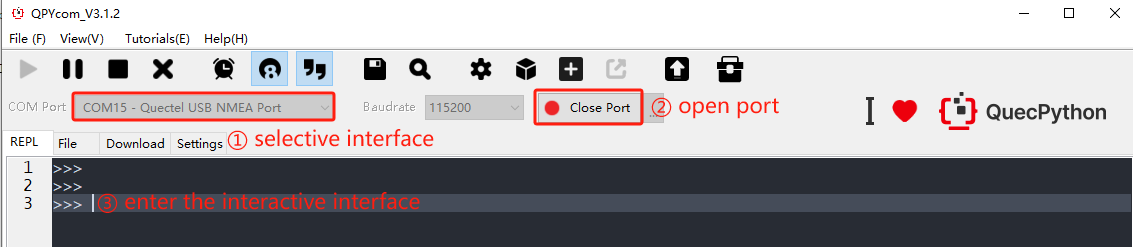

QPYcom_voiceCall_en
To view all events in the voice call process, such as incoming calls, call connections and hang-ups, the callback functions are registered in advance, as shown in 4.4 Callback Function Registration for Voice Calls.
In the following examples, "xxxxxxxxxxx" represents a phone number. During actual testing, the actual phone number will be displayed.
