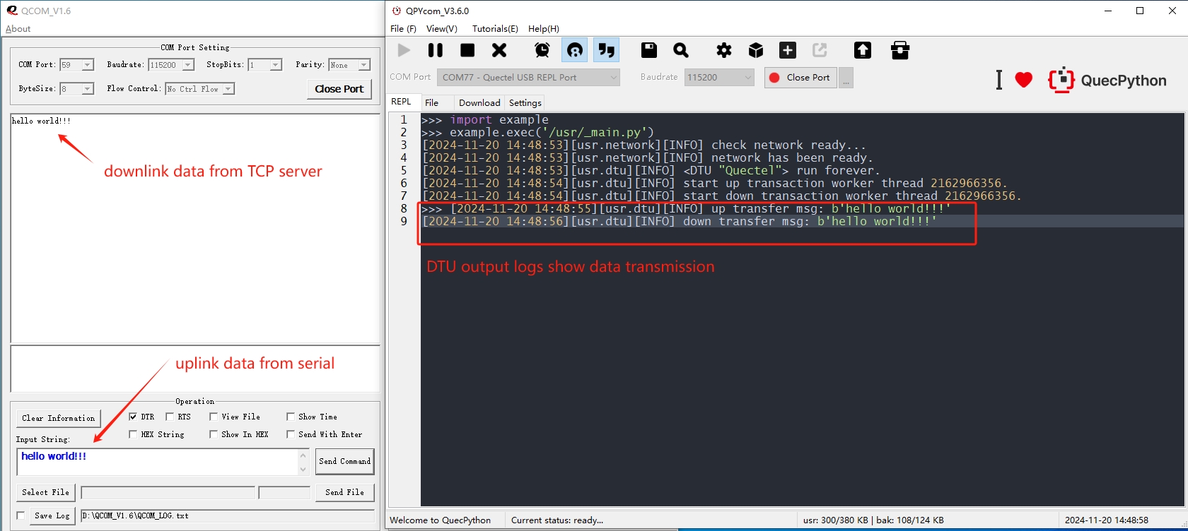

After the program is run, you can see the log output in the REPL interaction page as shown in the following figure.
In the illustration on the left, we use the QCOM simulation MCU to open the module serial port (i.e., the COM port corresponding to the USB-to-TTL module) for transparent transmission.
The illustration on the right shows the module log output by the REPL interactive interface.
Use the QCOM serial port tool to simulate the uplink serial port data of the MCU, and then transmit it through the DTU to the TCP echo server. Subsequently, the echo server will echo the same data and downlink it through the DTU to the QCOM.
In this case, TCP echo server is adopted. Therefore, the QCOM uplink data will be transmitted through DTU and then sent to the TCP server. After the TCP server receives it, it will immediately be sent down along the original path.
