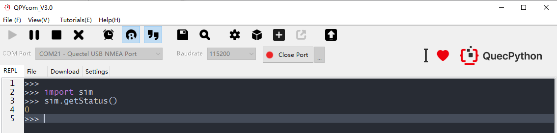

Device does not detect SIM card
Check the status of the SIM card using the following method:
Step 1: Connect the module to the USB port of the computer with a USB cable.
Step 2: Open QPYcom on the computer, open the QuecPython REPL command port (NMEA Port in the figure), and enter REPL mode.
Step 3: In the command line, call the following API to check the network registration status.
import sim
sim.getStatus()
If the return value of sim.getStatus() is 0, it means that the module does not detect a SIM card. In this case, you need to determine if a SIM card is inserted. If you have inserted a SIM card and the status value is still 0 after rebooting the module, the possible reasons are as follows:

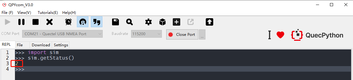

SIM card status exception refers to the situation where the return value of sim.getStatus() is neither 0 nor 1. The most common values are 2 and 3.

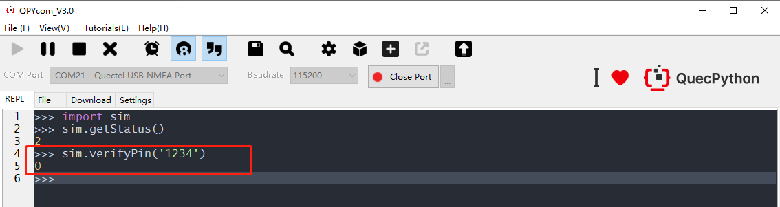

- When the SIM card status value is 2

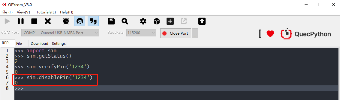

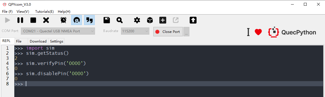

When the SIM card status value is 2, it means you have enabled PIN code verification for this SIM card. In this case, you need to enter the correct PIN code for verification, then disable the PIN code verification, and finally reboot the module. After booting, check the SIM card status again to see whether the return value is 1.
How to know which PIN code should be used for the SIM card? Generally, the default PIN code is marked on the standard SIM card. If you cannot find the standard SIM card, you need to confirm with the SIM card operator. Do not enter the PIN code randomly. It is strongly recommended that do not use PIN code-related functions casually, because it may cause the SIM card to be permanently unusable due to misoperation.
If you are using a China Unicom SIM card whose default PIN code is "1234", when the PIN code verification is enabled and the queried status value is 2, you can follow the steps below to restore it:
Step 1: Enter the PIN code for verification by calling the following function.
Step 2: Disable the PIN code verification.

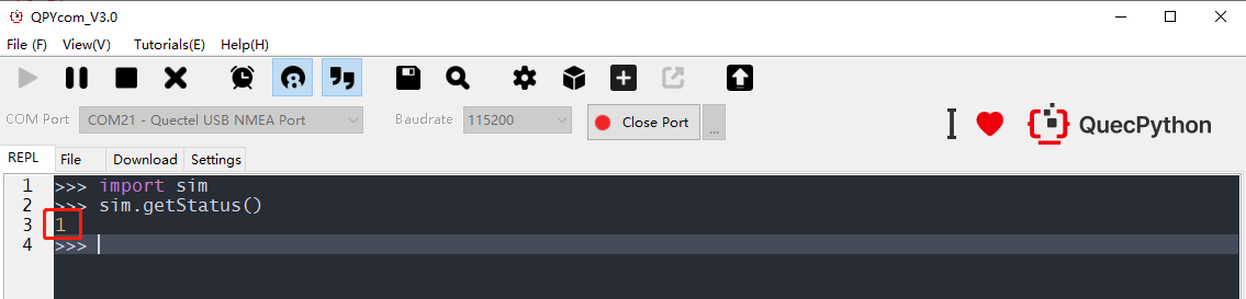

Step 3: Reboot the module and check the SIM card status again to see whether the return value is 1.

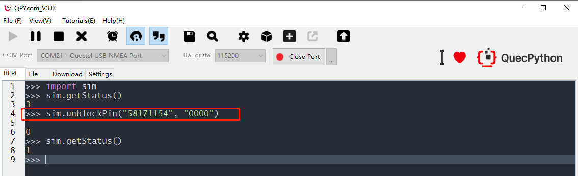

- When the SIM card status value is 3
When the SIM card status value is 3, it means that this card has been locked. In this case, you need to use the PUK code to unlock it. The PUK code can usually be found on the standard SIM card, as shown in the following figure:
Please note that each SIM card has its PUK code. When unlocking the SIM card, you must make sure to enter the correct PUK code. If the PUK code is entered incorrectly multiple times (usually 10 times. You can contact the SIM card operator to query the specific number), the SIM card will be permanently locked and cannot be used again.
Once you have confirmed the PUK code, you can follow the steps below to unlock it:
Step 1: Enter the correct PUK code to unlock it and set a new PIN code.
Call the following function to unlock the SIM card. This function has two parameters: puk represents the PUK code, and newPin represents the new PIN code to be set. Generally, the reason why the SIM card is locked is that you enabled PIN code verification, but entered incorrect PIN codes three times. Therefore, when you use the PUK code to unlock the SIM card, you need to set a new PIN code.
sim.unblockPin(puk, newPin)
From the above image, you can see that the SIM card has been successfully unlocked and the SIM card status has changed to 1. However, at this time, you have unlocked the SIM card but do not disable the PIN code verification. When you reboot the module, the SIM card status value will still be 2, indicating that you need to enter the PIN code for verification. Therefore, you can first disable the PIN code verification feature and then reboot the module. Of course, you can also unlock the SIM card, reboot the module, enter the PIN code for verification, and then disable the PIN code verification feature after successful verification.

Step 3: Reboot the module and check whether the SIM card status is 1.

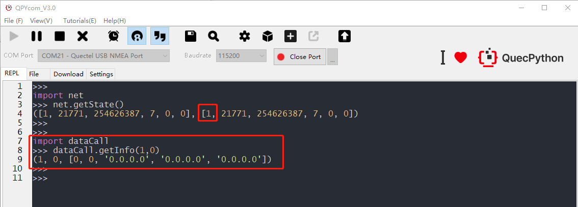

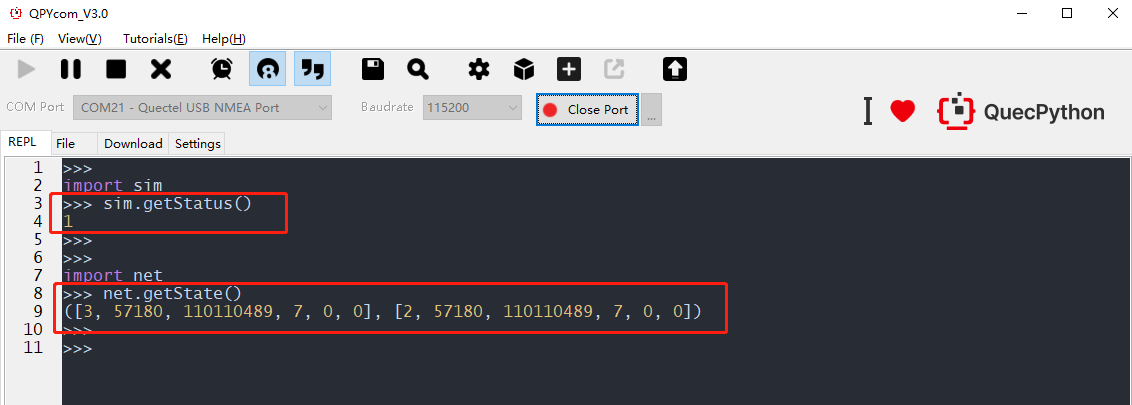

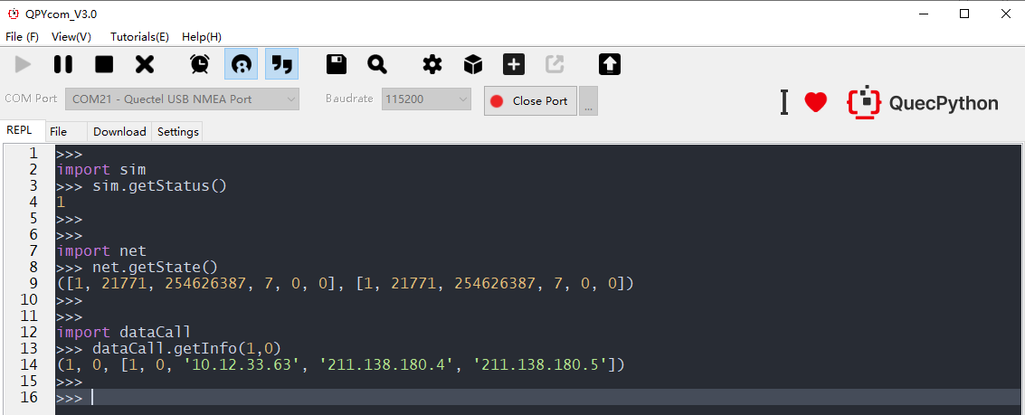

Situation 1: The SIM card status value is 1, the module has successfully registered on the network, and the cellular NIC has also been activated successfully, but network services, such as sending or receiving data, cannot be performed.
Situation 2: The SIM card status value is 1, but the network registration fails.
Please note that the SIM card in arrears is just the possible not the necessary reason for situation 2.

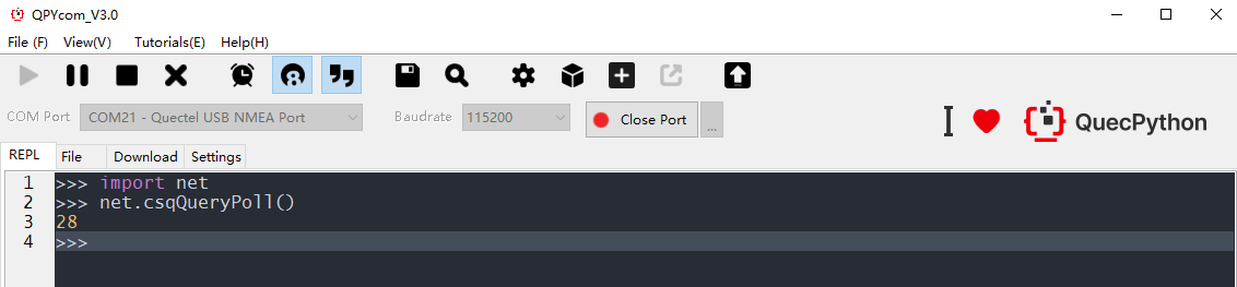

Poor RF performance
When the module has poor RF performance, messages may not be delivered to the base station or may not be received from the base station. As a result, the module fails to register on the network. In general, you can first check the CSQ signal strength of the module to make an initial judgment. If the CSQ value is less than 6, the module will have difficulty in network communication. You can call the following function to query the CSQ value.
net.csqQueryPoll()
The operation is as follows:
Many factors can affect the RF performance of the module, such as antenna absence, poor antenna performance, closed environment, lack of RF parameter calibration, hardware design flaws, or damaged RF components. Among these factors, you can directly check the following two:

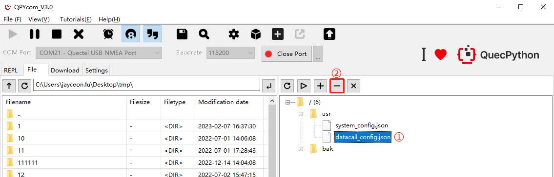

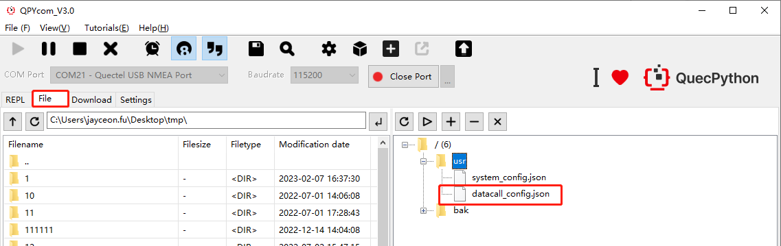

Step 1: Check whether there is a datacall_config.json file in the usr directory in QPYcom.
If there is a datacall_config.json file in the usr directory as shown in the following figure, it means that you have configured automatic activation or automatic reconnection of the NIC. If the file does not exist, there is no need to proceed with the following steps.
Step 2: Open the datacall_config.json file to further confirm the configuration of each NIC.

- Solution 1: Delete the
datacall_config.jsonfile in theusrdirectory and reboot the module.

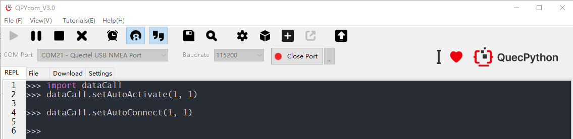

Here is an example of enabling the automatic activation and automatic reconnection of the first NIC.
>>> import dataCall
>>> dataCall.setAutoActivate(1, 1) # Enable the automatic activation of the first NIC
>>> dataCall.setAutoConnect(1, 1) # Enable the automatic reconnection of the first NIC
