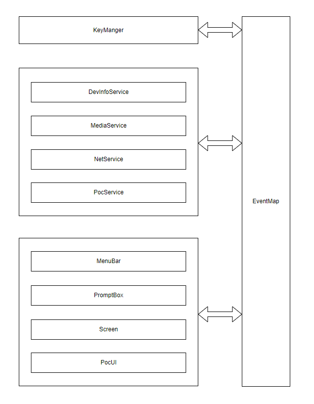

Software design
Software framework
Software Design Diagram
  • Key module
    • KeyManger: Used to manage key functions.

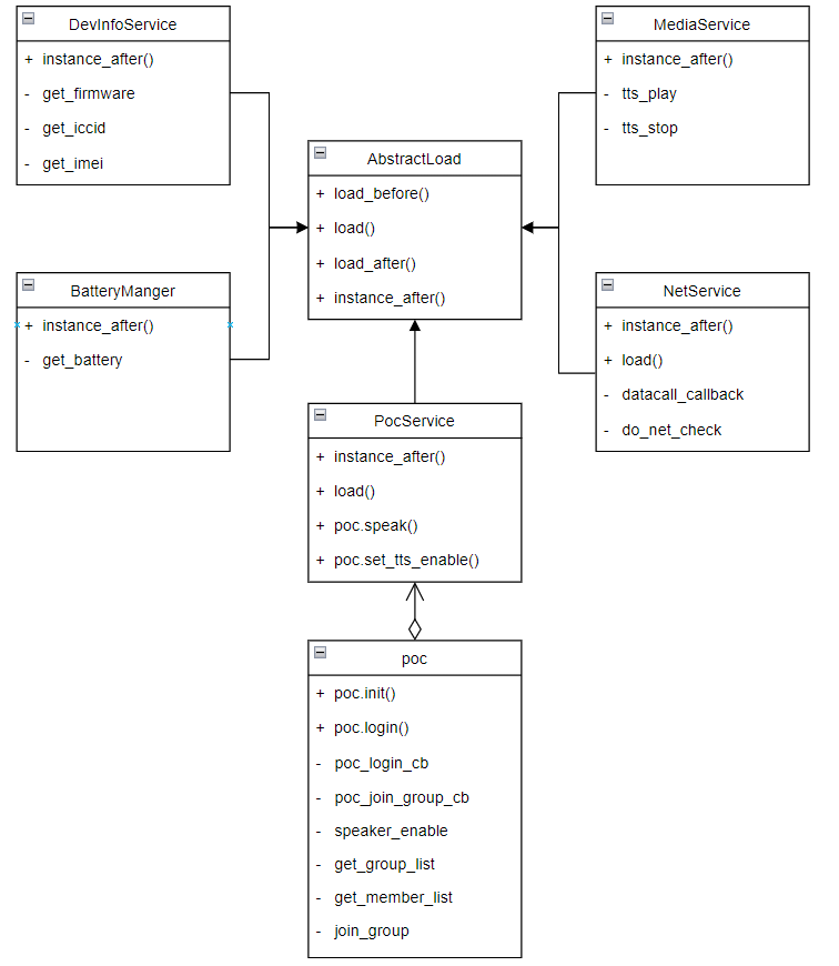

  • Service module
    • DevInfoService: Device Information Service, used to query device IMEI ICCID、 Firmware version information, etc;
    • MediaService: a media service used to manage TTS broadcasts, microphones, and audio processing;
    • NetService: a network service used to manage network status and heartbeat detection;
    • PocService: a POC service used for POC login, group acquisition, member acquisition, and intercom management.

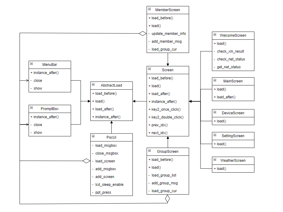

  • Interface module
    • MenuBar: Status bar, used to display signals, time, battery level, and intercom icons;
    • PromptBox: a prompt box used to display message pop-up information;
    • Screen: UI screen, used to display various interface information, customizable by users;
    • PocUI: Used to manage user-defined screens.
  • Event management module:
    • EventMap: Used for sending and binding events.

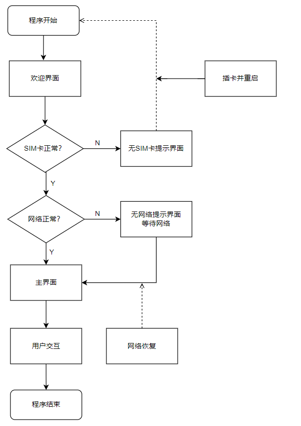

Business system startup process

Core Business Module (POC)
For API functions related to the POC library, please refer to POC Public Network Radio Explanation document.
  • Login
    By registering the poc.login() callback function, monitor the login status and perform corresponding operations based on the login results.
    The specific functions are as follows:
    1. Login callback: Register a callback function through poc.login() to listen for login status (param parameter indicates login success or failure).
    2. Successful login processing: If the login is successful (param==1), update the network status to normal and clean or store security data according to the platform type (standard platform or other platform).
    3. Login failure handling: If login fails, start a timer to regularly check the network connection status and mark the network error status.
    4. Network status check: Regularly check the network connection status through a timer to ensure that the device can try logging in again.
    5. Interface update: After successful login, notify the Welcome Screen to update the login status and query group information.
    This functional module ensures that the device can correctly log in to the POC platform and automatically attempt to reconnect in case of login failure.

    3. Network status check: If the network is abnormal (such as SIM card problems), prompt the user to replace the SIM card.
    4. Group status check: If the current group is invalid, prompt the user to select a valid group.

UI
  • The MenuBar class updates various components in the status bar by binding and sending events, ensuring that users can view key device information in real-time.
    1. Update signal strength: Obtain signal strength through events and display corresponding signal icons and network types (such as 4G).
    2. Update time: Obtain the current time through the event and display it in the status bar.
    3. Update battery level: Obtain the current battery level through events and update the battery level icon.
    4. Update intercom status: Display the corresponding icon based on the intercom status (intercom, playback) and control the visibility of the icon.
    The size of the status bar is 240 × 40, located above the LCD screen.

  • UI Screen
    The Membership Screen class inherits from Screen and is used to display member information on an LCD screen. It has a size of 240 × 200 and, together with the status bar, forms the complete LCD display area.
    1. Load member list: Retrieve member list data from the event and dynamically create list items to display on the screen.
    2. Manage selection status: Display the currently selected member item by highlighting the background color and scrolling effect.
    3. Button operation: Supports button events (such as single click, long press) to switch selected items or return to the main interface.
    4. Exception handling: If the member list is empty or there are no members, display a prompt pop-up and return to the main interface.
    5. Interface update: Dynamically update the list content when the member list changes.
    The design of this class implements dynamic loading and interactive management of member lists, ensuring that users can easily view and manipulate member information.
    Load and add styles
    class MemberScreen(Screen):
        NAME = "MemberScreen"
        def __init__(self):
            self.meta = lv.obj()    # lvgl meta object
            self.meta.add_style(CommonStyle.default, lv.PART.MAIN | lv.STATE.DEFAULT)
            # list------------------------------------------------------------------------------------------
            self.list_menu = lv.list(self.meta)
        def load_before(self):
            EventMap.bind("get_member_check_list", self.__get_member_check_list)
            EventMap.bind("send_select_member_list", self.__send_select_member_list)
            EventMap.bind("update_member_info", self.update_member_info)
        def load(self):
            self.__load_member_list()
            self.__member_screen_list_create()
            self.__load_group_cur()
            if self.member_list is None or self.member_list == -1 or not len(self.member_list):
                EventMap.send("load_msgbox", "This group has no members.")
                return False
            if self.cur >= 0:
                self.clear_state()
            self.cur = 0
            self.add_state()
        def add_state(self):
            currBtn = self.list_menu.get_child(self.curr_idx)
            currBtn.set_style_bg_color(lv.color_make(0xe6, 0x94, 0x10), lv.PART.MAIN | lv.STATE.DEFAULT)
            currBtn.set_style_bg_grad_color(lv.color_make(0xe6, 0x94, 0x10), lv.PART.MAIN | lv.STATE.DEFAULT)
            self.btn_list[self.curr_idx][2].set_long_mode(lv.label.LONG.SCROLL_CIRCULAR)
            currBtn.scroll_to_view(lv.ANIM.OFF)
        def clear_state(self):
            currBtn.set_style_bg_color(LVGLColor.BASE_COLOR_WHITE, lv.PART.MAIN | lv.STATE.DEFAULT)
            currBtn.set_style_bg_grad_color(LVGLColor.BASE_COLOR_WHITE, lv.PART.MAIN | lv.STATE.DEFAULT)
        def key2_once_click(self, event=None, msg=None):
            self.clear_state()
            self.curr_idx = self.next_idx(self.curr_idx, self.count)
            self.add_state()
        def key2_long_press(self, event=None, msg=None):
            EventMap.send("close_msgbox")
            EventMap.send("load_screen",{"screen": "MainScreen"})
            if self.curr_idx > 0:
                self.clear_state()
                self.curr_idx = 0
    Create a member list and display member information

Event management
  • The EventMap class maintains an event mapping table (__event_map) to enable the sending and binding of events, supporting both synchronous and asynchronous message sending modes.
    • Event binding: Use the bind() method to associate the event name with the callback function and store it in __event_map.
    • Event unbinding: Remove the callback function of the specified event using the 'unbind()' method.
    • Event sending:
      • Synchronized sending (MODE_SYNC): Directly executes callback function in the current thread and returns the execution result.
      • Asynchronous send (MODE_SYNC): Execute callback function in a new thread without blocking the current thread.
    • Error handling: Capture exceptions when executing callback functions and record error logs (if logging is enabled).
    • Logging: Supports recording the execution information of events for debugging and troubleshooting purposes.
  • This functional module is the core of communication between various modules in the system, ensuring that events can be efficiently and reliably transmitted and processed.
class EventMap(object):
    """===example===
    import EventMap
    def time_out(event=None, msg=None):
        pass
    EventMap.bind("time_out", time_out)
    EventMap.send("time_out")
    __event_map = dict()
    __event_log = None
    MODE_SYNC = 0
    MODE_ASYNC = 1
    @classmethod
    def bind(cls, event, callback):
        :param event: event name
        :param callback: event callback
        if None == event or "" == event:
            return
        cls.__event_map[event] = callback
    @classmethod
    def unbind(cls, event):
            return
        cls.__event_map.pop(event, None)
    @classmethod
    def send(cls, event, msg=None, mode=MODE_SYNC):
        :param msg: event message
        :param mode: send mode, sync or async
        if event not in cls.__event_map:
            return
        if cls.MODE_SYNC == mode:
            res = None
            try:
                if event in cls.__event_map:
                    res = cls.__event_map[event](event, msg)
            except Exception as e:
                if cls.__event_log:
                    cls.__event_log.info("ERROR executed (event) -> {} (params) -> {} (result) -> {}".format(event, msg, res))
                usys.print_exception(e)
            if cls.__event_log:
                cls.__event_log.info("SYNC executed (event) -> {} (params) -> {} (result) -> {}".format(event, msg, res))
            return res
        elif cls.MODE_ASYNC == mode:
            try:
                _thread.start_new_thread(cls.__event_map[event], (event, msg))
                if cls.__event_log:
            if cls.__event_log:
                cls.__event_log.info("ASYNC executed (event) -> {} (params) -> {} (result) -> {}".format(event, msg, None))

Service module
services.py defines multiple services to provide various services. Theseservices inherit the AbstractLoad abstract loading base class, making it easier to provide various service items during the loading process.
  1. BatteryManger: Provides battery level management
  2. DevInfoService: Provides device information services
  3. MediaService: Provides audio services
  4. NetService: Provides network services
  5. PocService: Provides PoC intercom service
The relationship between each 'service' is shown in the following figure:
If users need to add a service, they can refer to the existing service style and add it to the corresponding position in poc_main.py.

In ui.py, multiple UI interfaces are defined, such as:
  1. PocUI: Main UI, providing MenuBar , PromptBox and Screen, and Response Handling of Key Events
  2. MenuBar: Menu bar (used to display network status, time, battery level, and other icons, always displayed at the top of the screen, with a size of 240 * 20)
  3. PromptBox: Message prompt box (used for message prompts, displayed on the current UI interface)
  4. Screen: UI screen, also known as UI interface, is used to display various interfaces to users. Such as GroupScreen, WelcomeScreen and MemberScreen, etc
The relationship between various UI interfaces is shown in the following figure:
If users need to add a Screen, they can refer to the existing Screen style and add it to the corresponding position in poc_main.py.
