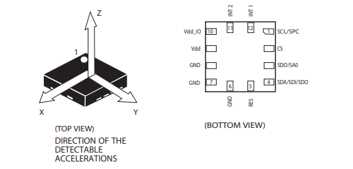

Package Specification
LIS2DH12TR sensor package specifications:
Hardware Connection
Pin function introduction:
| Pin Number | Pin Name | Description |
| 1 | SCL SPC |
I2C/SPI clock pin. |
| 2 | CS | SPI enablement pin, used to control the chip communication mode. 1: I2C communication; 2: SPI communication. |
| 3 | SDO SA0 |
Data output pin in SPI mode; Device slave address selection pin in I2C mode. 1: 0x19; 0: 0x18. |
| 4 | SDA SDI SDO |
Data pin in I2C mode; Data input/output pin in SPI mode; |
| 5 | RES | Ground. |
| 6 | GND | Ground. |
| 7 | GND | Ground. |
| 8 | GND | Ground. |
| 9 | Vdd | Power supply. |
| 10 | Vdd_IO | IO reference level pin. |
| 11 | INT2 | Interrupt pin 2. |
| 12 | INT1 | Interrupt pin 1. |
