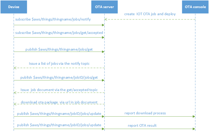

2. Receive Cloud Platform Upgrade Messages
Users create and deploy OTA jobs on the cloud platform webpage. The device periodically polls for message notifications and obtains the upgrade package URL from the message. After initializing the cloud platform functionality, subscribe to topics related to OTA jobs and periodically publish specific topics to receive message notifications sent by the cloud platform.
3. Download Upgrade Package
Once the upgrade package URL is obtained, the device uses firmware upgrade-related APIs for package download, writing, and verification. For API details, refer to fota - Firmware Upgrade.

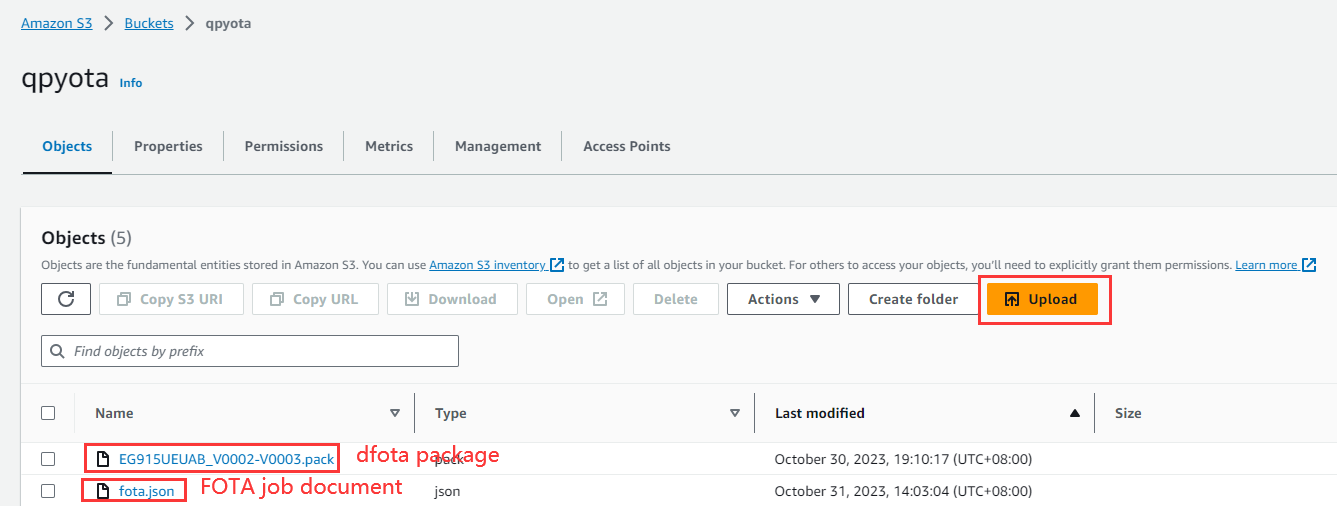

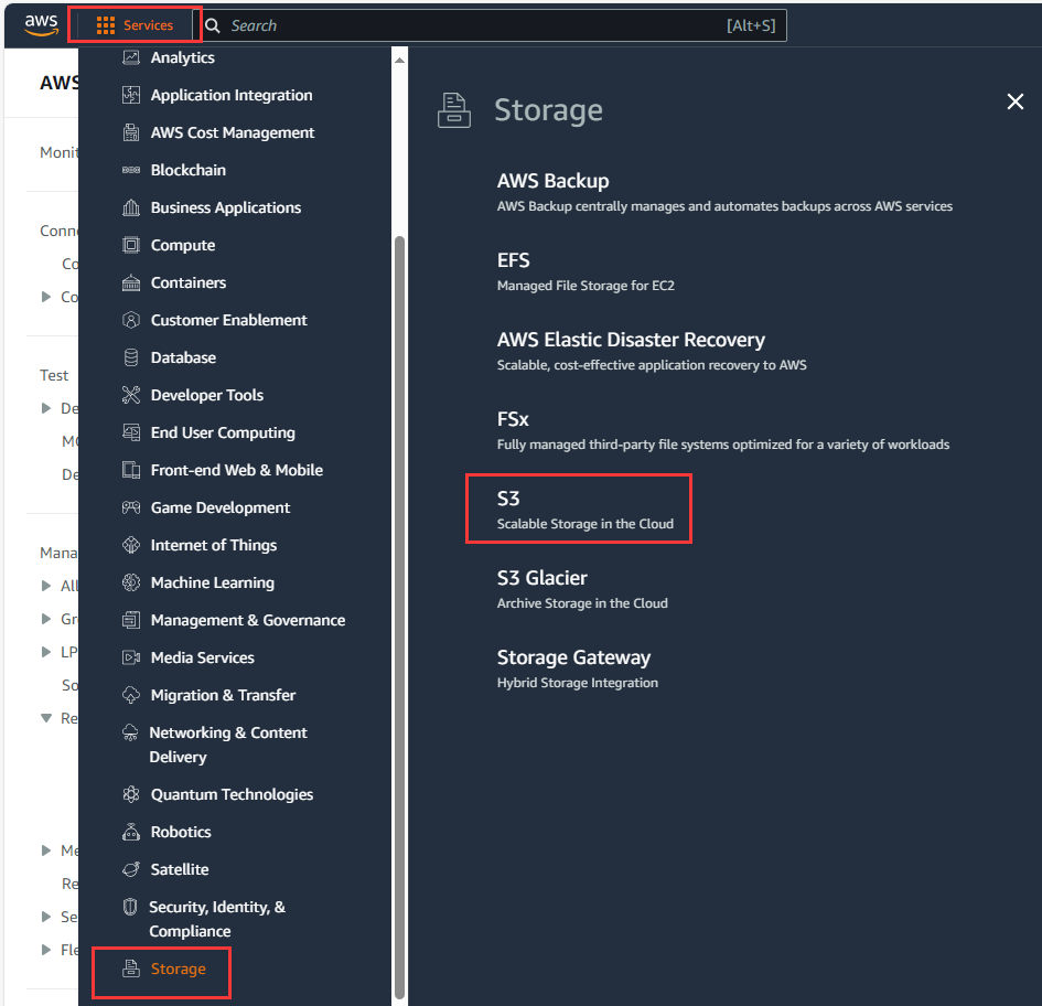

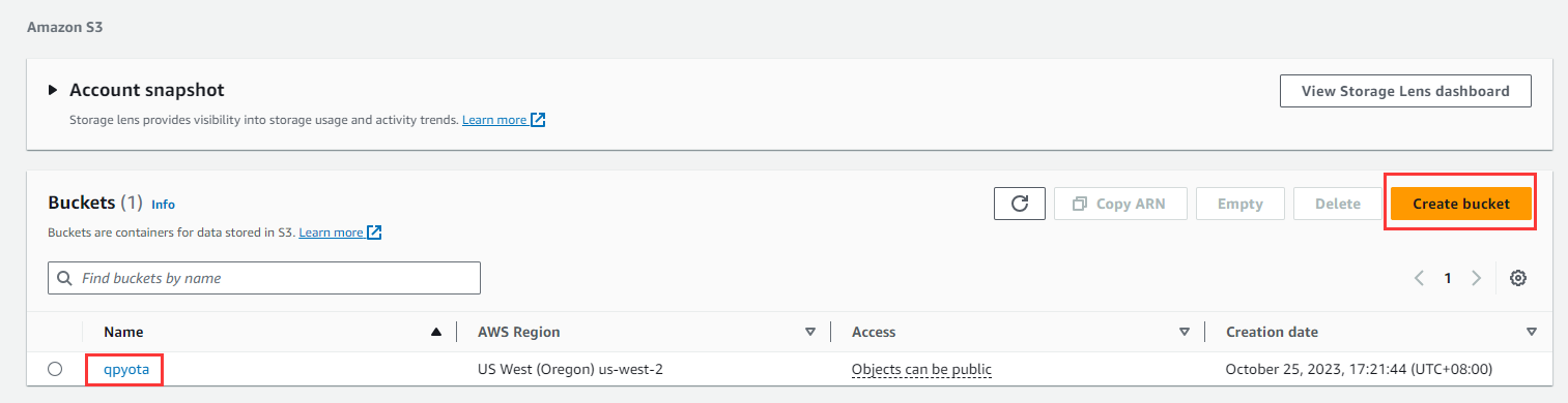

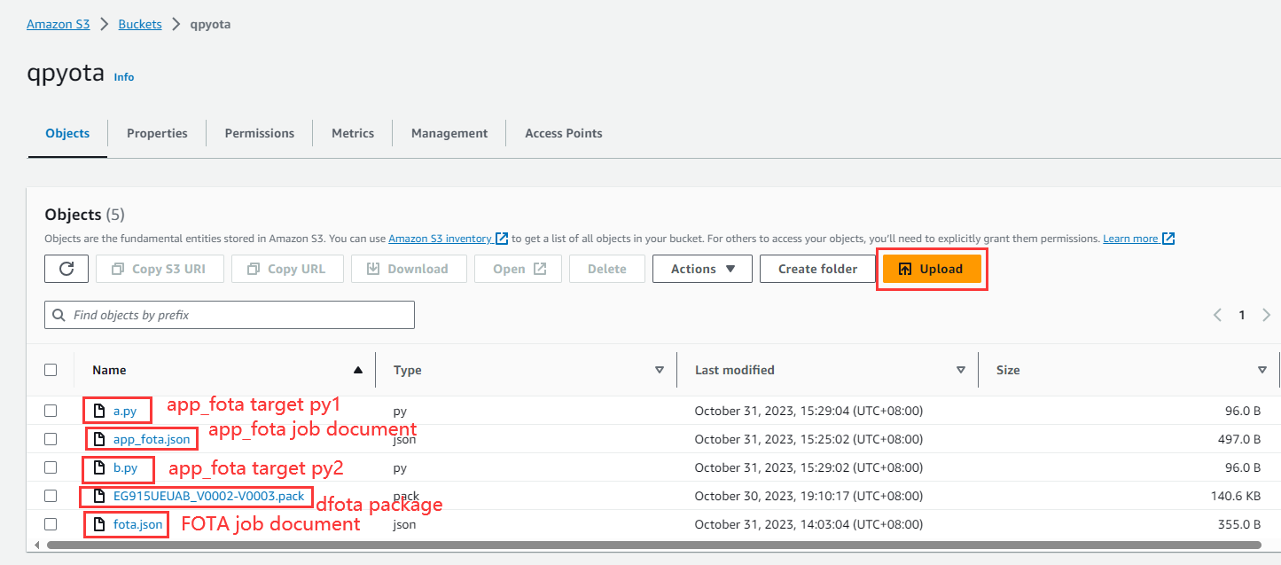

  1. Create an S3 storage bucket. In the image below, qpyota is the created storage bucket.

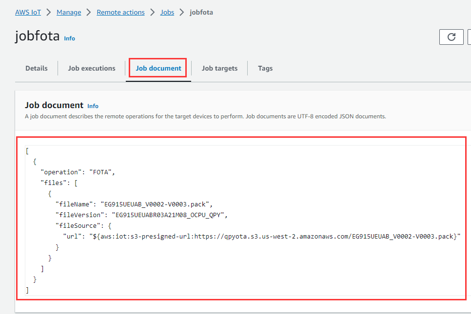

  1. Upload the upgrade package file and OTA job description document to the S3 storage bucket. Click the Upload button in the image below to perform the upload. In the image below, "EG915UEUAB_V0002-V0003.pack" is the differential package for FOTA upgrade, and fota.json is the description document for the FOTA upgrade job.
The format of the upgrade job description document is as follows:
     "operation":"FOTA",
     "files":[
           "fileName":"EG915UEUAB_V0002-V0003.pack",
    	   "fileVersion": "EG915UEUABR03A21M08_OCPU_QPY",
           "fileSource":{
              "url":"${aws:iot:s3-presigned-url:https://qpyota.s3.us-west-2.amazonaws.com/EG915UEUAB_V0002-V0003.pack}"

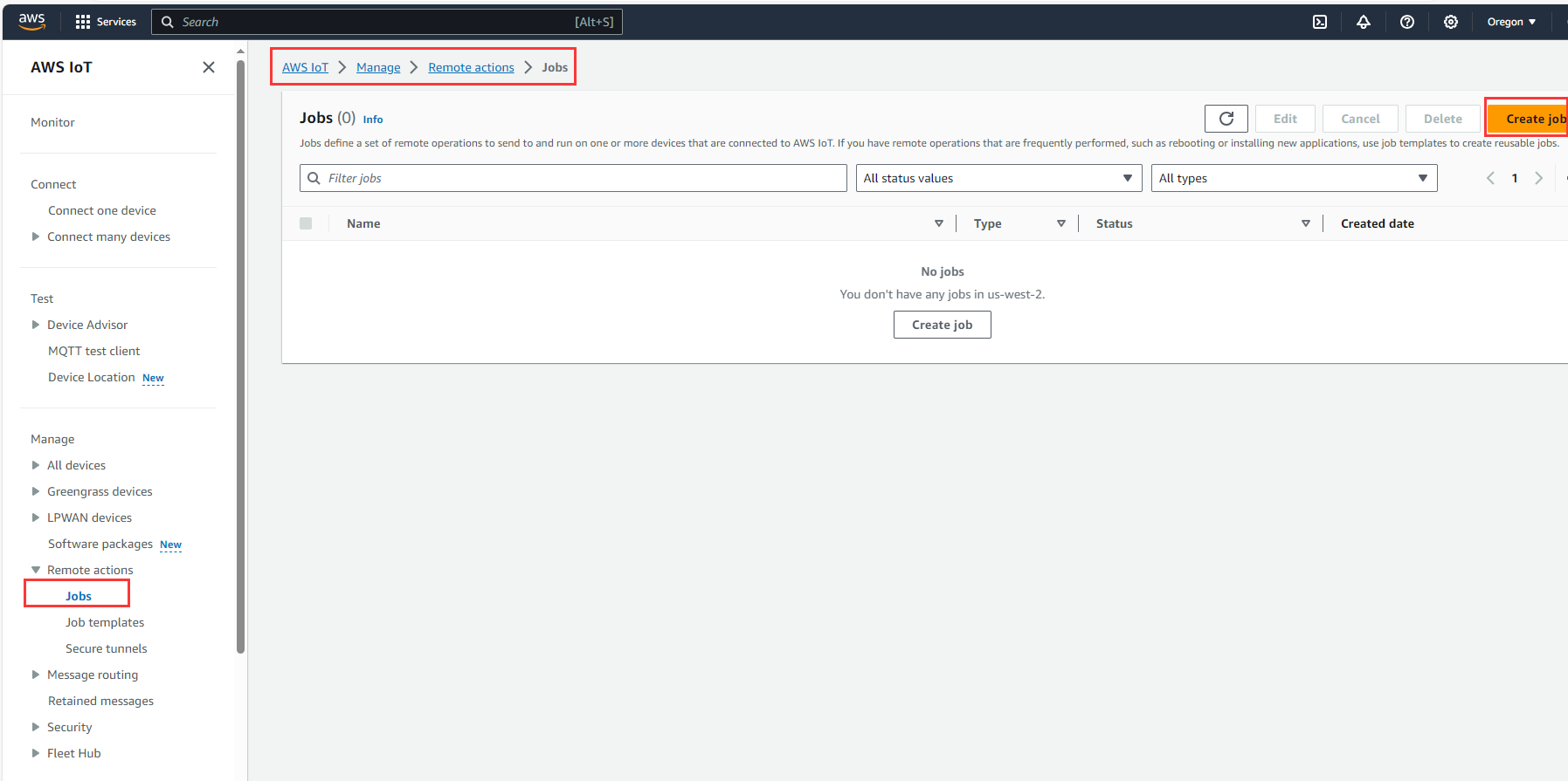

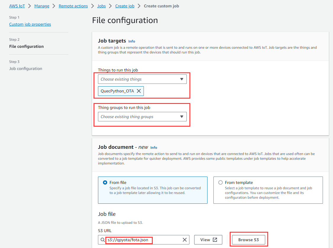

  1. Create OTA Upgrade Job
Navigate to the AWS IoT section, select Manage -> Remote actions ->Jobs, and click the Create Job button.

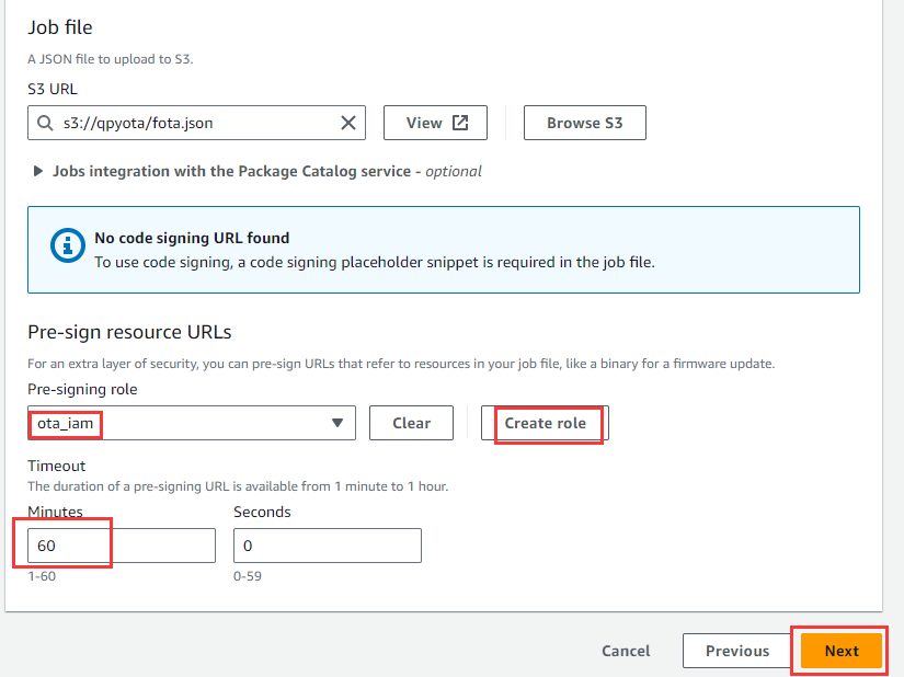

After entering the job name and description in step 1, proceed to step 2 for file configuration:
a. Choose the target items for the job. You can select specific items like QuecPython_OTA or choose item groups containing multiple devices. These items should have been created beforehand.
b. Next, select the job description document, which is the previously uploaded fota.json file in the S3 storage bucket.
c. Afterward, create an IAM role for the pre-signed URL. The purpose of this pre-signed URL is to generate a time-limited upgrade package file URL for device downloading. Due to security restrictions, devices cannot directly download the upgrade package file from the S3 storage bucket. Here, the URL is set to be valid for 60 minutes.

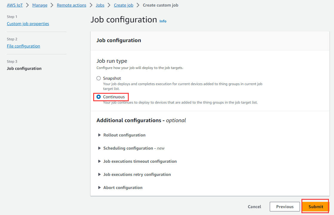

After completing the above, proceed to step 3 for job configuration.

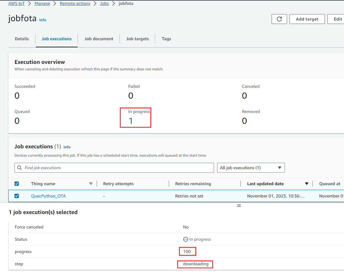

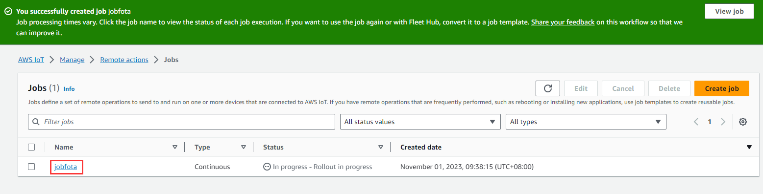

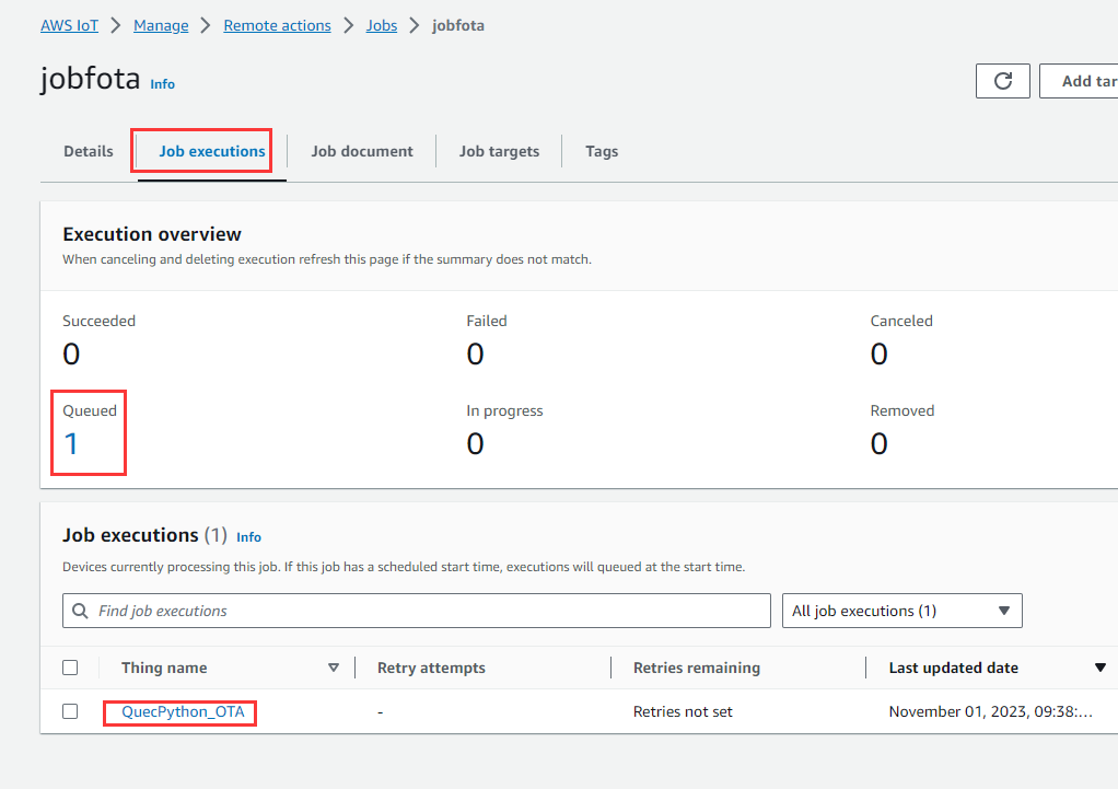

Choose job run type and click submit button to complete the job creation. The jobfota is the created job.

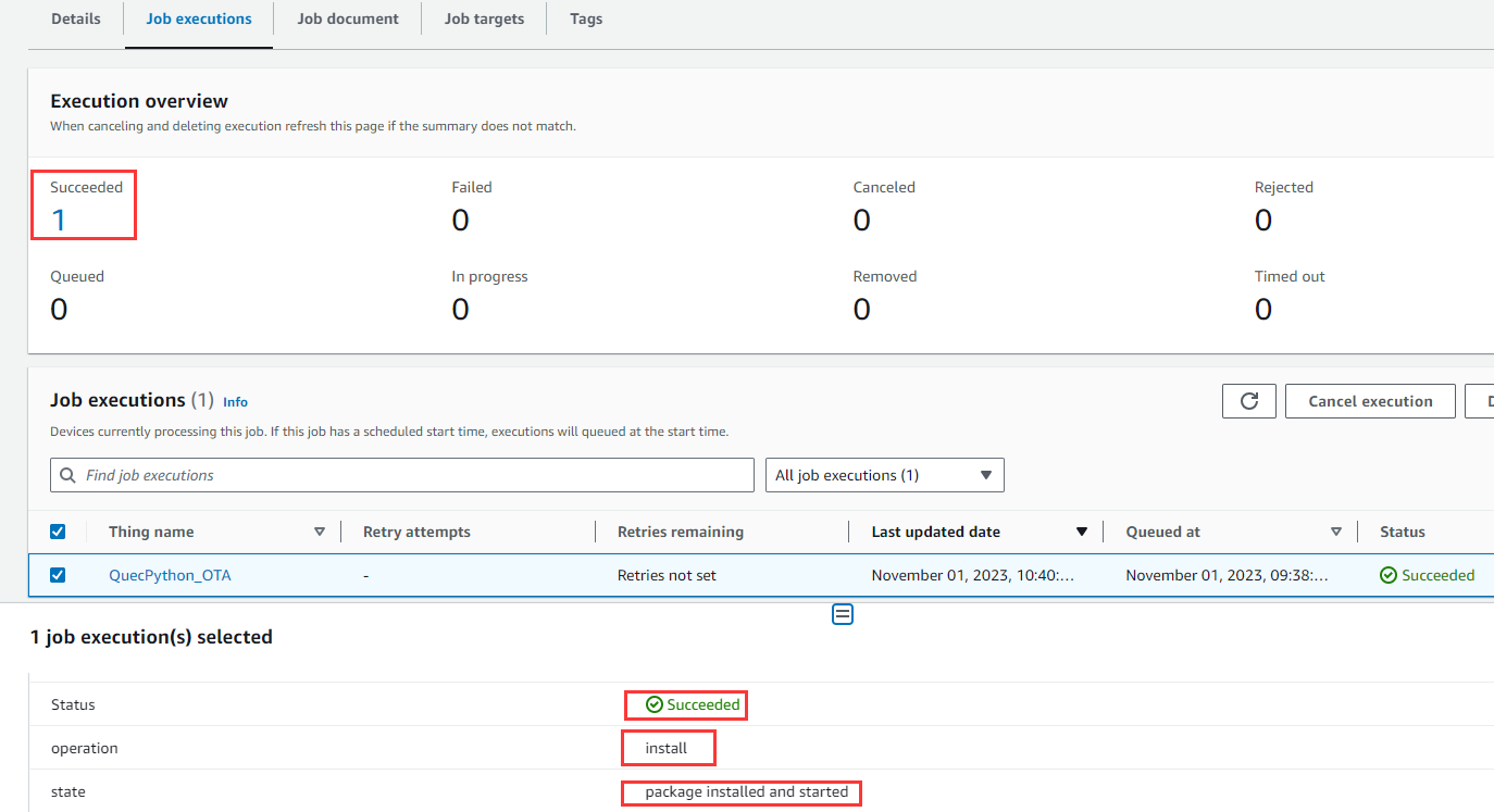

Clicking on the jobfota allows you to view job details. The Job executions page displays the status of the upgrade job, with one item, QuecPython_OTA, currently queued and waiting for the upgrade job to be executed. The Job document page provides details of the current upgrade job, such as the upgrade mode being "FOTA," the upgrade package name being "EG915UEUAB_V0002-V0003.pack," the target version to upgrade to being "EG915UEUABR03A21M08_OCPU_QPY," and the URL of the upgrade package file.
  1. Run the upgrade program on the device, wait for the device to upgrade, and check the upgrade result.
After completing the download, report the download result.
Reporting a successful upgrade after completion and reboot.

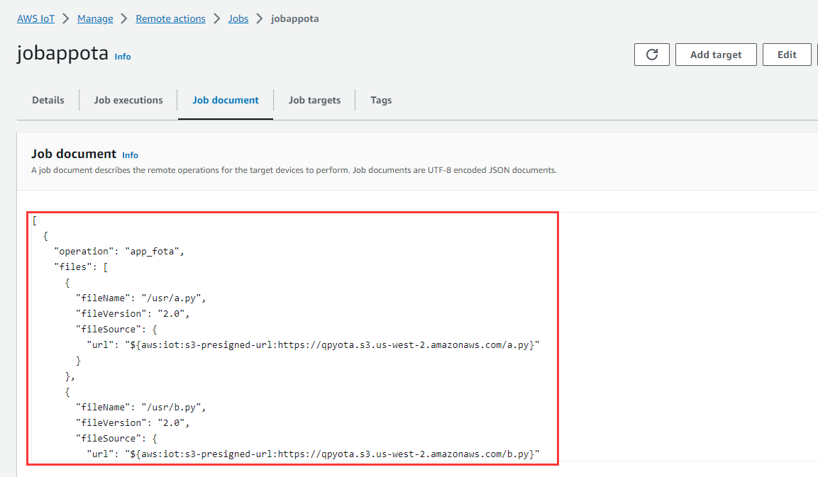

  1. Upload the upgrade package files and OTA task description document to the S3 storage bucket. Click the upload button in the figure below to perform the upload. In the figure below, a.py and b.py are target Python script files for app_fota upgrade, and app_fota.json is the description document for the app_fota upgrade task.
The format of the upgrade task description document is as follows:
     "operation":"app_fota",
     "files":[
           "fileName":"/usr/a.py",
    	   "fileVersion": "2.0",
           "fileSource":{
    		  "url":"${aws:iot:s3-presigned-url:https://qpyota.s3.us-west-2.amazonaws.com/a.py}"
           "fileName":"/usr/b.py",
           "fileSource":{
    		  "url":"${aws:iot:s3-presigned-url:https://qpyota.s3.us-west-2.amazonaws.com/b.py}"

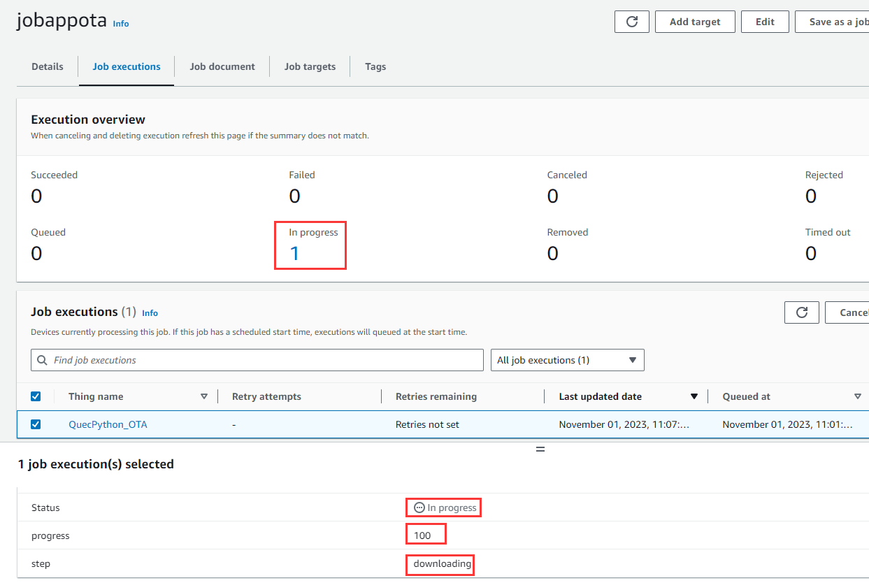

  1. Create an OTA Upgrade Job
The specific steps are the same as those for firmware upgrade job creation. The only difference is the selection of the task description document. Choose the app_fota.json file that was uploaded earlier for the app upgrade.

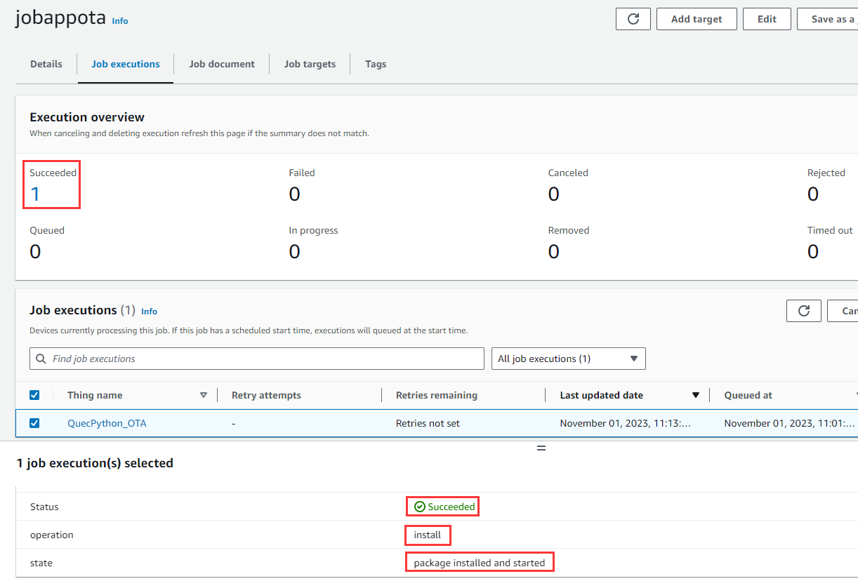

Report the upgrade results after completion and reboot.

            _fota = fota()
            ret = _fota.httpDownload(url1=receive_data["execution"]["jobDocument"][0]["files"][0]["fileSource"]["url"], callback=fota_callback)
            if ret == 0:
                print("fota download completely", ret)
            else:
                status = "FAILED"
                print("fota FAILED", ret)
                process_data = {"status": status,"statusDetails":{"progress":100}}
                aws_obj.publish("$aws/things/QuecPython_OTA/jobs/jobfota/update", process_data)
    elif operation == "app_fota":
        # app_fota
        if version == APP_VERSION:
            print("app_fota SUCCEEDED")
            process_data = {"status": "SUCCEEDED","statusDetails":{"operation": 'install', "state": 'package installed and started'}}
            aws_obj.publish("$aws/things/QuecPython_OTA/jobs/jobappota/update", process_data)
        else:
            print("start app_fota")
            _app_fota = app_fota.new()
            ota_data = [{"url": i["fileSource"]["url"], "file_name": i["fileName"]} for i in receive_data["execution"]["jobDocument"][0]["files"]]
            res = _app_fota.bulk_download(ota_data)
            ota_process = 100 if not res else -1
            if ota_process == 100:
                _app_fota.set_update_flag()
                print("app_fota download completely")
                process_data = {"status": "IN_PROGRESS","statusDetails":{"progress":ota_process, "step":"downloading"}}
                utime.sleep(5)
                # restart device
                Power.powerRestart()
            else:
                status = "FAILED"
                print("app_fota FAILED", res)
# create aws obj
aws_obj = Aws(client_id, user, pwd, server, port, keep_alive=60,ssl=True,ssl_params={"cert": certificate_content,"key": private_content})
print("create aws obj")
# register callback
aws_obj.set_callback(event_callback)
print("aws set callback")
# connect mqtt server
print("aws connect start")
aws_obj.connect()
print("aws connect end")
# subscribe jobs topic
aws_obj.subscribe("$aws/things/QuecPython_OTA/jobs/notify")
aws_obj.subscribe("$aws/things/QuecPython_OTA/jobs/get/accepted")
# start
aws_obj.loop_forever()
print("aws loop_forever")
# get ota jobs
utime.sleep(5)
a = {"key":0}
aws_obj.publish("$aws/things/QuecPython_OTA/jobs/get", a)
utime.sleep(5)
aws_obj.publish("$aws/things/QuecPython_OTA/jobs/jobfota/get", a)
utime.sleep(5)
aws_obj.publish("$aws/things/QuecPython_OTA/jobs/jobappota/get", a)
