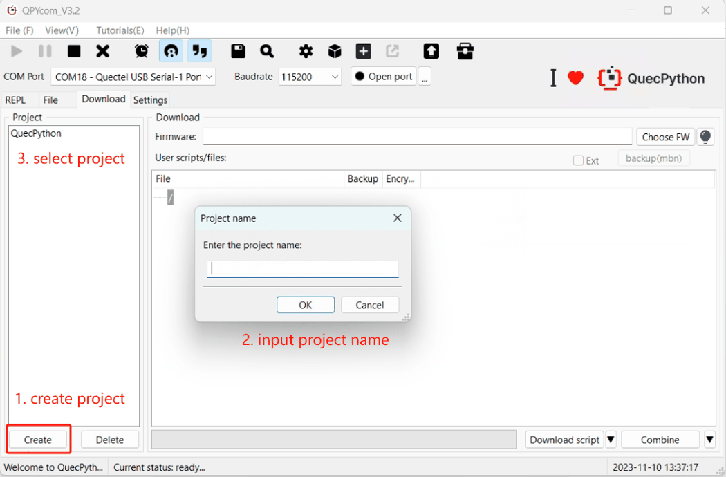

Downloading Process
The firmware downloading process of QPYcom is shown in the following figure. Click here for detailed instructions.
