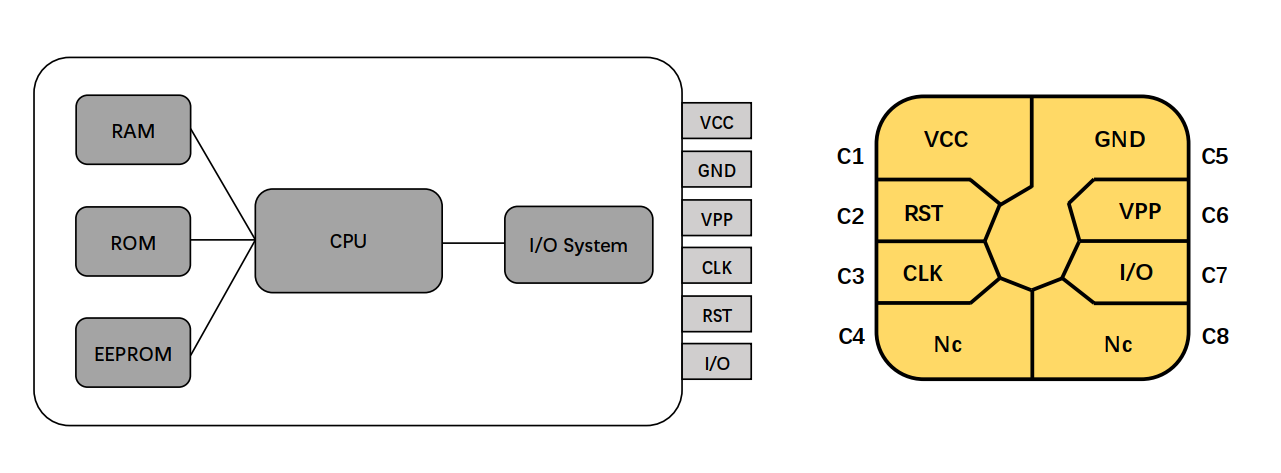

Hardware Structure
The SIM card is actually a chip card with a microprocessor. It is designed according to the ISO 7816 standard and is divided into five parts according to the functional modules:
Microprocessor (CPU)
This is the core part of the SIM card, responsible for processing all calculations and logical operations, such as executing encryption algorithms, processing input/output data, etc.
Program Memory (ROM)
Stores the fixed information of the SIM card, such as the operating system and pre-installed applications. Once written, this information cannot be changed.
Working Memory (RAM)
Stores temporary data during complex calculations or task processing.
Data Memory (EEPROM)
A writable and readable storage space for storing variable information such as phonebooks, text messages, and user authentication keys. We often see "xxxk" marked on the SIM card, indicating the size of this storage area. For example, 128K means the size of the EEPROM storage area is 128K.
Serial Communication Unit
The only channel for the communication between the SIM card and the Mobile Equipment (ME), supporting half-duplex serial communication mode.
The hardware architecture is roughly as follows:
SIM Card Electrical Contacts
The contact allocation of the SIM card follows the ISO 7816-2 protocol, as follows:
| Contact | Description | Contact | Description |
| C1 | Power Voltage | C5 | Ground |
| C2 | Reset | C6 | Programming Voltage |
| C3 | Clock | C7 | Input/Output |
| C4 | Reserved | C8 | Reserved |
Generally, SIM cards have 8 contacts. During use, at least 5 contacts need to be connected to the device to ensure the normal operation of the SIM card. These 5 contacts are: VCC, GND, RST, CLK, and I/O.
- C1 Contact: Power Voltage (VCC), available in 1.2V/1.8V/3V/5V specifications. SIM cards powered by 5V are rarely used now. The main power supply for SIM cards is 1.8V and 3V.
- C2 Contact: Reset Signal (RST).
- C3 Contact: Clock Signal (CLK), with a frequency of 1~5MHz, provided by the terminal equipment. CLK should be maintained within ±10% of the frequency used during the reset response.
- C4 Contact: Reserved.
- C5 Contact: Ground (GND).
- C6 Contact: Programming Voltage (VPP), can be used as a power supply pin in SIM cards powered by 5V. In 1.8V and 3V SIM cards, this pin is usually left floating.
- C7 Contact: Data (I/O), the only communication channel between the SIM card and the terminal equipment, supporting half-duplex serial communication with two states: sending and receiving.
- C8 Contact: Reserved.
