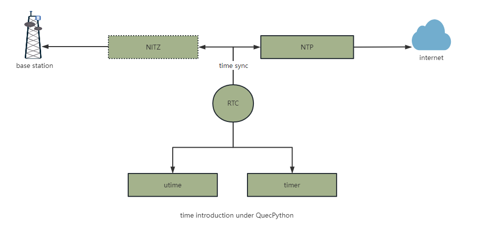

In most systems, time is an essential part. QuecPython devices have several time-related features, including the Real-Time Clock (RTC) module, the utime module, the timer module, and the Network Identity and Time Zone (NITZ) module and Network Time Protocol (NTP) module for time synchronization.
The application of QuecPython device time functions is shown in the following diagram:

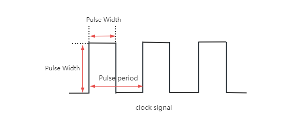

Principle
The system tick is generally generated by a crystal oscillator, which triggers an electrical signal at a precise and fixed time interval. Each tick represents the processing of data by the device. For example, if a crystal oscillator has a frequency of 12 MHz, it generates 12,000,000 pulses per second, so the time for each pulse is the clock cycle, which is 1/12 microseconds. It is also called the system clock cycle, which is the smallest and most basic time unit in a computer.

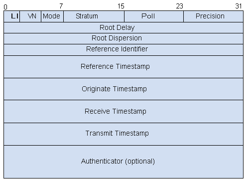

NTP (Network Time Protocol) is a time synchronization protocol defined by RFC 1305. It is used for time synchronization between distributed time servers and clients. NTP uses UDP packets for transmission and uses UDP port number 123.
The packet format is shown in the following figure. Based on the content of the protocol packet, we can compare the reported time with the server time and calculate the link transmission time to calibrate the current device to keep it consistent with the server time. For all usages of NTP on QuecPython devices, refer to the ntptime - Network Time Protocolsection.
