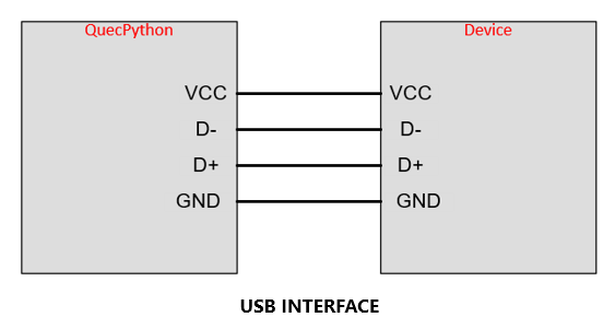

USBNET Hardware Structure
Pin Description
VCC Provides power to the connected USB device
D- Negative data line
D+ Positive data line
GND Provides circuit ground

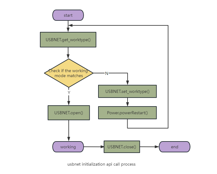

Initialization Process
The initialization and loading process of the network adapter is shown in the following figure:

USB network adapters support the ECM/RNDIS protocols. Currently, two types can be selected: Type_ECM and Type_RNDIS. The configuration should be based on the environment you are using.
USBNET.set_worktype(USBNET.Type_RNDIS)
Query USB Network Adapter Operating Mode
This interface determines the operating mode of the adapter and performs corresponding operations in complex situations. It can also be used for debugging to check if the actual mode matches the expected mode.
USBNET.get_worktype()

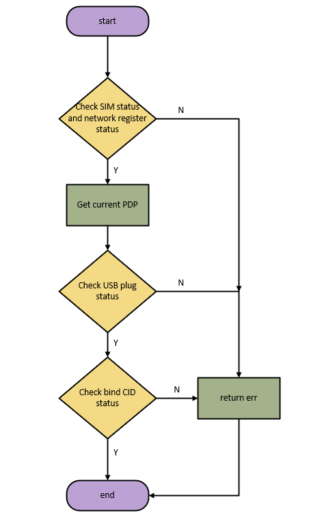

Query USB Network Adapter Operating Status
Querying the operating status of the USB network adapter is useful for handling various exceptions and for debugging.
USBNET.get_status()
