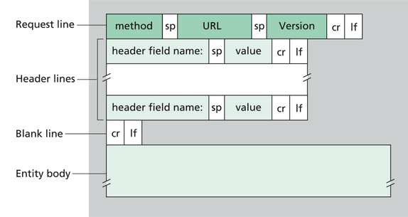

The format of an HTTP request message is as follows:
Request line: The request line, which consists of themethod,URL, andVersionfields.method: The request method, including GET, POST, PUT, HEAD and DELETE. See below for more details.URL: The Uniform Resource Locator, used to identify the path of the server resource.Version: The protocol version. The commonly used version isHTTP/1.1.
Header lines: The request header, which consists of one or more header fields, each in the format ofheader field name: value.header field name: The name of the header field.value: The value of the header field.
Entity body: The message body, which contains the message content sent to the server.
Note that
sprepresents a space,crlfrepresents a carriage return and line feed. There must be a blank line between the request headers and the message body, i.e. theBlank linein the figure.

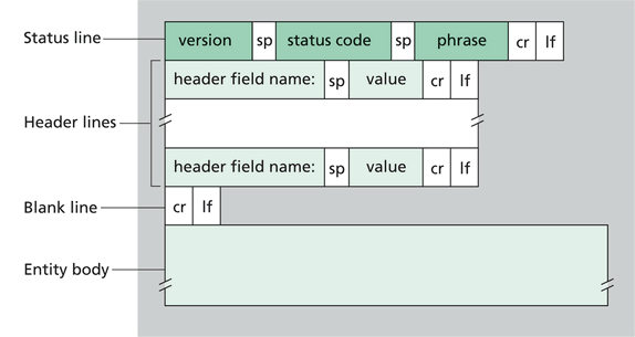

The format of an HTTP response message is as follows:
Status line: The status line, which consists of theversion,status code, andphrasefields.version: The protocol version. The commonly used version isHTTP/1.1.status code: The response status code. See below for more details.phrase: The reason phrase.
Header lines: The response header, which consists of one or more header fields, each in the format ofheader field name: value.header field name: The name of the header field.value: The value of the header field.
Entity body: The message body, which contains the content of the server's response.
Note that
sprepresents a space,crlfrepresents a carriage return and line feed. There must be a blank line between the response headers and the message body, as shown in the diagram.
Here is an example of a response message:
