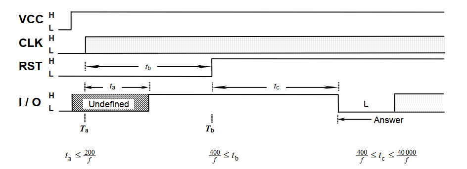

Activation and Cold Reset
The timing for activation and cold reset is as follows:
The RST pin is in a low-level state.
VCC starts to supply power.
CLK needs to provide an appropriate and stable clock.
The ME's I/O should be in a receiving state, and during the SIM card activation period, the ME should ignore the status on the I/O. This is because the I/O status of the SIM card is indeterminate during the period from SIM card activation to cold reset.
The ME sets RST to a high level and waits for the ATR response from the SIM card on the I/O.
The timing after Ta in the above figure represents the cold reset timing.

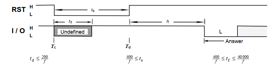

Warm Reset
After the SIM card is activated, without powering off the SIM card, a reset initiated by the ME to the SIM card is called a warm reset. The timing diagram is as follows:
According to the ISO7816-4 standard, if a warm reset is initiated while the SIM card is in the process of answer to the reset (ATR), it may damage the SIM card and cause problems. Therefore, it is usually necessary to wait for the completion of answering to the reset before performing the next reset operation.

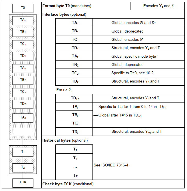

ATR
After the reset, the SIM card returns a response called Answer To Reset (ATR), which contains some basic information about the SIM card, such as supported protocols and voltage levels.
ATR consists of up to 32 bytes (excluding the start character TS), and its structure is shown in the following figure:
For detailed explanations of each character in the ATR response frame, please refer to the ISO 7816-4 standard document.

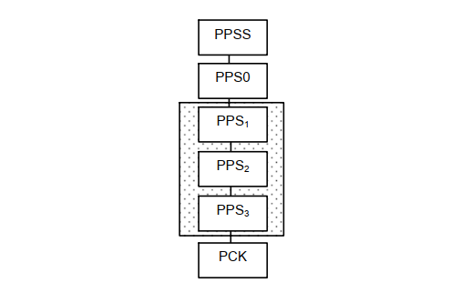

PPS
PPS, short for Protocol and Parameters Selection, is a process of selecting and setting communication protocols and parameters. The main goal of PPS is to select the optimal protocol and parameters based on the capabilities of the card and the device, in order to achieve the highest communication speed and efficiency.
In the SIM card initialization process, after the device receives the ATR from the SIM card, the PPS process can begin. The ATR contains the protocols and parameters supported by the SIM card. The device will select the optimal protocol and parameters based on this information and its own capabilities.
The basic process of PPS is as follows:
PPS Request: The device sends a PPS request to the SIM card, which includes the protocols and parameters selected by the device.
PPS Response: After receiving the request, the SIM card returns a PPS response. The response contains the protocols and parameters accepted by the SIM card.
Confirmation: After receiving the response, the device confirms the selection of protocols and parameters, and performs subsequent communication according to these protocols and parameters.
The structure of PPS request and response consists of an initial byte PPSS, a format byte PPS0, three optional parameter bytes PPS1, PPS2, PPS3, and a check byte PCK. The details are as follows:
