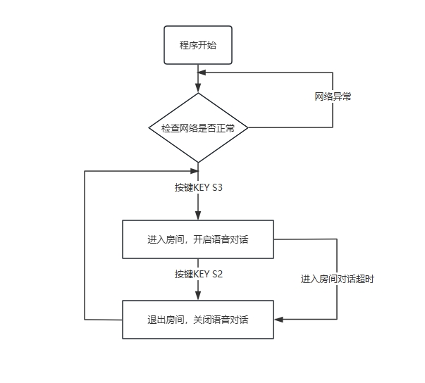

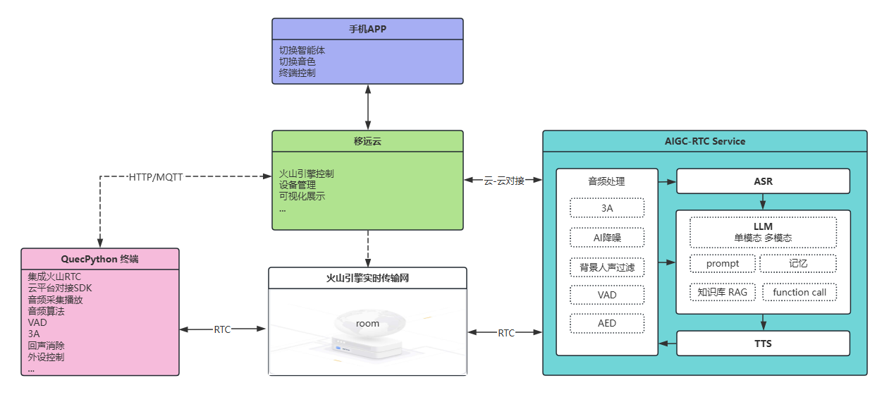

Software design
Software framework
Framework design diagram
Business system startup process

AI Init
Initialize AI objects, register callback interfaces, and configure AI conversation times.
tiktok = TiktokRTC(300000, ai_callback)
Reference operation log
import example
>>> example.exec('/usr/ai_main.py')
volume: 11
>>> lte network normal
ai task running
AI enter room
push down KEY S3 to enter room, start communicate, call tiktok.active(True) to active.
tiktok.active(True)
# push KEY S3 to enter
rtc_queue key event 1
start rtc
TIKTOK_RTC_EVENT_START
TIKTOK_RTC_EVENT_TTS_TEXT 你
TIKTOK_RTC_EVENT_TTS_TEXT 你好
TIKTOK_RTC_EVENT_TTS_TEXT 你好有
TIKTOK_RTC_EVENT_TTS_TEXT 你好有什
TIKTOK_RTC_EVENT_TTS_TEXT 你好有什么
TIKTOK_RTC_EVENT_TTS_TEXT 你好有什么可
TIKTOK_RTC_EVENT_TTS_TEXT 你好有什么可以
TIKTOK_RTC_EVENT_TTS_TEXT 你好有什么可以帮
TIKTOK_RTC_EVENT_TTS_TEXT 你好有什么可以帮到
TIKTOK_RTC_EVENT_TTS_TEXT 你好有什么可以帮到你
TIKTOK_RTC_EVENT_TTS_TEXT 你好有什么可以帮到你的
TIKTOK_RTC_EVENT_TTS_TEXT 你好有什么可以帮到你的吗
AI exit room
push down KEY S2 to exit room, stop communicate, call `tiktok.active(False) to deactive。
# push KEY S2 to exit
rtc_queue key event 2
stop rtc
TIKTOK_RTC_EVENT_STOP
