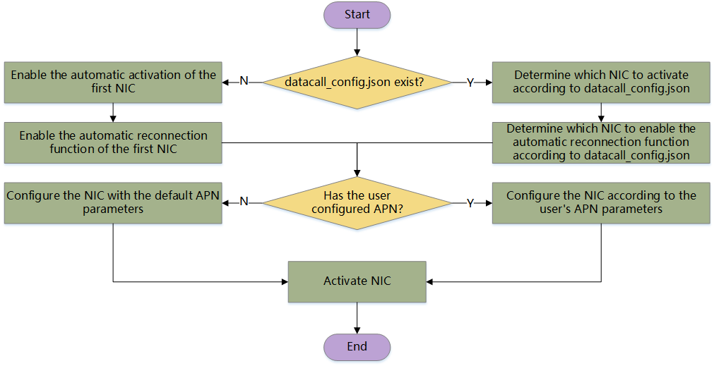

The following diagram shows the process of automatic activation of the QuecPython cellular NIC at startup. In general, it can be divided into three stages:
Stage 1: Determine which cellular NIC(s) to enable automatic activation and automatic reconnection based on the existence of the
datacall_config.jsonfile.Stage 2: Determine which parameters to use for the activation of the cellular NIC based on whether you have configured APN and other NIC parameters.
Stage 3: The previous two stages mainly involve parameter configuration, and this stage involves the actual activation of the NIC.
The following will introduce the various processing mechanisms of the QuecPython cellular NIC based on the above flowchart for details.
Automatic Activation
Automatic activation of the cellular NIC at startup refers to that after the module is powered on, the system automatically activates the cellular NIC when the module has registered on the network successfully.
Based on the flowchart above, you can see that the system will first determine which cellular NIC(s) to activate according to whether the datacall_config.json file exists. There are two processing mechanisms:
If the
datacall_config.jsonfile does not exist, the system will activate the first cellular NIC.If the
datacall_config.jsonfile exists, the system will determine which cellular NIC(s) to activate at startup according to the configuration in the file.
After the system determines which cellular NIC(s) to activate, before activating the NIC, the system will further confirm whether you have configured APN and other parameters for the corresponding cellular NIC. There are two processing mechanisms:
- If you have not configured APN and other parameters, the default parameters will be used for the activation of the cellular NIC. The default parameter configuration is as follows:
| Parameter | Default Value | Description |
| ipType | 0 | IPv4 protocol. |
| apn | "" | No APN. |
| username | "" | No username. |
| password | "" | No password. |
| authType | 0 | No encryption. |
If you use the default parameter configuration for the NIC activation, the activation may fail. You are recommended to configure the correct APN parameters according to the actual situation.
- If you have configured APN and other parameters, the configured APN parameters will be used for the activation of the cellular NIC.

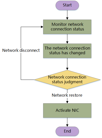

Automatic Reconnection
Automatic reconnection of the cellular NIC refers to the process where the module re-registers on the network and reactivates the cellular NIC after the exceptions are handled if the connection between the module and the network is closed due to some exceptions (such as network anomalies, environmental interference, and poor signal).
Based on the flowchart above, you can see that the system will first determine to enable the automatic reconnection of which cellular NIC(s) according to whether the datacall_config.json file exists. There are two processing mechanisms:
If the
datacall_config.jsonfile does not exist, the system will enable the automatic reconnection of the first cellular NIC.If the
datacall_config.jsonfile exists, the system will enable the automatic reconnection of cellular NIC(s) according to the configuration in the file.
The basic working principle of the automatic reconnection mechanism of the cellular NIC is as follows:
The system will monitor the connection status between the device and the cellular network. When the network is disconnected and the factors causing the network exception disappear, the device will automatically initiate the attach procedure to re-register on the network. Once the registration is successful, the system will reactivate the NIC based on the parameters configured before.
Some common reasons that may cause the device's network disconnection are listed below:
The device is in an environment with poor signal, which may easily cause the device's network to be disconnected, such as in a tunnel.
The environment where the device is located has co-frequency interference or other interference, which affects the normal communication between the device and the base station, and may also cause the device's network disconnection.
The cell that the device is connected to may become overloaded when there are too many devices connected to it, which may cause the device's network disconnection.
An abnormality in the wireless network may cause the device's network disconnection.

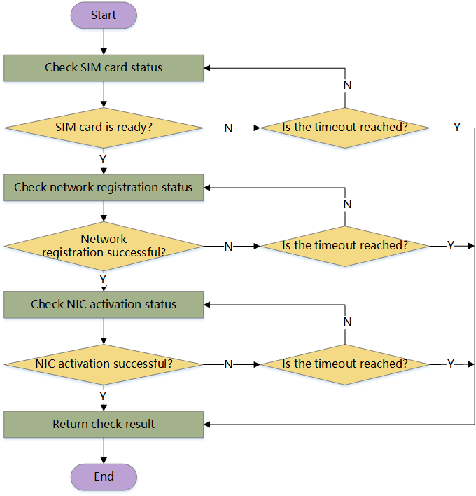

checkNet Mechanism Description
The process of checking whether the network is ready by using checkNet is shown in the following figure. It is divided into three stages:
Stage 1: First, check the SIM card status to confirm whether the SIM card is ready. If the SIM card is ready, proceed to the next stage; otherwise, wait for the SIM card to be ready until the timeout is reached before returning.
Stage 2: Then, check the device's network registration status. If the device has successfully registered on the network, proceed to the next stage; otherwise, wait for the device to register on the network until the timeout is reached before returning.
Stage 3: Finally, check the activation status of the cellular NIC. If the cellular NIC has been activated successfully, return the check result directly; otherwise, wait for the cellular NIC to be activated until the timeout is reached before returning.

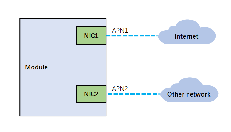

Multiple NICs
"Multiple NICs" refers to the module virtually creating multiple cellular NICs in software to meet the needs of a device simultaneously connecting to multiple networks.
Scenario
As mentioned before, APN is a required parameter when a terminal device connects to the network, and it determines the network access method for the terminal device. Different access points cover different ranges and access methods, so the APN determines how the terminal device accesses what kind of network. Can you configure multiple different APNs to allow the terminal device to simultaneously connect to different networks? The answer is yes.
Therefore, when you want your products to connect to public networks (Internet) while also access some dedicated networks, you can use multiple NICs. In this case, you need to configure different APNs for different NICs and then activate the NICs.
Description
QuecPython modules on various platforms can create multiple virtual cellular NICs. For platform uniformity, three NICs are available for you to activate and use simultaneously and these NICs do not have any special purposes. At the same time, the VoLTE feature on each platform will occupy one NIC, but the specific NIC occupied by VoLTE varies on different platforms. But it will not occupy the three NICs open to users.
For BG95 series modules, at most 2 NICs can be activated in NB-IoT networks.
