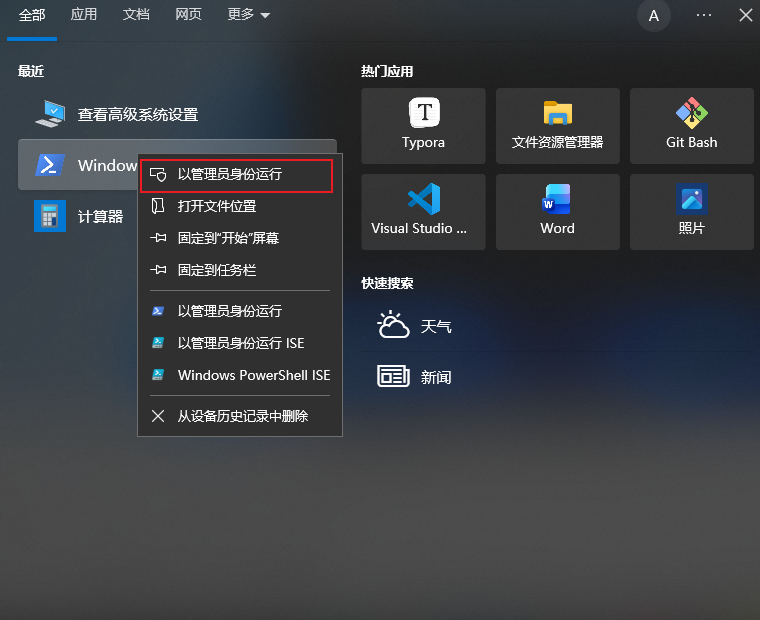

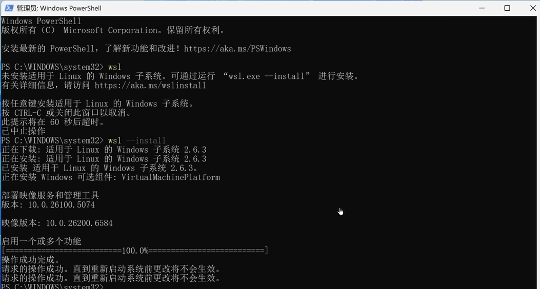

Install wsl (Windows' Linux Subsystem)
Run powershell as an administrator to prevent environment configuration issues caused by permission problems during deployment
Use the command: 'wsl.exe --install' to install. After it is installed, we need to restart the computer
After restarting the computer, we continue to open powershell as an administrator and use the command: 'wsl --install Ubuntu-24.04' to follow Ubuntu (the distribution of Linux), which is the system officially recommended by openclaw.
After setting it up, a colored command line will appear

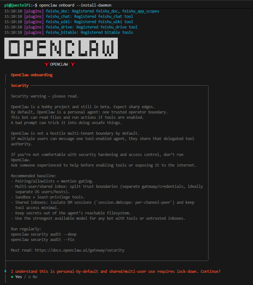

Initialize OpenClaw
After the first installation, you must complete the configuration wizard; otherwise, OpenClaw cannot run properly. Execute the following command to launch the configuration wizard and install the gateway daemon:
openclaw onboard --install-daemon
The gateway daemon (a launchd/systemd user service) ensures OpenClaw runs persistently in the background.

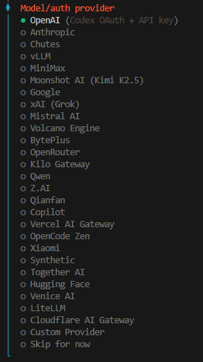

Configuration Wizard Screenshots (For Reference Only)

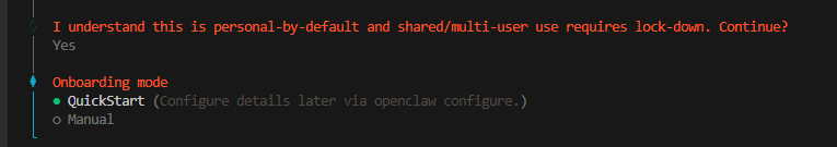

  1. Enter the installation confirmation screen, select [Yes], and press Enter;
  2. Select [QuickStart] in the [Onboarding mode] option;

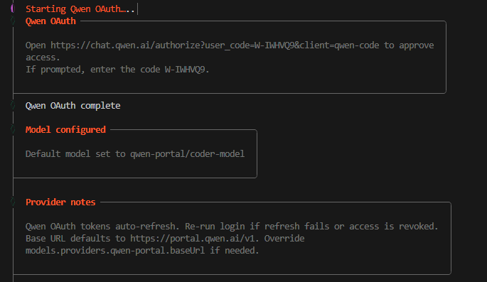

  3. Select [Qwen] in the [Model/auth provider] option and press Enter;
  4. Open the specified website to log in to the qwen-code platform and complete identity authentication;
After configuration, restart the gateway to apply the settings:
openclaw gateway restart

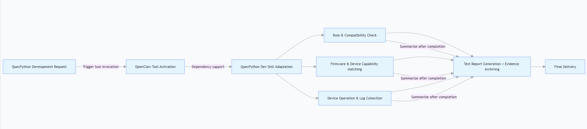

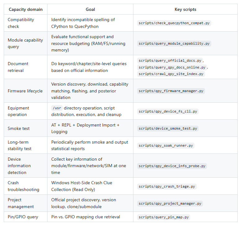

4. The practice of QuecPython-dev-skill automated development process
Tool Application Workflow:
QuecPython-Dev-Skill Core Capability Matrix
Function Demonstrations:

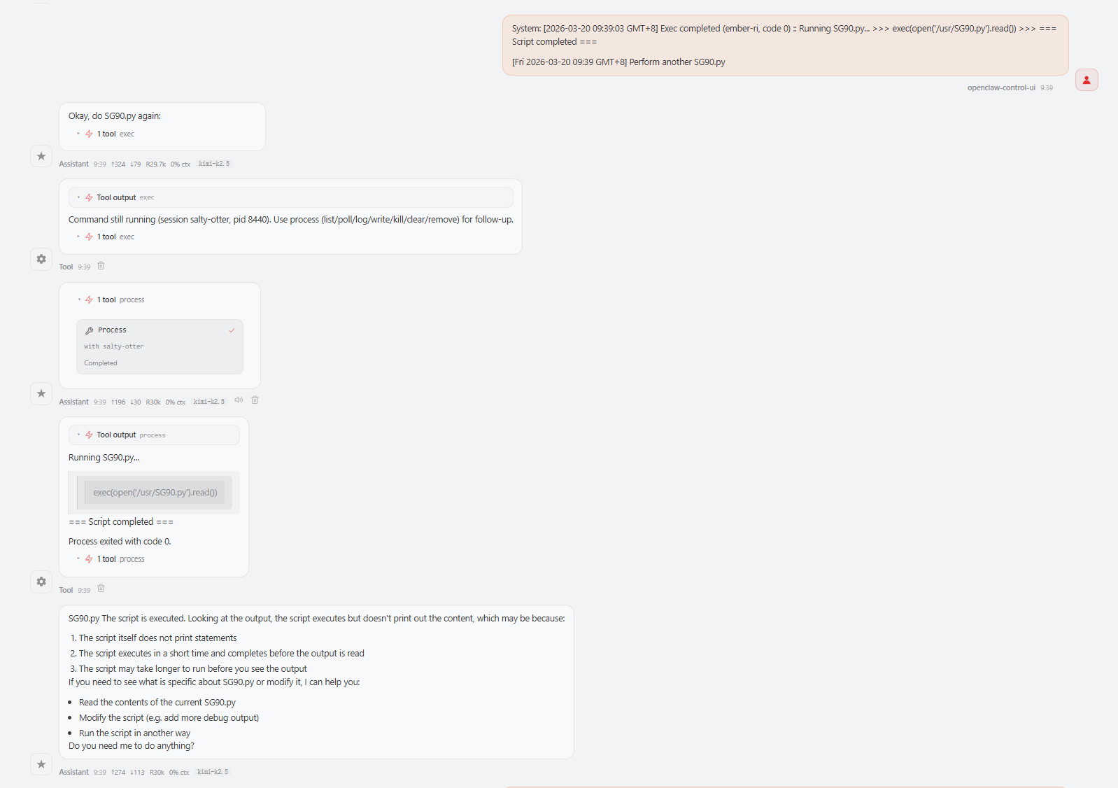

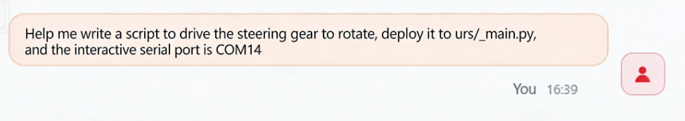

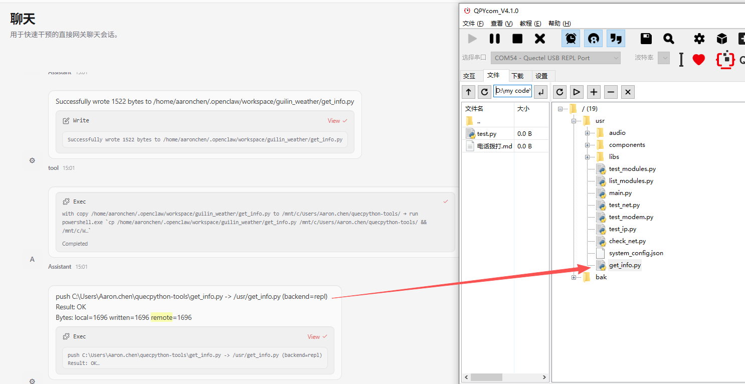

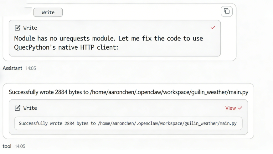

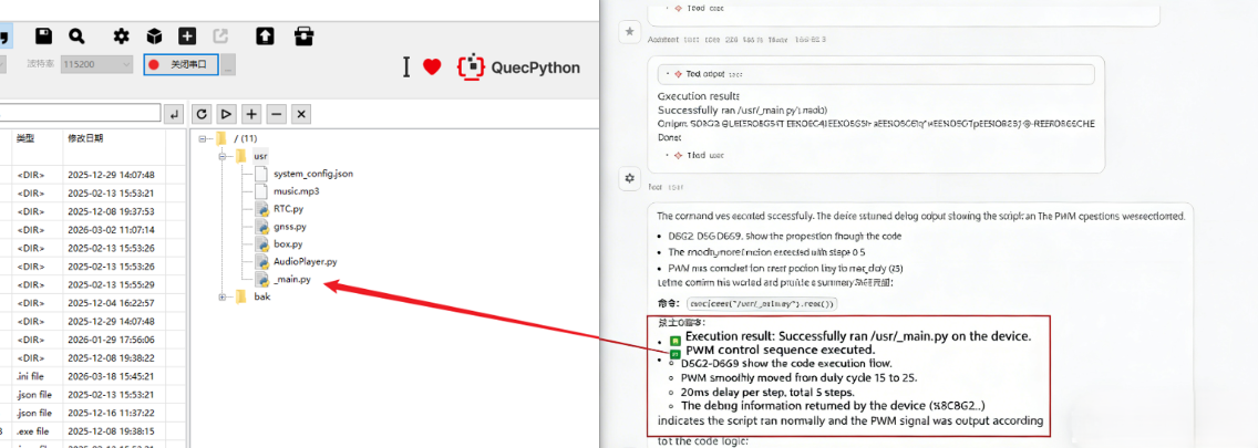

Device Operations ( /usr directory operations, script deployment, execution, and cleanup):
  1. Input requirements

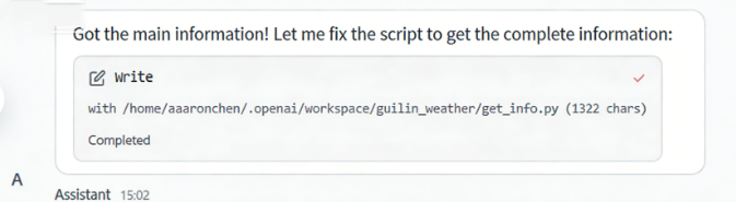

  2. OpenClaw activates the QuecPython-Dev-Skill to control qpycom on the local Windows device via SSH to download and run the script
  3. If script execution fails, OpenClaw automatically fixes script bugs

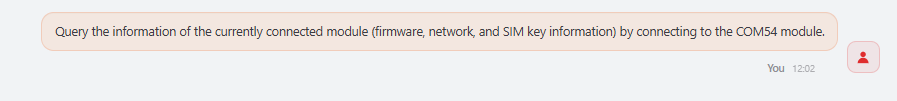

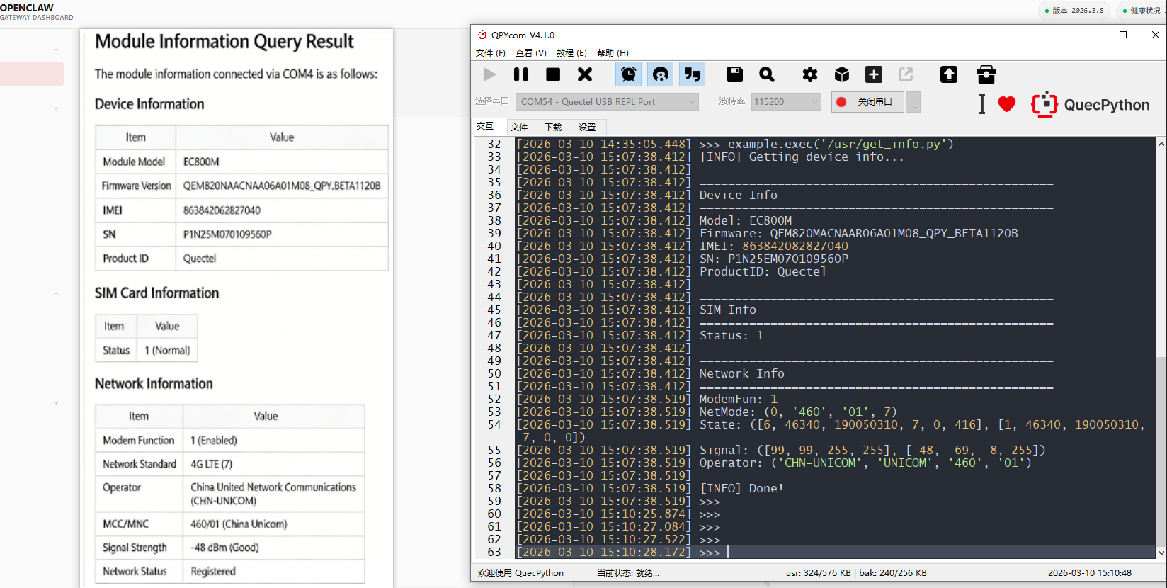

Device Information Detection:
  2. OpenClaw outputs the script → download the script
  3. Automatic script validation
  4. Output module query results

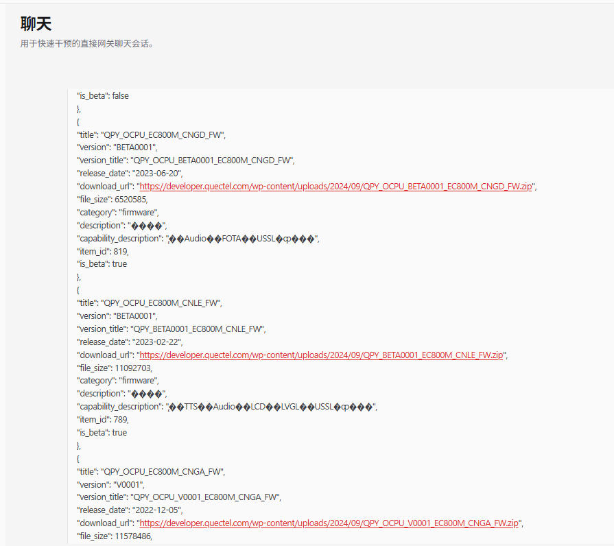

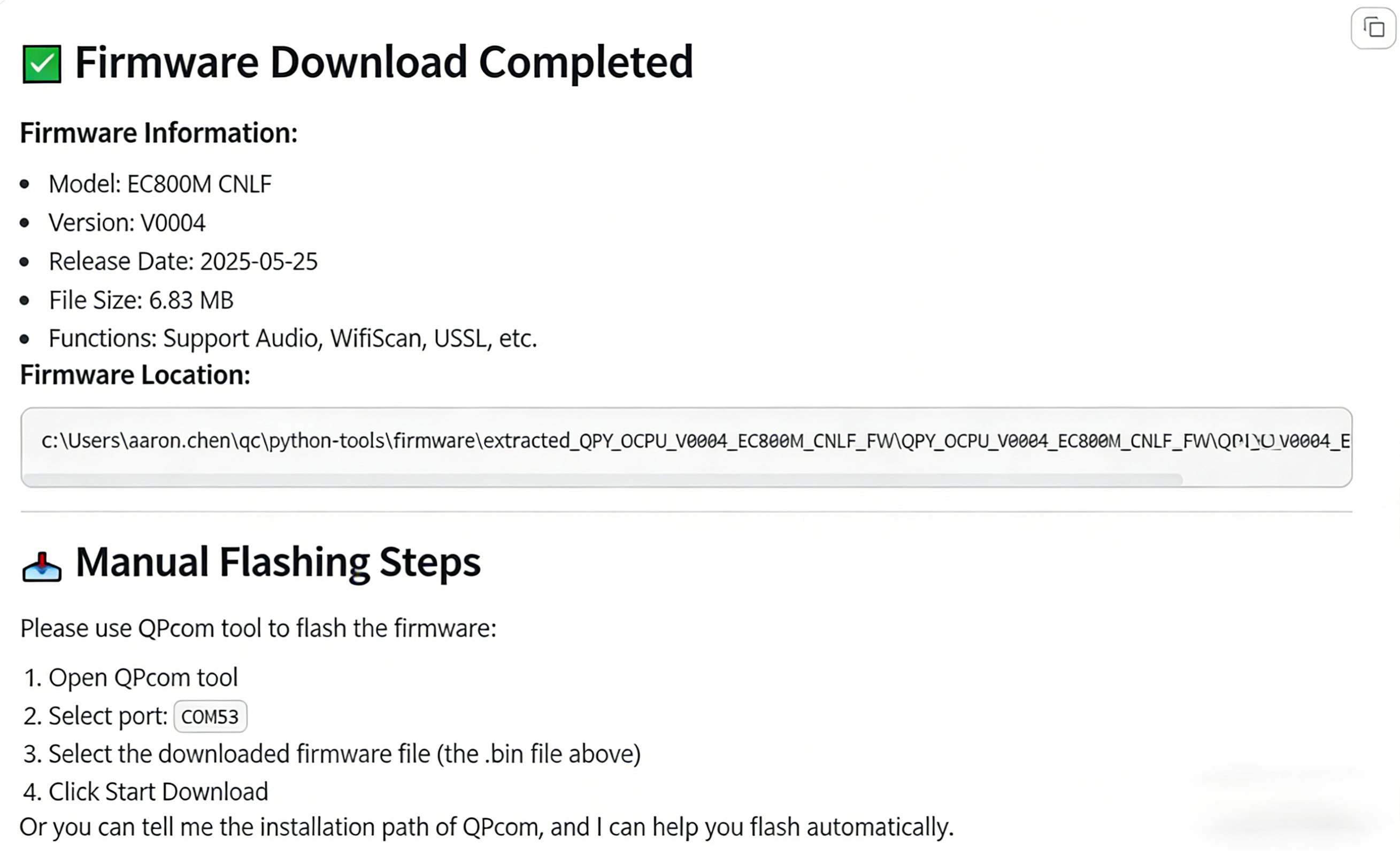

Development Resource Query:
    "Help me query and download the firmware for EC800MCNLF from the QuecPython official website to my local machine"
  2. OpenClaw filters resources
  3. Automatic resource download
