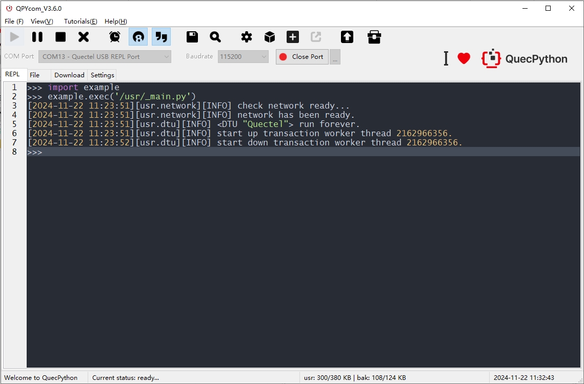

script is imported and run
Download and install the QPYCom tool and use it to download scripts to the QuecPython module.
💡 Tips
QPYCom installation and use tutorial
Service debugging
View REPL interface logs

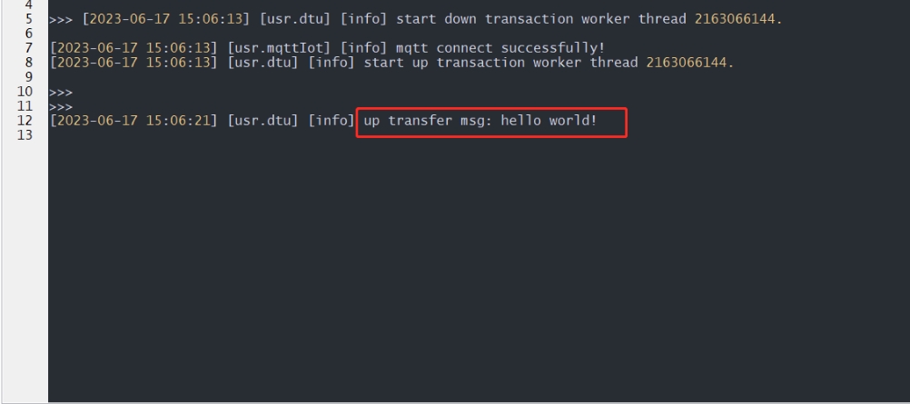

After the program is run, you can see the log output in the REPL interaction page as shown in the following figure. There are two threads in the DTU service to process data, one is used to detect and read serial port data and forward the data to the cloud, and the other is to detect the cloud downlink data to the serial port, as shown in the following figure.

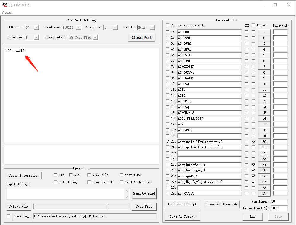

The serial debugging tool is used to simulate the mcu to send uplink data to the module.
  • In the Input String input field, type hello world!Character string.
  • Click Send Command button to send data through the serial port.
DTU receives serial data and transparently transmits it directly to the mqtt cloud.

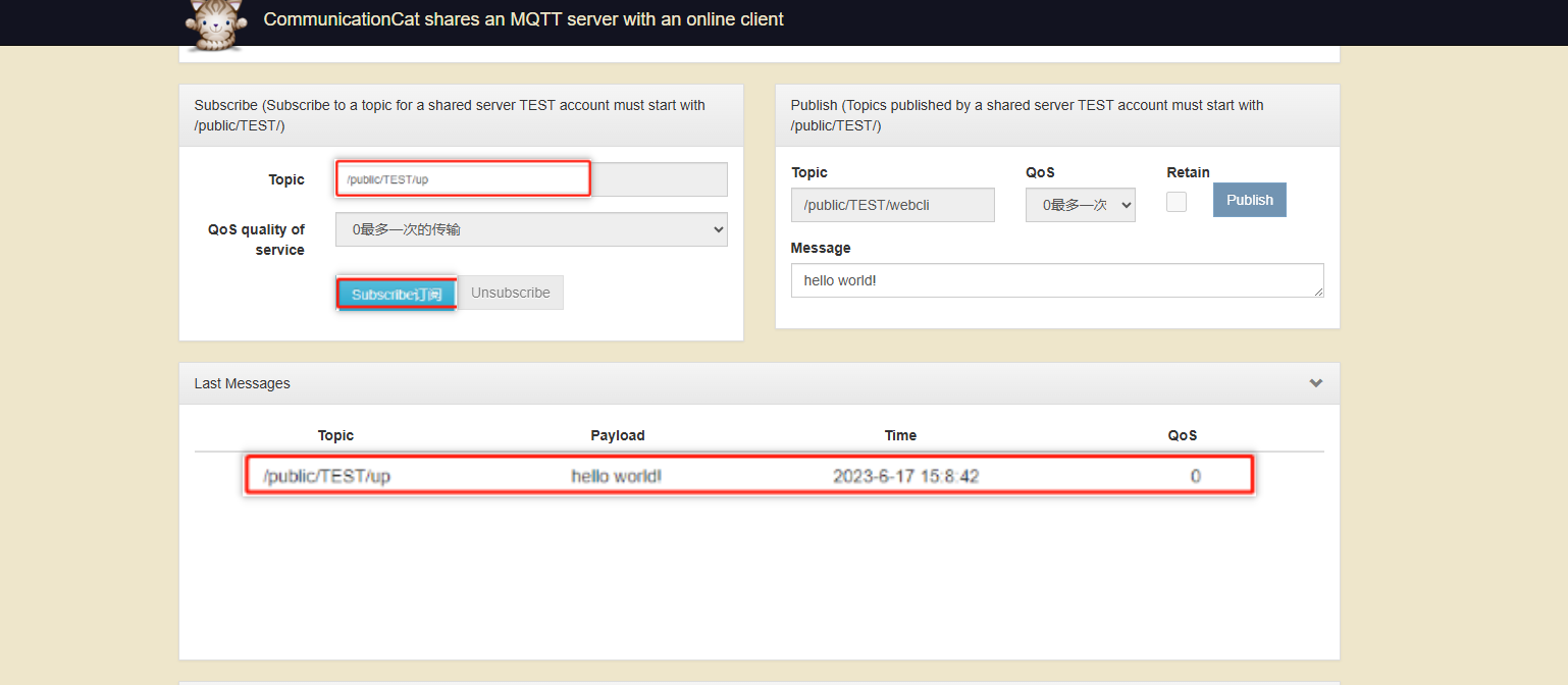

The cloud receives uplink data logs
ps:The communication cat cloud platform is only used for testing, and the cloud platform can be replaced according to actual requirements

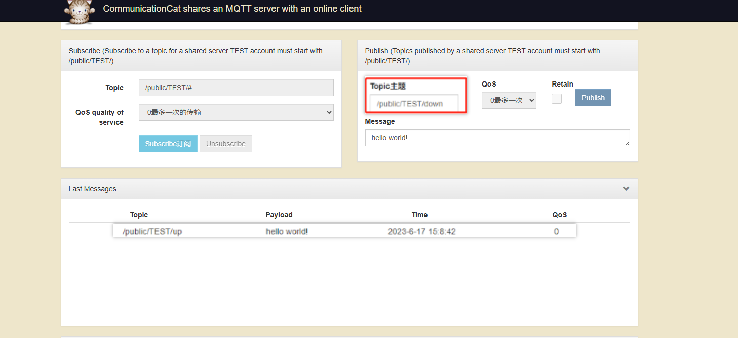

Downlink transparent data transmission
The cloud sends downlink data.
  • Set the cloud downlink data theme (the same as the subscription theme configured for the DTU application).
  • Enter downlink data.
  • publish

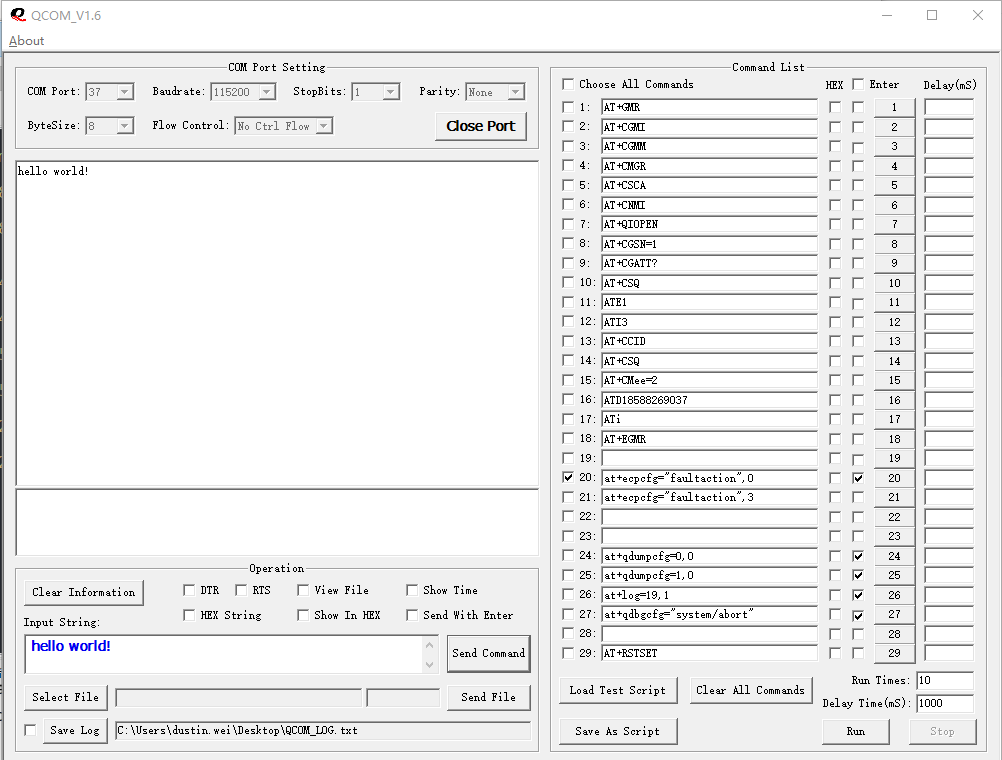

Using QCOM to observe serial debugging tool to simulate mcu receiving module downlink data.
