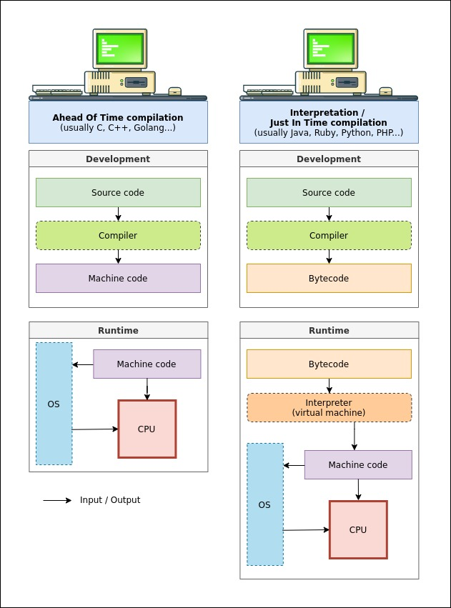

About Interpreters
An interpreter is a concept that is opposite to a compiler. As an interpreted language, Python's source code is transformed into machine-readable and executable binary form during runtime, rather than before execution. The tool that facilitates this process is called an interpreter.
For a more in-depth explanation of Python's code execution mechanism, you can refer to online resources such as "Differences and Workings of Compilers and Interpreters" and "An Introduction to Bytecode and Virtual Machines" or consult professional books on Python.

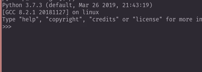

About REPL
REPL, short for Read-Eval-Print Loop, is a simple interactive programming environment. REPL typically provides a Command-Line Interface (CLI) that receives user input, parses and executes it, and then returns the results to the user. In terms of functionality and usage, it is similar to the Command Prompt (CMD) in Windows or the Shell in macOS/Linux.

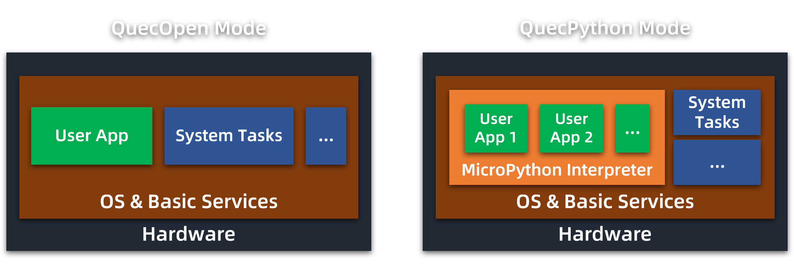

- Performance: From an architectural standpoint, QuecPython ported the MicroPython interpreter on top of the QuecOpen system as a running task. The user's scripts are parsed and executed within the MicroPython interpreter. This mechanism results in QuecPython having lower performance compared to QuecOpen.
