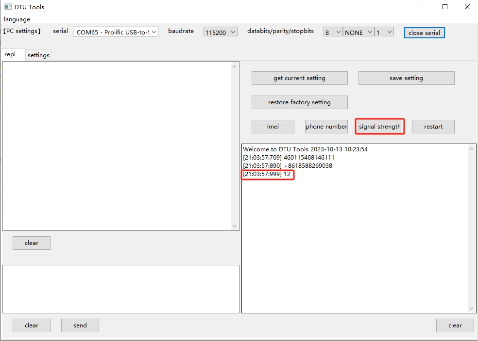

| Query IMEI Number | Get the IMEI number of the device |
| Query Phone Number | Get the phone number of the SIM card in the DTU device |
| Query Signal Strength | Get the CSQ value. Range: 0–31. A larger value indicates a stronger signal strength. |

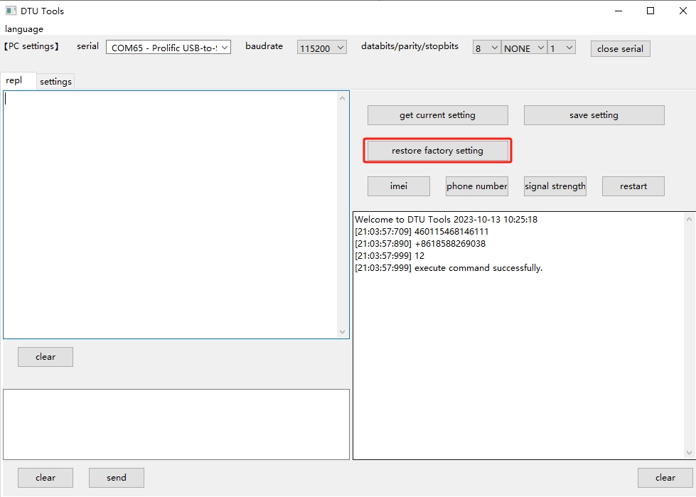

| Restore Factory Settings | Restore the factory settings and restart the DTU device |

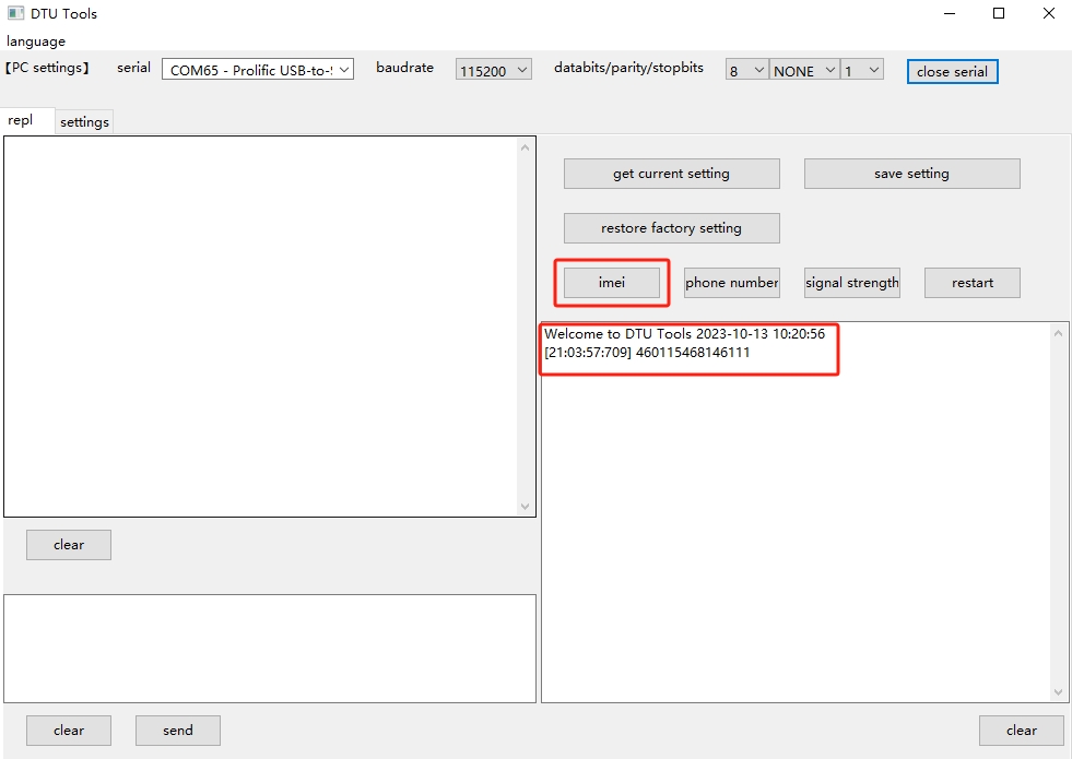

Query IMEI Number
The left serial port data display box displays the detailed serial port data in string format, and the right command box displays the queried IMEI number.

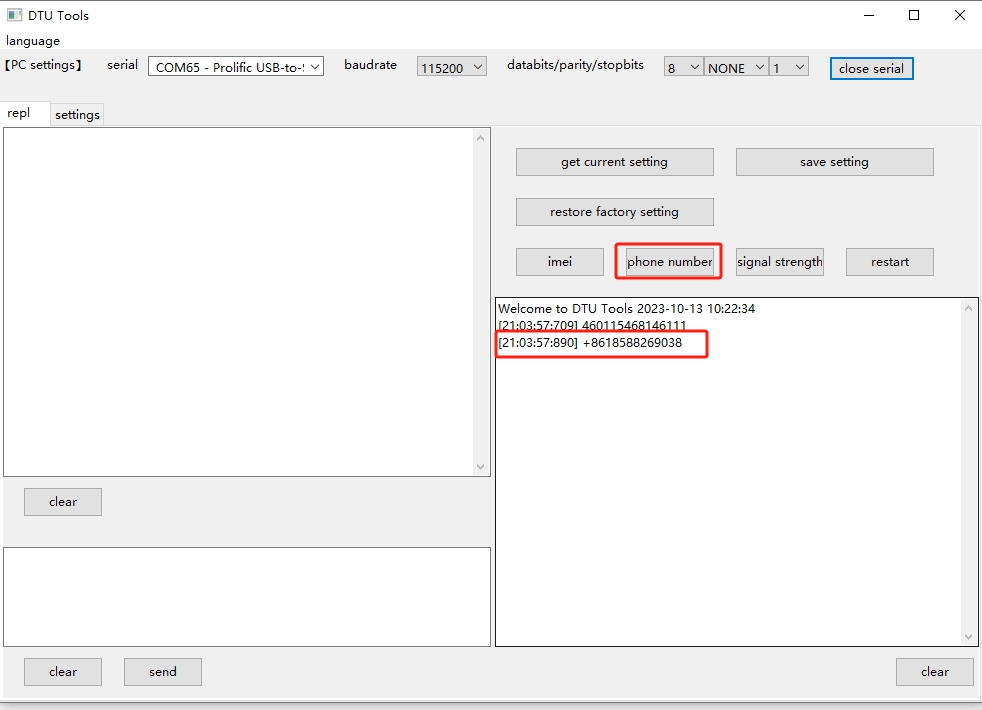

Query Phone Number

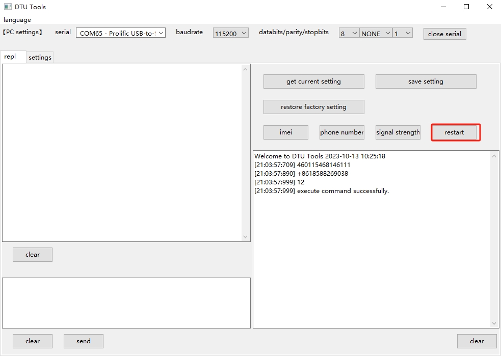

Restart Device

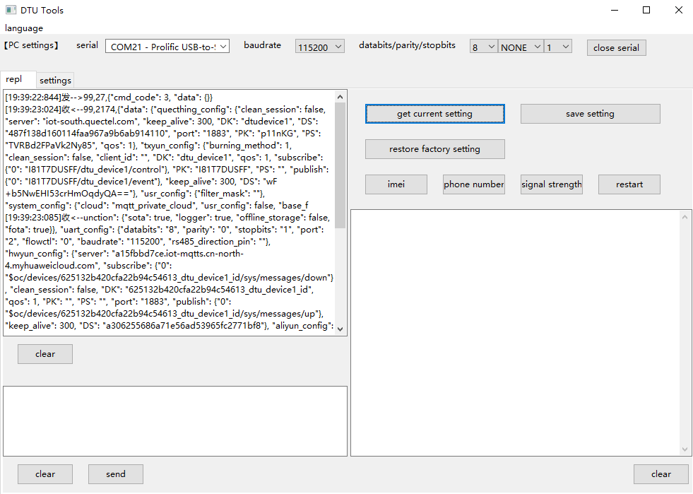

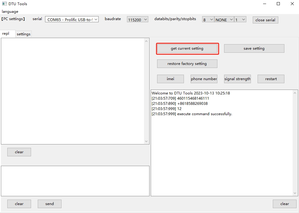

Get Current Parameter Settings
In the command box, click get current setting to request the current parameter settings of the DTU device, and the tool will redirect to the parameter setting and display page

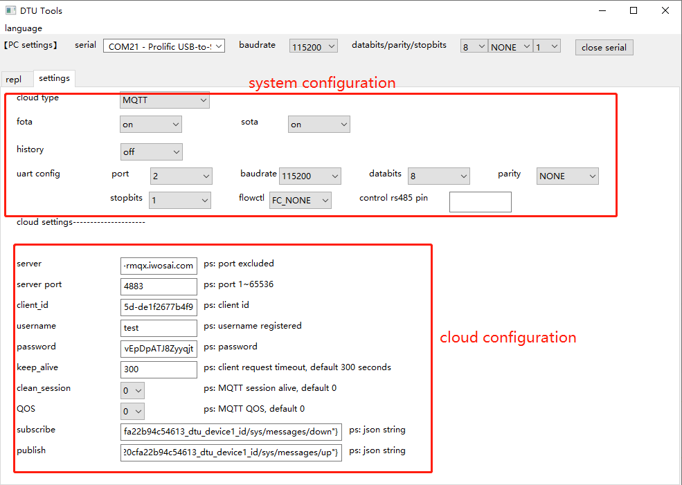

Parameter setting and display page

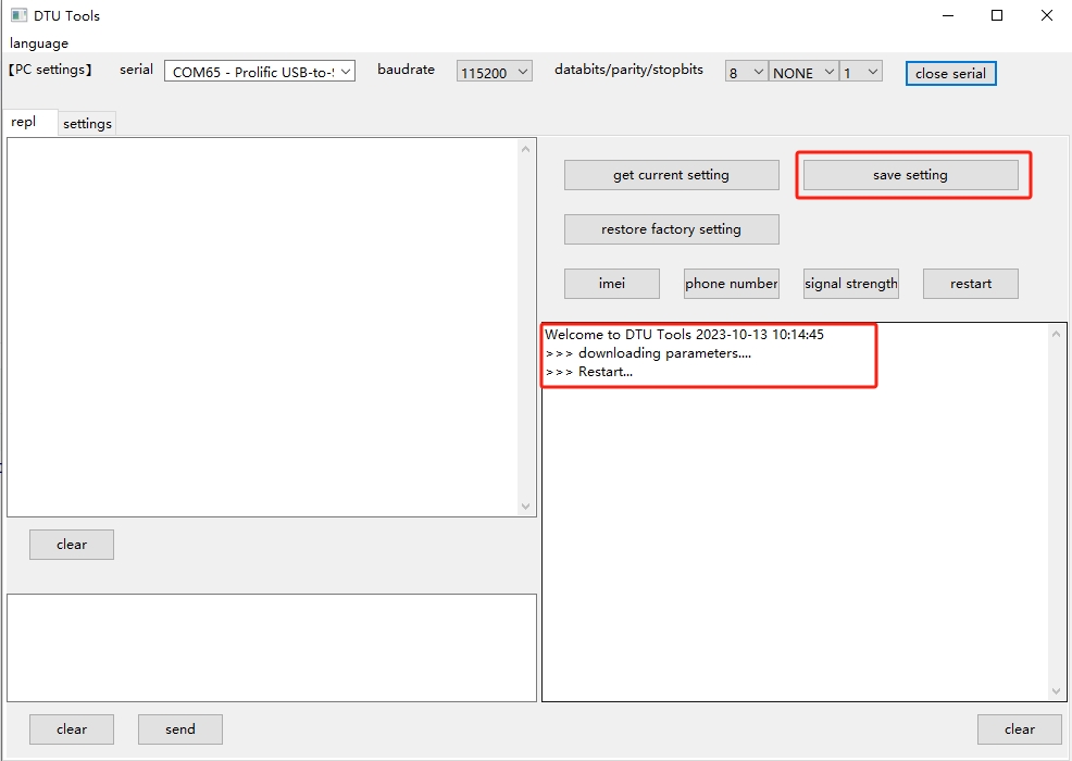

Save Parameter Settings
After getting the current parameter settings, enter the parameter "settings" page, and modify the settings according to actual needs (You can also set the parameter directly without getting the current values).
After the modification is completed, return to the "repl" page and click save setting to save the settings.
Click restore factory setting to restore the factory settings.

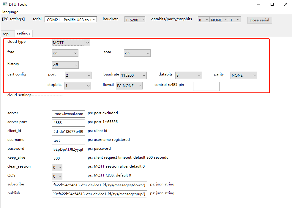

System Configuration Parameter
The basic configuration parameters are shown in the above figure.
| Parameter | Description |
| cloud type | Alibaba Cloud TCP Private Cloud MQTT Private Cloud |
| fota | Whether to enable firmware OTA upgrade |
| sota | Whether to enable project script OTA upgrade |
| history | When communication is abnormal and the DTU cannot send data to the cloud, the data will be saved and sent again when communication is restored |
| port | Serial port number that the external MCU connects to the DTU. Option: 0, 1 and 2. |
| baudrate | Serial port baud rate |
| databits | The number of data bits |
| parity | Whether to set parity check |
| stopbits | Length of stop bit. Option: 1 and 2. |
| flowctrl | Hardware control flow. Option: FC_NONE and FC_HW. |
| control rs485 pin | Pull up and pull down the specified GPIO before and after sending data through the serial port to indicate the direction of 485 communication. For example, 1 represents UART.GPIO1 and 2 represents UART.GPIO2. |

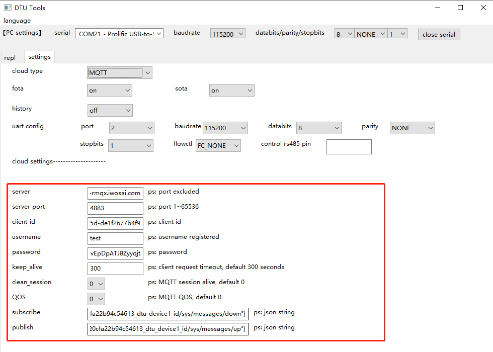

Cloud Configuration Parameter
The cloud configuration parameters vary with the selected cloud type. When the cloud type is MQTT, the cloud configuration parameters are as follows:
The subscription topic and publishing topic are both in the format of "JSON format with the topic ID as the key and the topic string as the value".
For example: the parameter
{"0":"/F79933DC83A4/connect_packet/adv_publish"}indicates that the topic with ID"0"is"/F79933DC83A4/connect_packet/adv_publish".

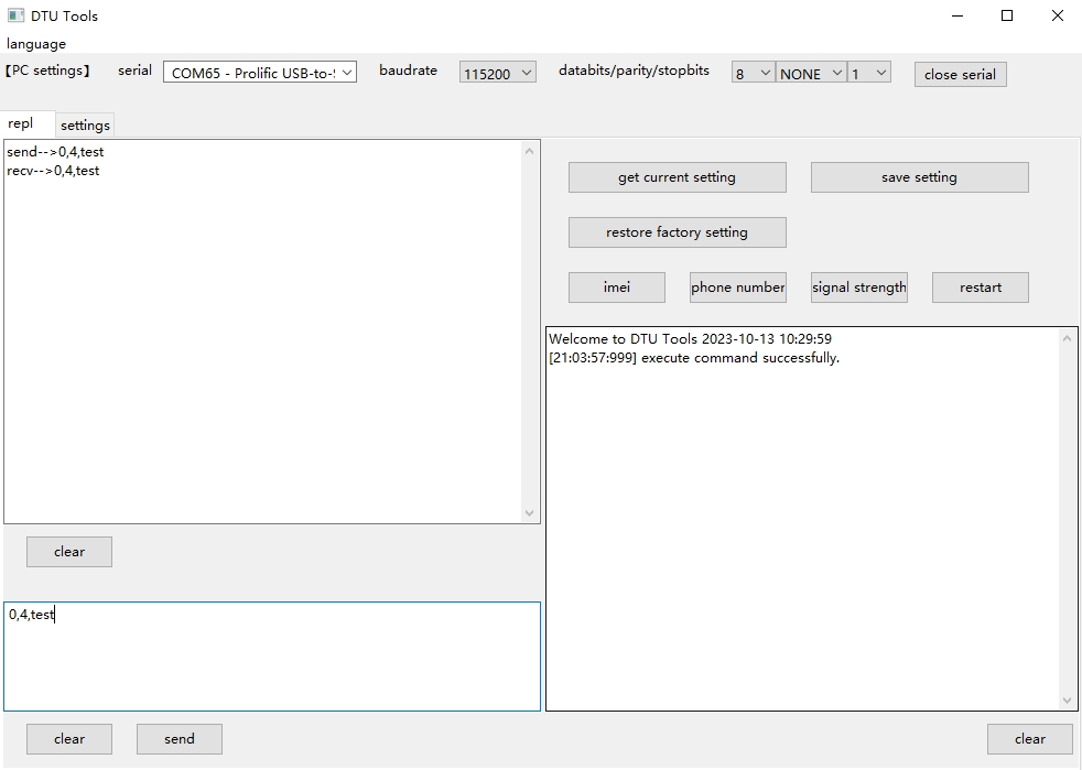

DTU Data Transmission and Debugging
Data format requirements for the data transmission box: The data transmission format is consistent with the communication format between MCU and DTU. Depending on the different communication protocols with the cloud, the communication protocol between the module and external devices (such as MCU) will also be different. When the module communicates with the cloud over the TCP protocol, because both TCP and serial ports are in the form of data streams, the data is transparently transmitted without any processing. When the module communicates with the cloud over the MQTT protocol, in order to distinguish different data frames, the module's serial port adopts a simple data frame for external protocol: <topic_id>,<msg_len>,<msg_data>.
Example messages
Upstream message: "1,6,abcedf"
Downstream message: "1,6,ijklmn"
Both the uplink and downlink messages between the module and the external device (MCU) are in string format, with data items separated by ",".

Note: Before debugging, please start the DTU device, select the serial port for communication with the DTU device in the "PC settings" area of the DTU Tool, and open the serial port.
