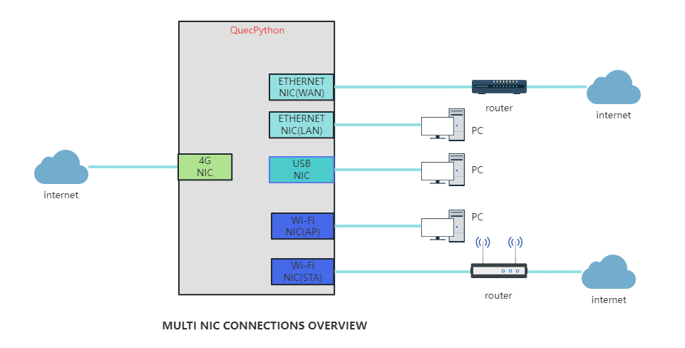

Network Configuration Introduction
QuecPython supports various types of NICs. How can we configure the NICs to enable them to communicate over the network? This introduces NIC configuration to help you quickly use NIC devices to connect to the network.
QuecPython provides two ways to configure NICs:
- QuecPython APIs.
- Built-in web service.
Only cellular network modules cannot use the web service.

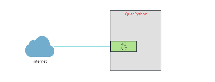

Cellular NIC
Cellular NICs rely on the network operator. A module must be integrated with a SIM card and be in the coverage of the network operator's base station to establish a network connection. QuecPython-supported cellular communication modules will automatically connect to the cellular network after power-on.

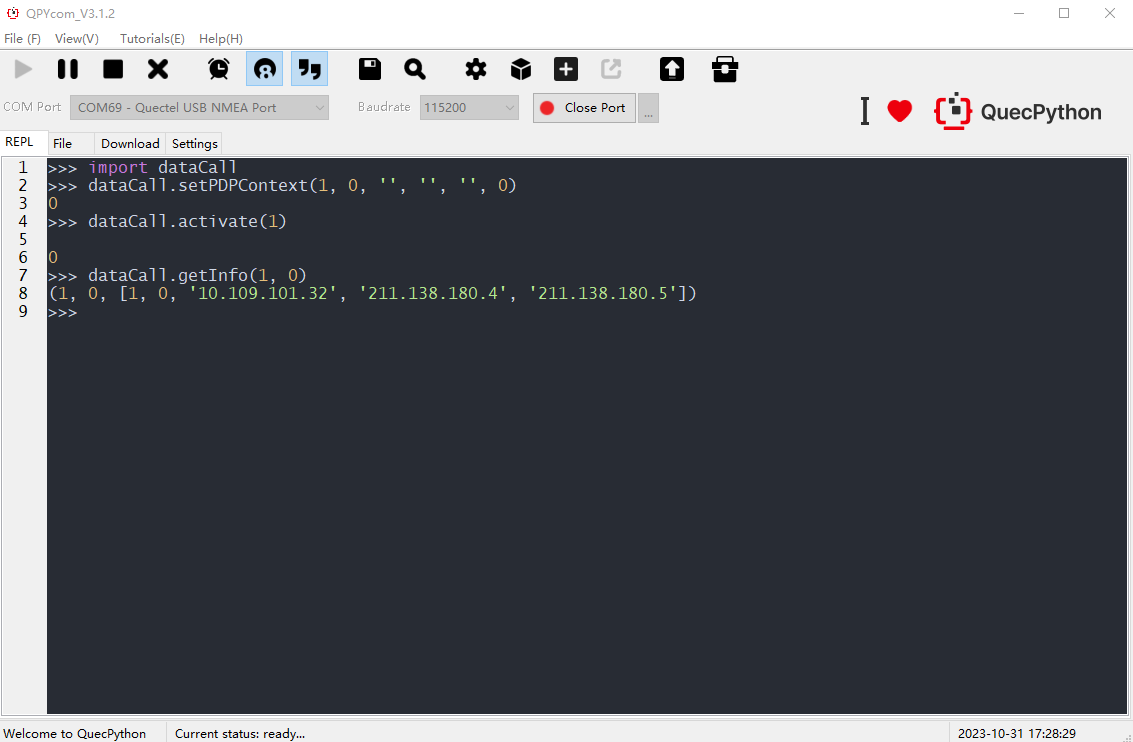

Example
>>> import dataCall
>>> dataCall.setPDPContext(1, 0, '', '', '', 0) # Set NIC information
0
>>> dataCall.activate(1) # Activate the first channel of NIC
0
>>> dataCall.getInfo(1, 0) # Query the data call information for the first channel of NIC
(1, 0, [1, 0, '10.11.129.252', '211.138.180.4', '211.138.180.5'])
# The module can connect to the network through the 4G network.

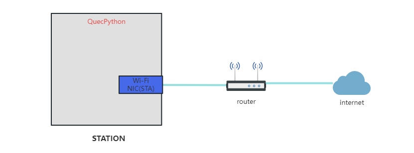

Wi-Fi NICs have different application scenarios in different working modes. In station mode, the NIC needs to connect to a Wi-Fi hotspot (such as a router) to connect to the network. In AP mode, the Wi-Fi NIC serves as a hotspot, accepting connections from other Wi-Fi devices and providing network services to them.
There are multiple ways to configure Wi-Fi NICs, such as directly entering the hotspot name and password, quick configuration, AP configuration and web page configuration. However, the ultimate goal is to successfully obtain the hotspot name and password. This chapter focuses on loading the Wi-Fi NIC and connecting to the hotspot directly. For other configuration methods, please refer to Wi-Fi NIC.
Example
General Wi-Fi NIC configuration
>>> import network
>>> nic = network.WLAN(network.STA_IF) # Load the Wi-Fi NIC driver. For external devices, you need to confirm whether additional parameter configuration is required.
0
>>> nic.connect('ssid','password') # Connect to the Wi-Fi hotspot.
0
>>> nic.status() # Check the connection status. "5" indicates "connected".
5
>>> nic.ifconfig() # Query IP address.
('192.168.1.4', '255.255.255.0', '192.168.1.1', '192.168.1.1')
# The module can connect to the network through the Wi-Fi network.

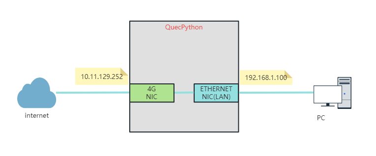

LAN Mode
In LAN mode, an Ethernet NIC connects with another Ethernet device as a LAN port, thus providing Internet access capability for the device through 4G network, as shown in the following diagram.
In this mode, the module will enable DHCP service by default to assign a dynamic IP address to the connected Ethernet device.
Example:
>>> import dataCall
>>> import ethernet
>>> info = dataCall.getInfo(1, 0) # Get the IP address of the current data call from the 4G NIC to ensure that the 4G network is normal.
>>> print(info)
(1, 0, [1, 0, '10.84.113.152', '211.138.180.2', '211.138.180.3'])
>>> W5500 = ethernet.W5500(b'\x12\x34\x56\x78\x9a\xbc', '192.168.43.1', '', '', -1, -1, -1, -1, 1) # Load the Ethernet NIC driver. In actual use, you need to confirm whether to use the default configuration for hardware connection. If you want to customize the hardware connection configuration, complete the parameters of the Ethernet NIC initialization API.
0
>>> W5500.set_default_NIC('10.84.113.152') # Set the 4G NIC as the default NIC.
0
>>> W5500.ipconfig() # Query IP address.
[('12-34-56-78-9A-BC', 'W5500'), (4, '192.168.43.1', '255.255.255.0', '192.168.43.1', '8.8.8.8', '114.114.114.114')]
>>> W5500.set_up() # Start the Ethernet NIC.
0
# The Ethernet device can connect to the network.

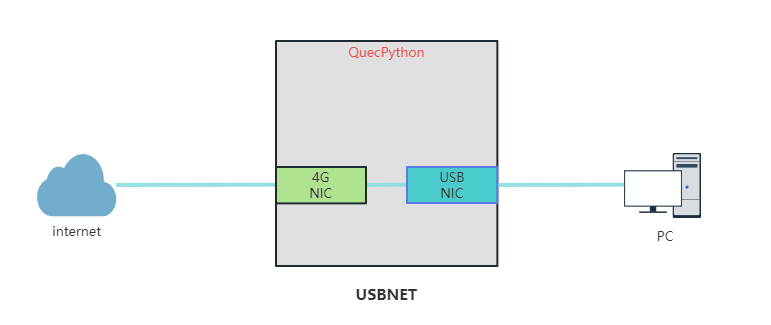

USB Network Adapter
Currently, the USB network adapter is used when the USB port serves as a LAN port to transfer data through the 4G NIC for Internet access. Both ECM and RNDIS protocols are supported by USB network adapter. You can select one according to your needs. RNDIS can be directly loaded in Windows, while ECM can be directly loaded in Linux/Android/iOS systems.
Cellular communication modules that support USB network adapter are connected to host devices that support ECM or RNDIS protocols via a USB port to provide Internet access for the host device through the 4G network, as shown in the following diagram.
After calling set_worktype(USBNET_Type) to set the protocol type of the USB network adapter, call USBNET.open() to enable the USB network adapter.
USBNET_Type description:
- USBNET.Type_RNDIS: RNDIS protocol. Windows operating system supports RNDIS protocol by default.
- USBNET.Type_ECM: ECM protocol. Linux, Android, iOS, macOS, and other operating systems support ECM protocol by default.
Example:
>>> from misc import USBNET
>>> USBNET.get_worktype() # Get USB network adapter working mode.
3
>>> USBNET.set_worktype(USBNET.Type_RNDIS) # Configure USB network adapter protocol to RNDIS. Please note that the configuration takes effect after the module is rebooted.
0
>>> USBNET.open() # Enable USB network adapter.
0
# The USB device can connect to the network through USB network adapter.

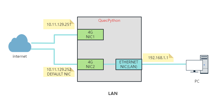

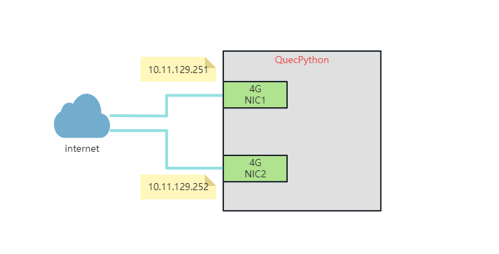

Transfer Data Using a Specified Cellular NIC
When multiple SIM cards or multiplex data calls are supported, you need to specify which channel or SIM card to use for communication.
The socket API provides the capability to bind to a specific NIC for data communication. The parameters in socket.bind() define an IP address and port number to specify the data transmission direction in multiple data calls.
Example of using NIC1 for communication:
# Import usocket
import usocket
if __name__ == '__main__':
# Create a socket object
sock = usocket.socket(usocket.AF_INET, usocket.SOCK_STREAM, usocket.TCP_CUSTOMIZE_PORT)
sock.settimeout(5)
sock.bind(("10.11.129.251", 0))
# Resolve the domain name
sockaddr=usocket.getaddrinfo('python.quectel.com', 80)[0][-1]
print('start connect')
# Connect to the TCP server
sock.connect(sockaddr)
# Send the data to the server
ret=sock.send('GET /NEWS HTTP/1.1\r\nHost: python.quectel.com\r\nAccept-Encoding: deflate\r\nConnection: keep-alive\r\n\r\n')
print('send %d bytes' % ret)
# Receive data from the server
data=sock.recv(1024)
print('recv %s bytes:' % len(data))
print(data.decode())
# Close the connection
sock.close()
Example of using NIC2 for communication:
# Import usocket
import usocket
sock.settimeout(5)
sock.bind(("10.11.129.252", 0))
sock.close()

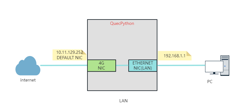

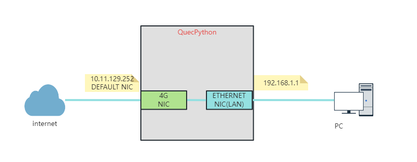

LAN Mode
In LAN mode, the 4G NIC provides network services for devices within the LAN, and the 4G NIC is the default NIC. If the module needs to communicate using the Ethernet NIC, call socket.bind() to specify which NIC to use for network communication.
Example:
# Import usocket
import usocket
sock.settimeout(5)
sock.bind(("192.168.1.1", 0))

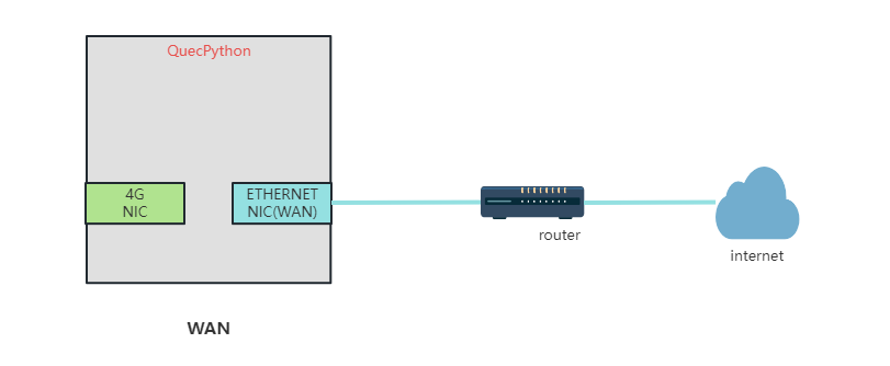

WAN Mode
In WAN mode, the Ethernet port is configured specially for network communication and the Ethernet NIC is set as the default NIC. The Ethernet NIC can be used for communication without IP address binding.
Example:

In station mode, the Wi-Fi port is configured specially for network communication and the Wi-Fi NIC is set as the default NIC. The Wi-Fi NIC can be used for communication without IP address binding.
Example:
# Import usocket
import usocket
sock = usocket.socket(usocket.AF_INET, usocket.SOCK_STREAM)
sock.settimeout(5)
sockaddr = usocket.getaddrinfo('python.quectel.com', 80)[0][-1]
ret = sock.send('GET /NEWS HTTP/1.1\r\nHost: python.quectel.com\r\nAccept-Encoding: deflate\r\nConnection: keep-alive\r\n\r\n')
# Receive the data from the server
data = sock.recv(1024)
sock.close()

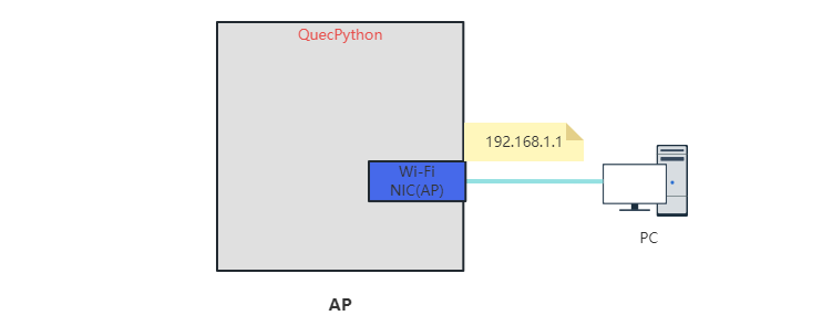

AP Mode
In AP mode, the 4G NIC provides network services for devices within the AP LAN, and the 4G NIC is the default NIC. If the module needs to communicate using the Wi-Fi NIC, call socket.bind() to specify which NIC to use for network communication.
For single-NIC devices, IP address binding is not required.
Example:
# Import usocket
import usocket
sock.settimeout(5)
sock.close()

Network Configuration with Multiple NICs
As shown in the diagram below, the module integrates multiple NICs, each with different configurations and working modes to provide different network services. Among them, the 4G NIC, the Wi-Fi NIC in AP mode, the Ethernet NIC in WAN mode are used to access external networks, while the Wi-Fi NIC in station mode, the Ethernet NIC in LAN mode, and the USB NIC provide local area networks. How to choose which NIC to use and how to configure network forwarding to communicate in the desired way?
For the multi-NIC scenario, QuecPython provides the following two solutions:
- Specify NIC for Data Transmission
In scenarios with multiple NICs, it is unclear which one will be used for network communication. But sometimes network services are in different LANs, requiring sending from a specified NIC. In this case, you can call socket.bind() to bind the IP address of the NIC to specify the NIC for TCP/UDP communication. As shown below, binding 10.11.129.252 to perform network communication through the 4G NIC, while binding 192.168.1.100 to perform network communication through the Ethernet NIC.
- Configure NIC Forwarding
Call nic.set_default_NIC(ip) to set an NIC as the default for external network access. Then enable NAT to forward data from other NICs. As shown below, after calling nic.set_default_NIC('10.11.129.252'), data from the Ethernet NIC is forwarded through the 4G NIC.
The interface for configuring the default NIC is mainly designed for users to maintain the default NIC, making it easy to switch network forwarding.
The 4G NIC is fixed as the default. After it makes a data call, it will be configured as the default again. Currently, 4G is mostly used as the default NIC for external forwarding, to avoid the uncertainty that leads to network unavailability.

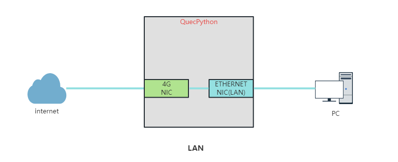

Ethernet (LAN) -> LTE (Single Data Call)
With both an Ethernet NIC and a cellular NIC (4G), how to use the 4G network to connect to the external network through the Ethernet? See the figure below for the working mode.
For multiple NICs, the configuration of forwarding relationships is not yet provided in QuecPython solution. Instead, you only need to configure the default NIC. Regardless of how many NICs, there is only one default NIC. By configuring the default NIC, NAT forwarding will be performed through the default NIC.
Example:
# This example only demonstrates the configuration of the forwarding direction. For specific Ethernet NIC initialization configuration, please refer to the section of Ethernet NIC.
# "nic" refers to the specific NIC object. Currently, the default NIC configuration interface is inside the specific NIC functions. In the future, the interface will be placed as a basic interface under the network configuration APIs.
# Now the device in the Ethernet can access the external network through the 4G network.

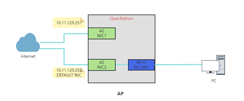

Wi-Fi (AP) -> LTE (Multiple Data Calls)
With both a Wi-Fi NIC and two 4G NICs, how to configure the 4G NICs to make multiple data calls in which one NIC provides an LTE network to the Wi-Fi network and another NIC for internal communication? See the diagram below for the working mode.
As shown in the diagram above, the IP address for the NIC1 is 10.11.129.251, and the IP address for the NIC2 is 10.11.129.252. We use the NIC1 for internal communication and the NIC2 for providing LTE network to the Wi-Fi network.
Example of using NIC1 for internal communication:
# Import usocket
import usocket
sock.settimeout(5)
# Receive the data to the server
sock.close()
Example of using NIC2 for providing LTE network to the Wi-Fi network.
# This example only demonstrates the configuration of the forwarding direction. For specific Wi-Fi NIC initialization configuration, please refer to the section of Wi-Fi NIC.
# Now the device in the Wi-Fi network can access the external network through the 4G network.

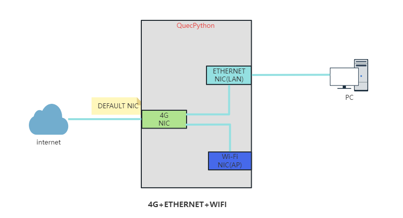

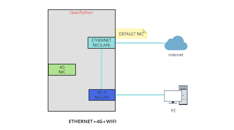

Complex Scenario
This section demonstrates a typical multi-NIC application scenario to help users understand the application of NICs in a multi-NIC environment and quickly get started.
Case
When a 4G NIC, an Ethernet NIC and a Wi-Fi NIC are used at the same time, you can configure different working modes for different NICs based on your needs. Once the NICs enter the normal working state, you can change the default NIC to switch the forwarding rules.
For the use of Ethernet, Wi-Fi, and cellular networks, there is no fixed usage rule. It is recommended to use networks in the priority of Ethernet > Wi-Fi > cellular.
- Set 4G NIC as the default NIC to forward Wi-Fi network and Ethernet data.
Example:
# Import usocket
import dataCall
import network
import ethernet
# Set the default NIC
defalut_nic = None
# Get the 4G NIC information
lte = dataCall.getInfo(1, 0)
print(lte)
# Initialize the Wi-Fi NIC
WiFi = network.ASR5803W(network.AP_IF)
WiFi.config('ssid'='QuecPython', 'key'='quecpython')
WiFi.active(True)
print('Wi-Fi init success')
# Initialize the Ethernet NIC
eth = ethernet.YT8512H(b'\x12\x34\x56\x78\x9a\xbc','192.168.1.1')
eth.set_up()
print('ethernet init success')
defalut_nic = lte[2][2]
eth.set_default_NIC(defalut_nic)
- Set Ethernet NIC as the default NIC to forward Wi-Fi network data.
Here's an example code:
# Import usocket
import dataCall
import network
import ethernet
defalut_nic = None
print(lte)
WiFi.active(True)
# Initialize the Ethernet NIC. The Ethernet NIC will get a dynamic IP address through DHCP in WAN mode to connect to the network
eth = ethernet.YT8512H(b'\x12\x34\x56\x78\x9a\xbc')
eth.dhcp()
eth.set_up()
# Set the Ethernet NIC as the default NIC
defalut_nic = eth.ipconfig()[1][1]
