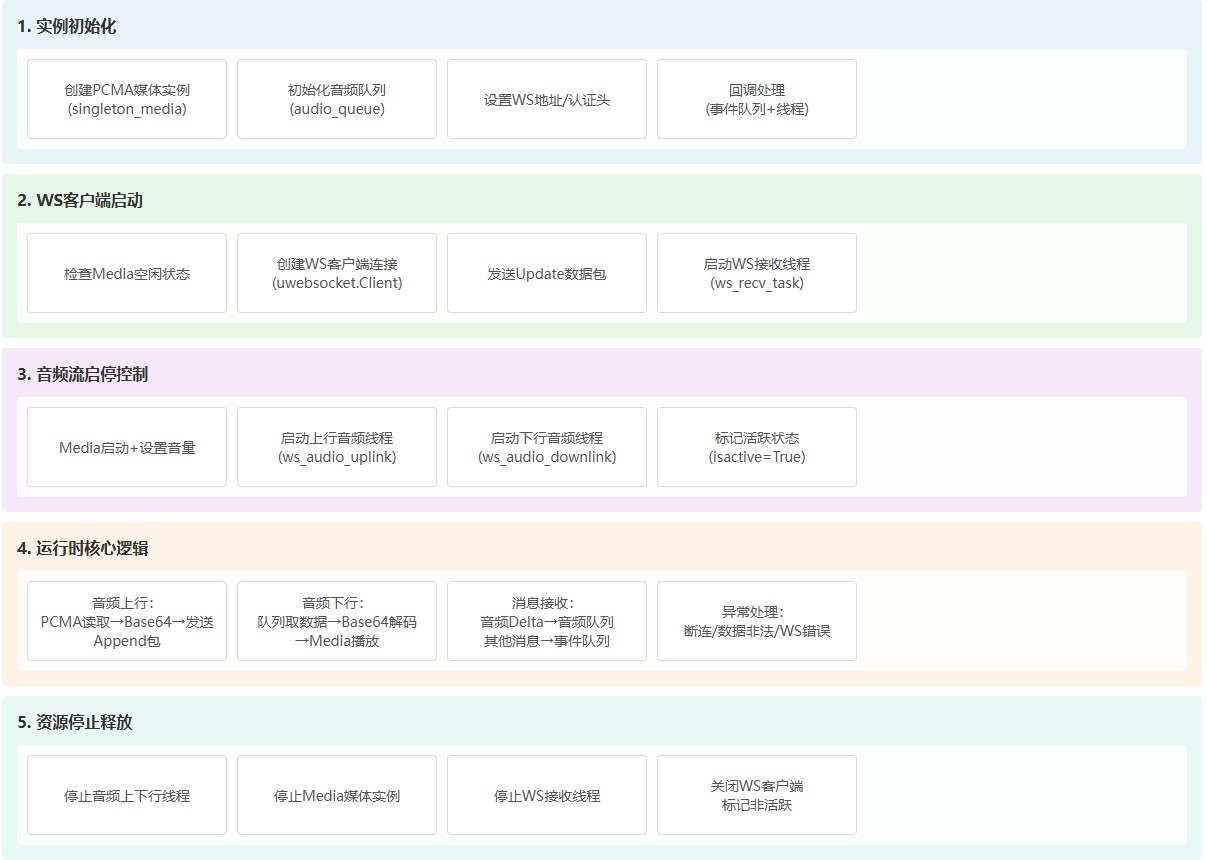

软件设计讲解
软件框架
框架设计图
代码讲解
类初始化(init)
def __init__(self, url, auth, callback=None):
    # 初始化PCMA媒体实例(单例),检查占用状态
    self.media = singleton_media('pcma', 4)
    if self.media is None:
        print('media is busy, please stop it first')
        return
    # 初始化音频下行队列(存储服务端推送的音频数据)
    self.audio_queue = Queue()
    # 配置WS连接信息(地址+认证头)
    self.url = url
    self.headers = {"Authorization": "Bearer " + auth}
    # 初始化线程ID(用于后续停止线程)、活跃状态、音量配置
    self.ws_recv_task_id = None
    self.ws_audio_uplink_handler_id = None
    self.ws_audio_downlink_handler_id = None
    self.isactive = False
    self.volume = 8
    self.callback = callback
    # 若传入回调函数,初始化事件队列并启动回调处理线程
    if self.callback:
        self.event_queue = Queue()
        self.ws_callback_event_id = _thread.start_new_thread(self.ws_server_event_handler, ())
