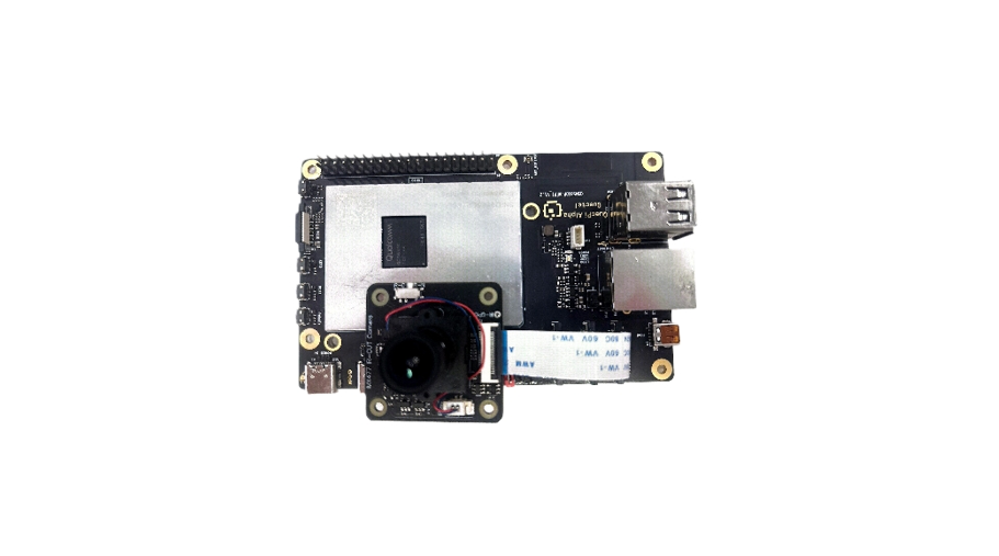

The Quectel Pi H1 single board computer supports two cameras MIPI CSI interfaces, as shown in the following figure
Quick Start
  1. Connect according to the following diagram. When connecting, pull up the black locking part of the connector and insert the FPC cable into any one CSI card slot. Pay attention to the gold finger of the cable facing the metal contact surface inside the board. Press the locking buckle to confirm that the FPC cable is stable and not loose.
  1. Refer to Display Configuration to connect the display screen
