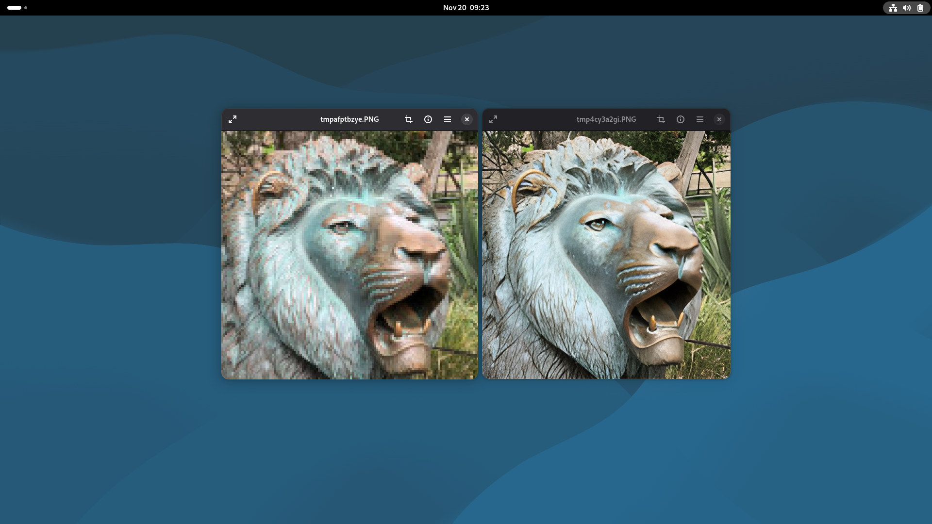

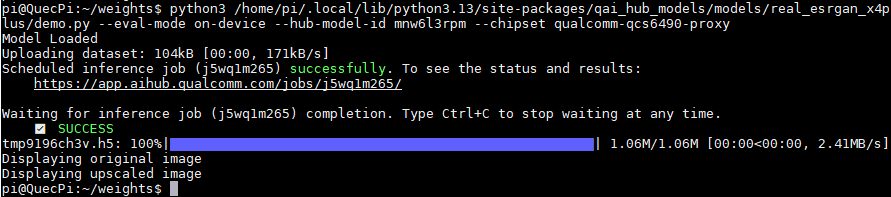

Run demo
python3 -m qai_hub_models.models.yolov7.demo --quantize w8a8
- If you want to run demo on cloud devices, you need to add the hub-model-id parameter
