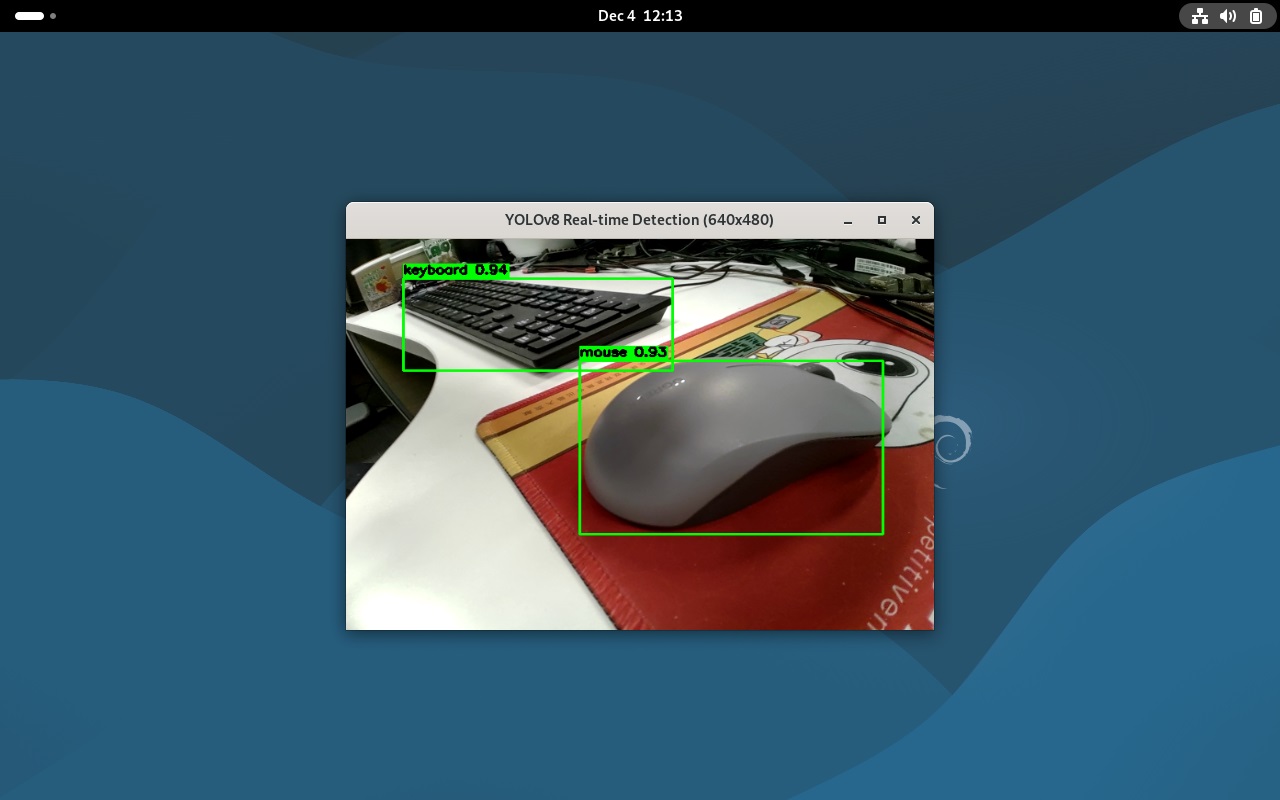

On-device deployment of YOLOv8 object detection
This document is based on the Qualcomm Quick AI Application Builder (QAI AppBuilder) tool, the wxWidgets library, and the YOLOv8 model to develop an application that captures camera streams, recognizes content, and displays it on screen.

Runtime Result
Quick deployment verification
The compiled program and all required runtime files have been packaged into yolov8-det-deploy.tar.gz, allowing for quick deployment and verification.
tar xvf yolov8-det-deploy.tar.gz
#Starting the camera requires root privileges; simply enter the sudo password as prompted.
cd yolo-deploy
./run.sh
