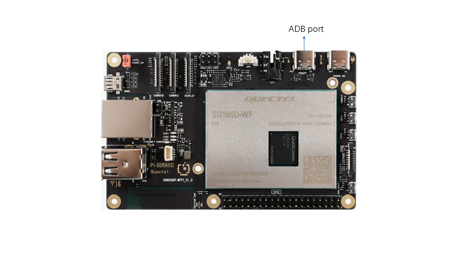

The ADB port of Quectel Pi H1 Smart Single-Board Computer is shown in the following figure:

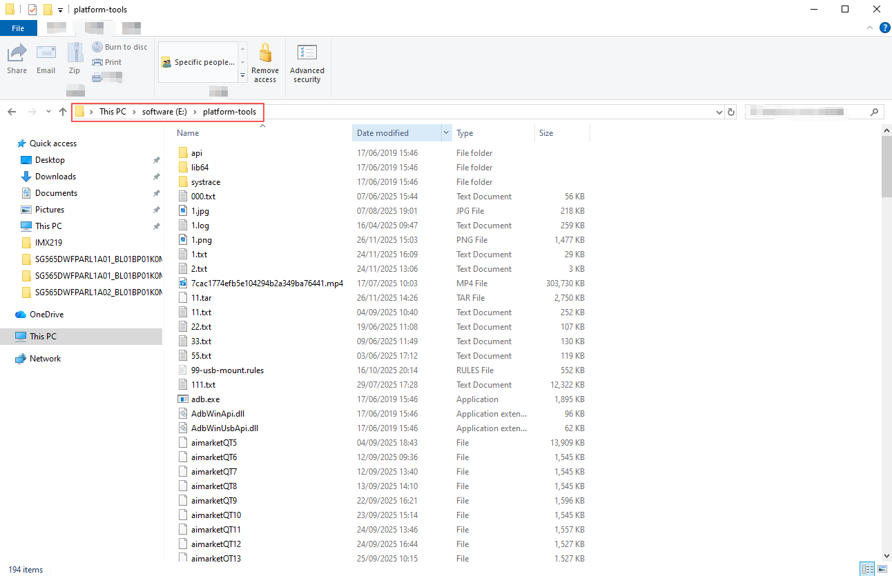

  2. Download the platform-tools tool on your computer and unzip it.

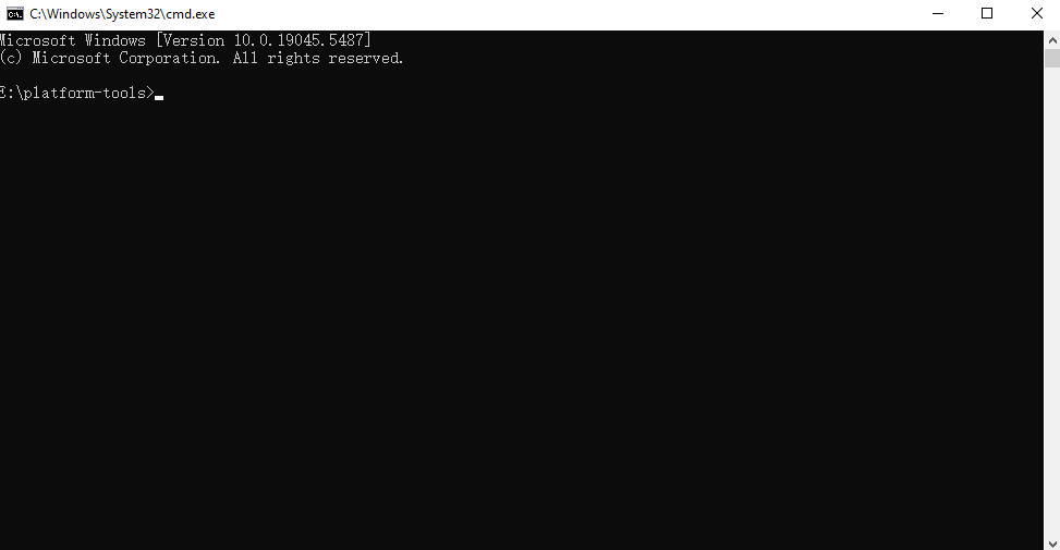

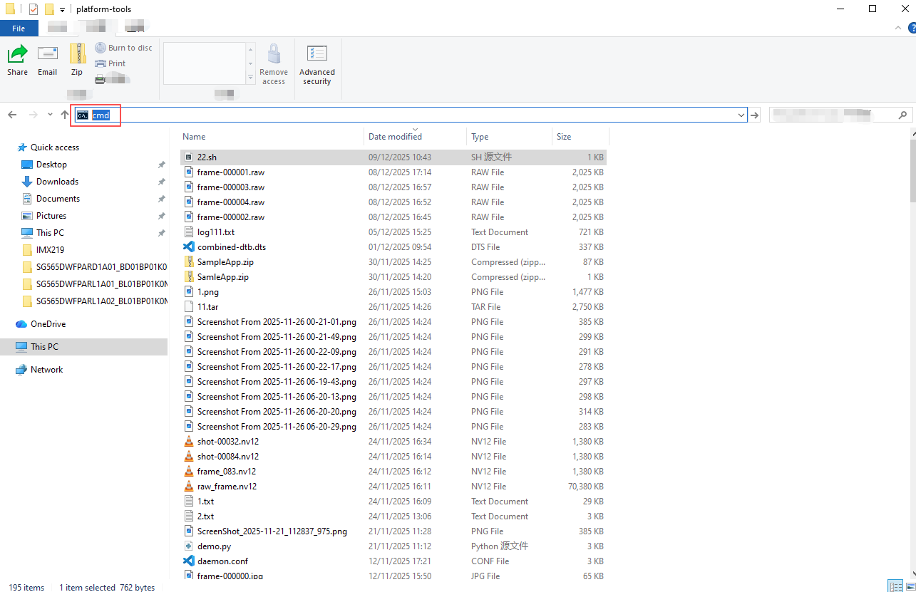

  1. Open the folder where the platform tools tool is located, enter cmd in the top path box, press enter to open the adb terminal.

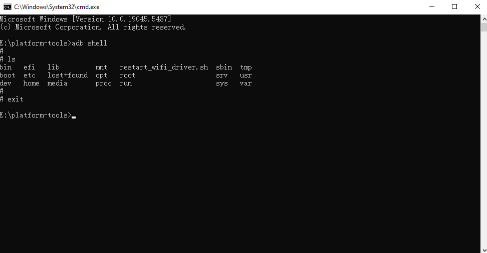

Enter the device shell terminal:
adb shell
  • After entering the shell terminal, the user identity defaults to root.
  • If you want to exit the shell terminal, enter exit.
