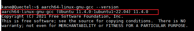

Verifying Installation
$ aarch64-linux-gnu-gcc --version

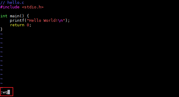

Creating Code File
$ touch  hello.c
$ sudo vim hello.c
Press ESC + i, enter the following code, then press ESC + "shift + : ", and type "wq+Enter" in the command console to save and exit.
