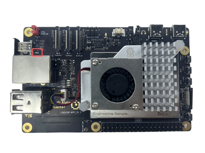

Component Physical Reference

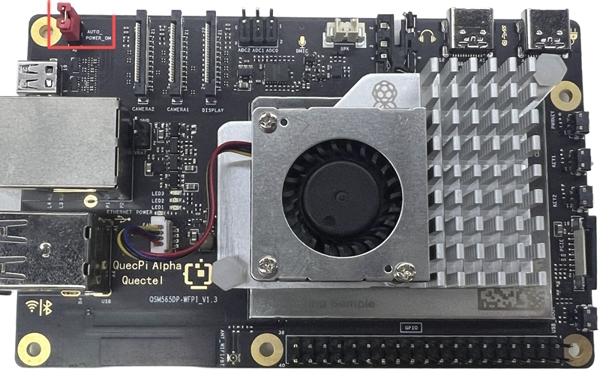

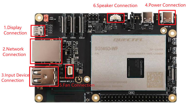

Hardware Connection
Complete all hardware connection steps below. The numbering matches the interface diagram:
  1. Display connection: Connect one end of the Micro HDMI cable to the Micro HDMI port on the smart single-board computer, and the other end to the HDMI port on the monitor.

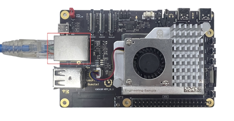

  2. Network connection: Connect one end of the Ethernet cable to the Gigabit Ethernet port on the smart single-board computer, and the other end to the router's port (make sure the router is connected to the internet).

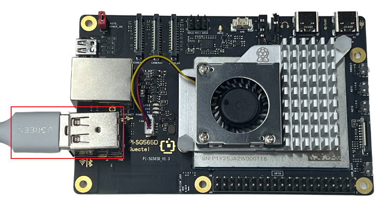

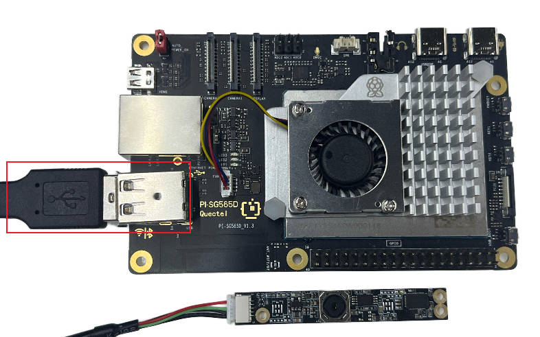

  3. Input device connection: Connect USB keyboard and mouse to the USB ports on the hub, then connect the hub to a USB port on the smart single-board computer. For wireless devices, insert the receiver into a USB port on the hub. Then connect the OV5693 camera module to another USB port on the smart single-board computer.

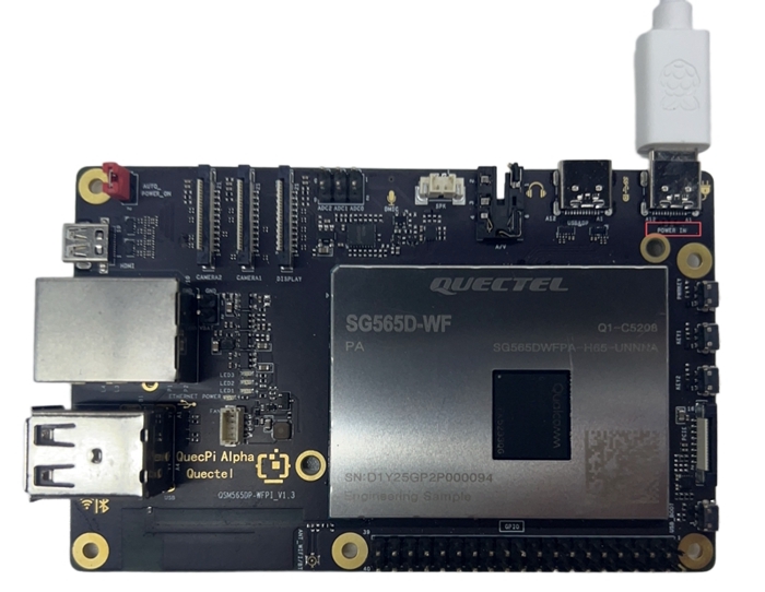

  4. Power connection: Connect the USB-A end of the power cable to the power adapter, and the USB-C end to the power port on the smart single-board computer (usually labeled POWER IN).

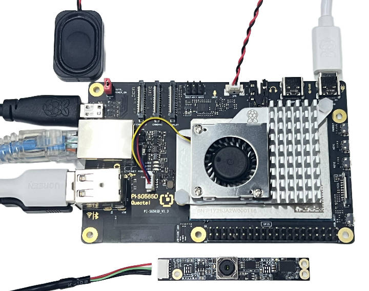

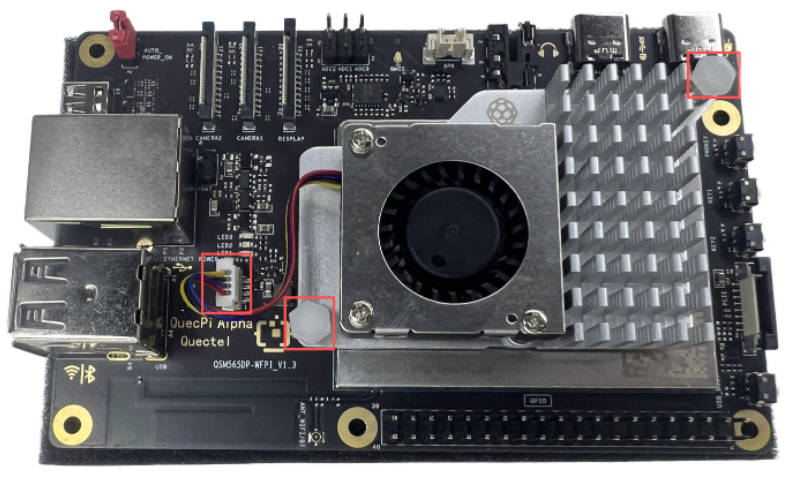

  5. Heat sink fan connection: First, insert the cooling fan's ribbon cable into the FAN slot of the smart single-board computer. Then, fix the two ends of the heat sink into the reserved holes on the board.
  6. Speaker connection: Connect the 2PIN PH1.25 interface speaker to the SPK slot on the smart single-board computer.
Completed Connection Reference
After completing the connections above, you do not need to disconnect connected accessories such as the camera, speaker, or monitor during subsequent shutdown or reboot. Keep them connected.

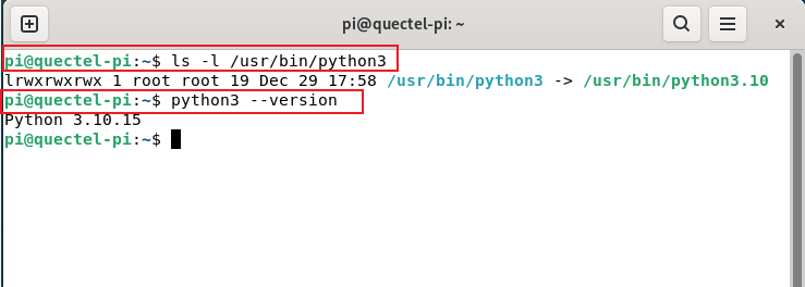

  1. Reopen the terminal and verify the Python version. If the output is Python 3.10.15, the installation is successful.
python3 --version

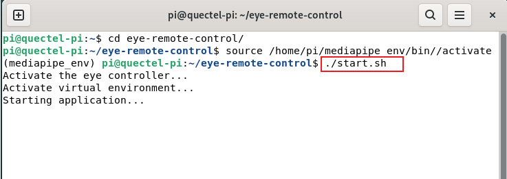

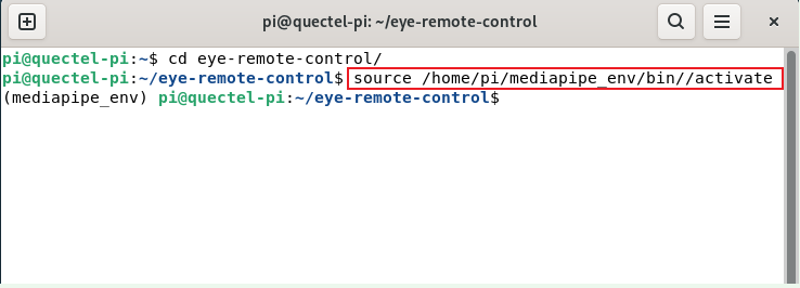

Run Program
Run the ./start.sh startup script in the demo-eye-remote-control directory.
cd demo-eye-remote-control/
./start.sh

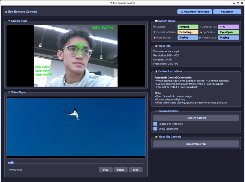

  1. Start the program: the application will automatically open the camera and start detection.
  2. Load a video: click the "Select Video File" button to load the video you want to play.
  3. Watch: the system will automatically control play/pause according to your gaze state.
  4. Switch modes: use fullscreen playback for a better viewing experience.
UI Features
  • Fullscreen: press F11 or click the fullscreen button on the UI to enter fullscreen mode.
  • Fullscreen playback mode: plays the video in fullscreen and controls playback based on real-time recognition.
  • Camera toggle: turn the camera on or off at any time.
  • Detection toggle: enable or disable eye detection manually.
  • Landmark display: visualizes eye keypoints and detection results on the screen.
Control Logic
State Behavior Description
Eyes open + looking at screen Continue playback System detects user watching
Eyes closed or looking away Automatically pause Pauses playback when user closes eyes or looks away
Face leaves camera Automatically pause Pauses if no face detected for more than 1 second
