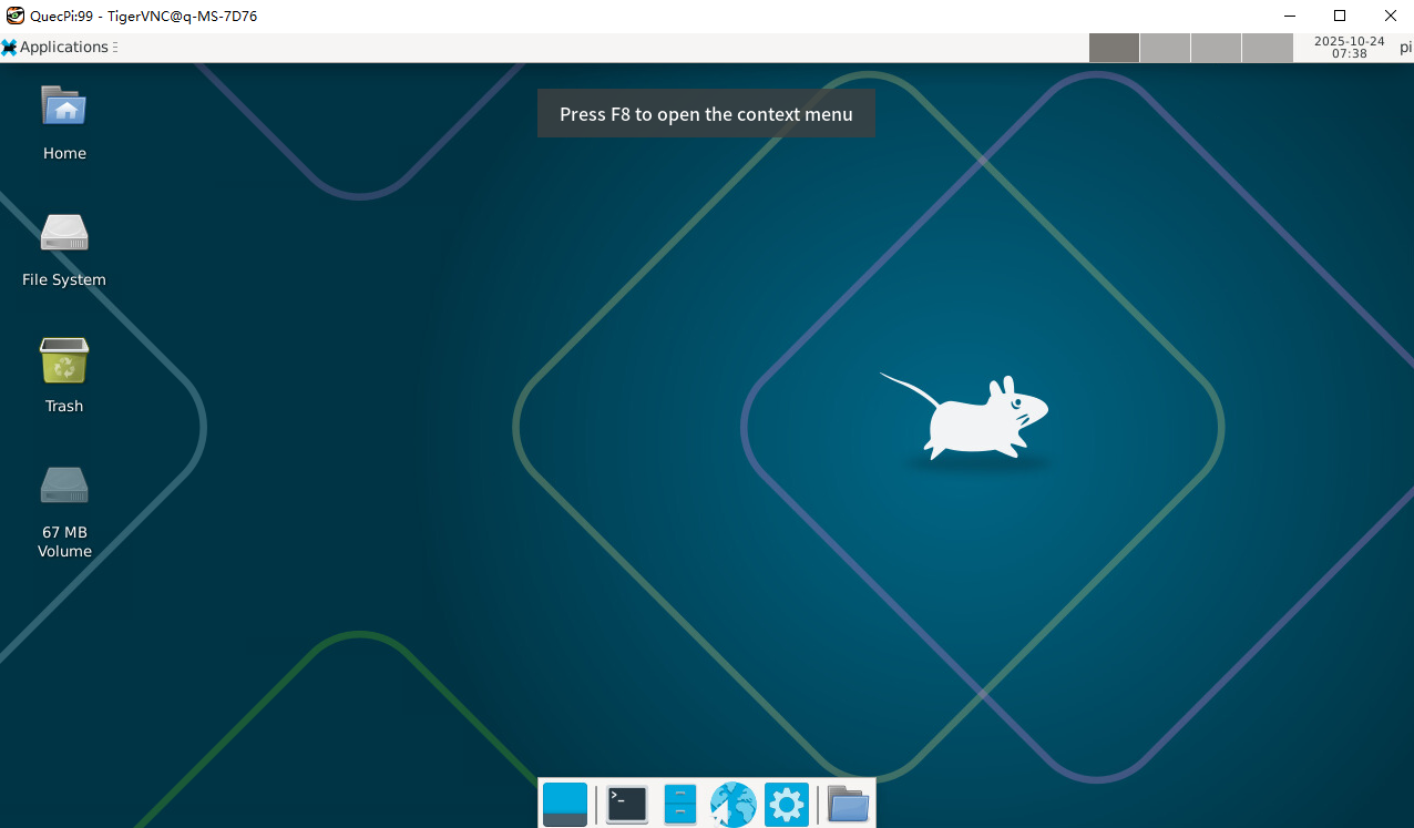

Test connection
# Connect from another computer, enter the password as prompted to log in
# For example, vncviewer 10.66.82. *: 5900
Vncviewer<Device IP Address>: 5900
  • After a successful connection, you will see the following remote desktop interface.
