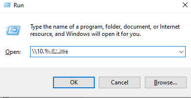

Access shared folder from a Windows computer
  1. Press "Win+R" to open the Run dialog.
  2. Enter " \\\ + device IP address ".

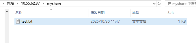

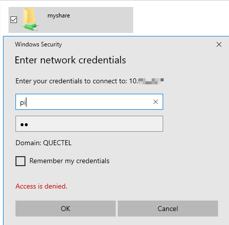

  1. Enter the username and password to access the contents of the shared folder.
    Username: pi
    Password: The password set using sudo smbpasswd -a pi
After successful access, you can see the previously created test file test.txt.
