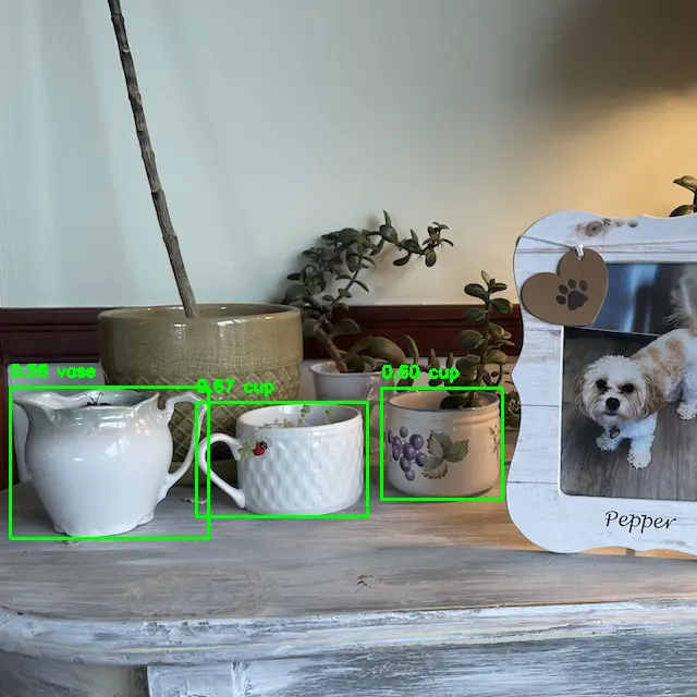

YOLOv8-det example
cd ~/ai-engine-direct-helper/samples/linux/python
pip3 install requests tqdm qai-hub py3_wget opencv-python torch torchvision
python3 yolov8_det/yolov8_det.py --output_image_path ./output.jpg
Input image
Output image

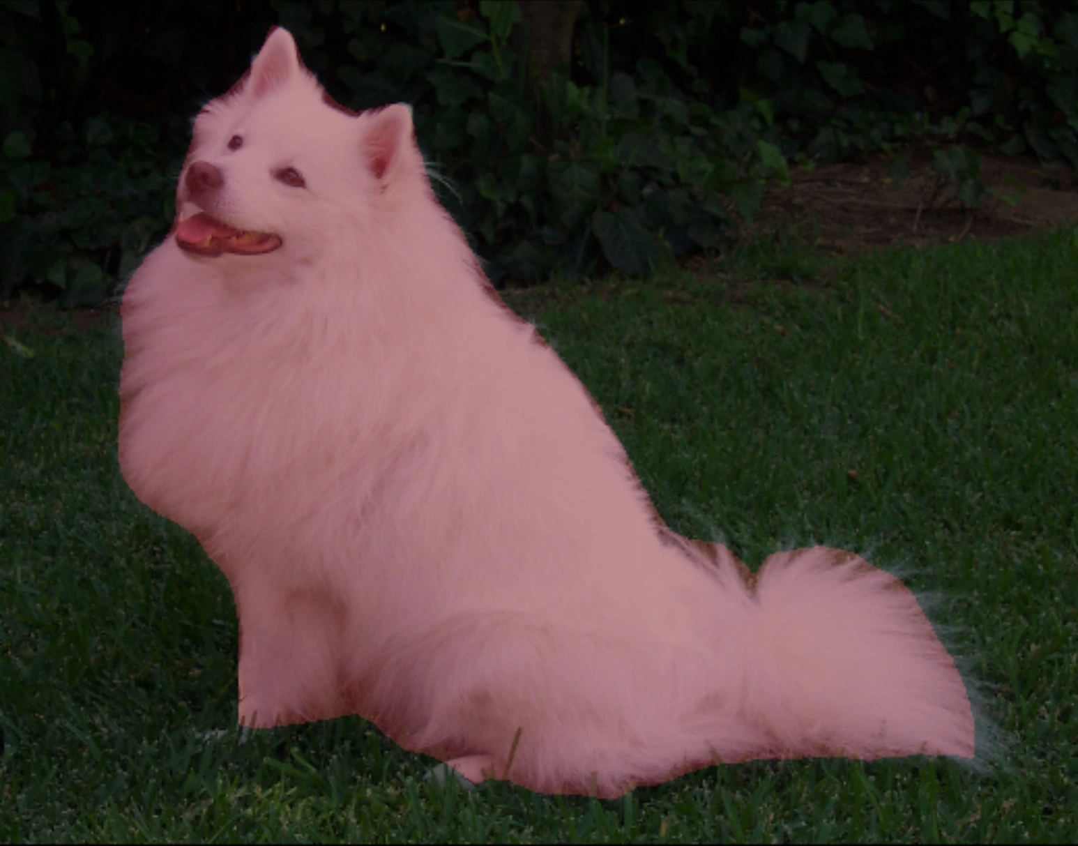

XLSR example
pip3 install matplotlib easyocr qai_hub_models transformers openai-clip
python3 xlsr/xlsr.py
Input image
Output image

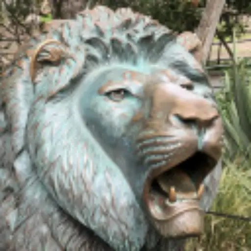

SESR-M5 example
python3 sesr_m5/sesr_m5.py
Input image
Output image
Program output log

FCN-ResNet50 example
python3 fcn_resnet50/fcn_resnet50.py --image ./input.jpg
Input image
Output image
