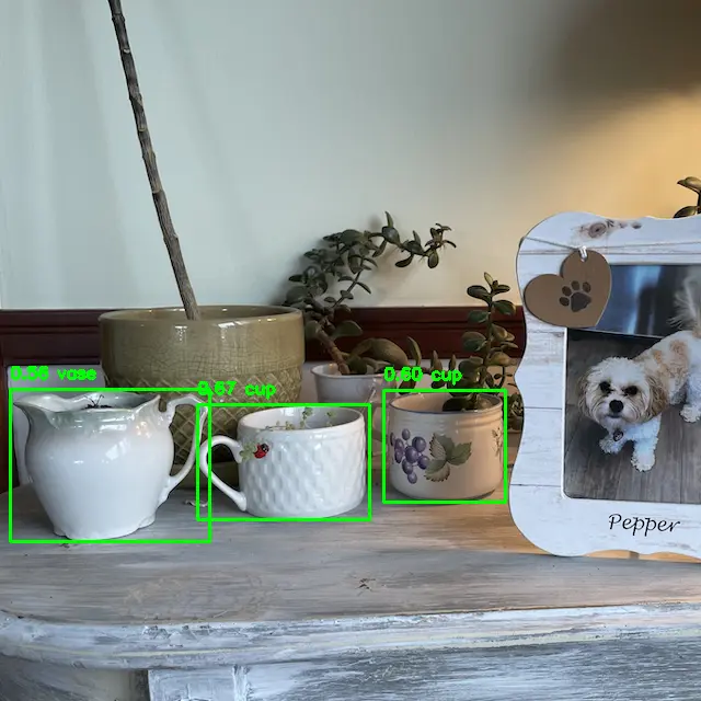

YOLOv8-det示例
cd ~/ai-engine-direct-helper/samples/linux/python
pip3 install requests tqdm qai-hub py3_wget opencv-python torch torchvision
python3 yolov8_det/yolov8_det.py --output_image_path ./output.jpg

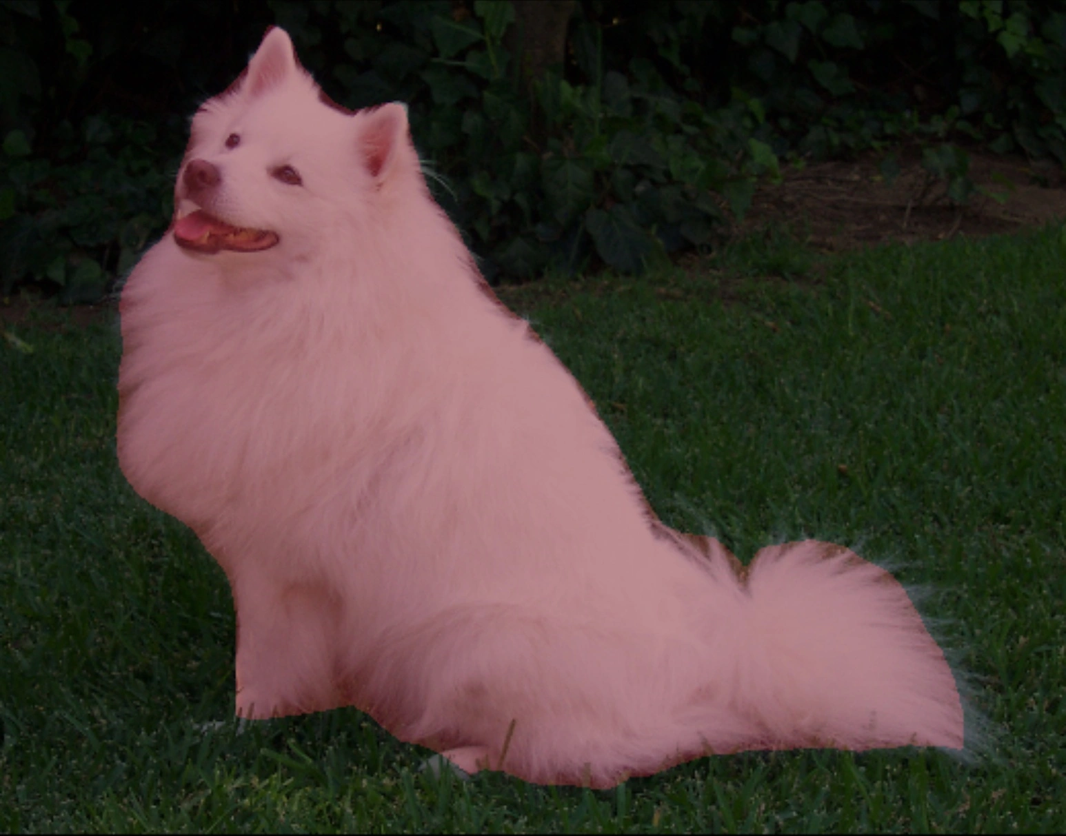

FCN-ResNet50示例
python3 fcn_resnet50/fcn_resnet50.py --image ./input.jpg
输入图像
输出图像
