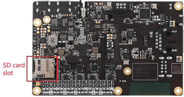

The Quectel Pi H1 single-board computer includes one push‑type SD card slot compliant with the SD 3.0 specification.
Hardware interface
Insert the SD card into the SD card slot of the Quectel Pi H1 single-board computer.
