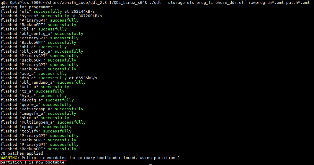

  2. Use the following command to run the QDL executable file in the QDL_Linux-x64 directory for software refresh.

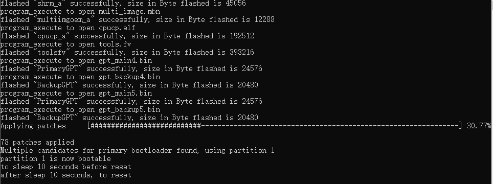

./qdl --storage ufs prog_firehose_Qcm6490_ddr.elf rawprogram*.xml patch*.xml
  1. If you see the message "partition 1 is now bootable" in the terminal window, it means the refresh is successful, as shown in the following figure:

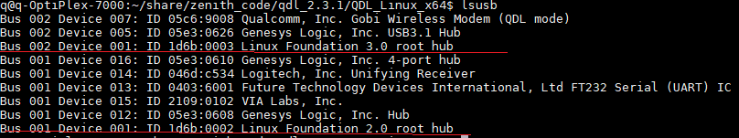

  1. After successful flashing, running the lsusb command to see device information in the terminal window, as shown in the following figure:

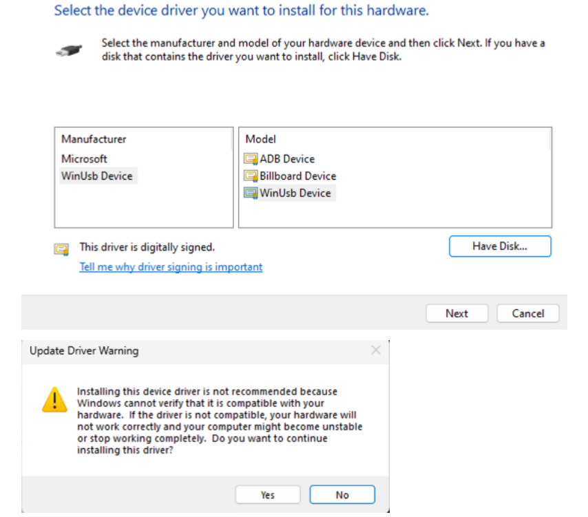

    • Select "WinUsb Device" in "Manufacturer", and select "WinUsb Device" in "Model".
    • Click "Next", and when the Update Driver Warning prompt box appears, click "Yes" to proceed with the installation.

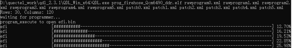

  2. Open the CMD window and use the following command to run the QDL executable file in the QDL_Win-x64 directory.
QDL_Win_x64>QDL.exe prog_firehose_Qcm6490_ddr.elf rawprogram0.xml rawprogram1.xml rawprogram2.xml rawprogram3.xml rawprogram4.xml rawprogram5.xml patch0.xml patch1.xml patch2.xml patch3.xml patch4.xml patch5.xml
The successful flashing is shown in the following figure:

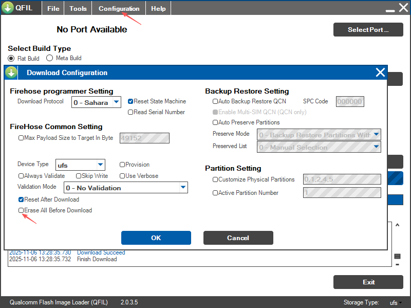

  • Please note that the "Erase All Before Download" option in the configuration cannot be ticked.

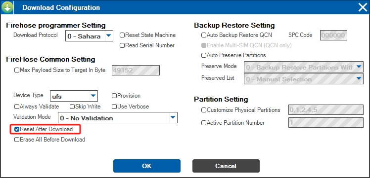

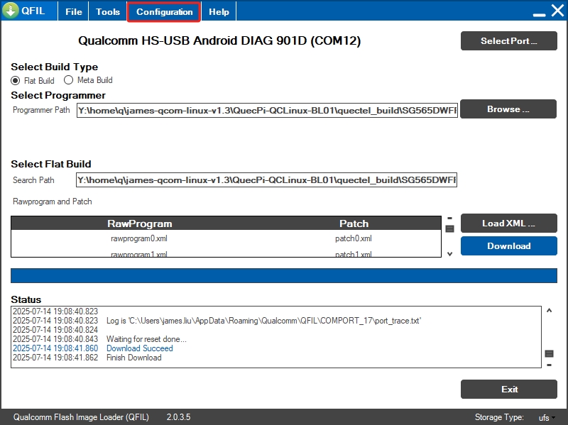

  1. Click on the "Configuration" button, click on the "FireHose Configuration" button that pops up, select the "Reset After Download" option box, and click the "OK" button.

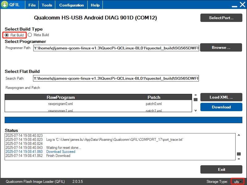

  1. Choose "Flat Build" as the build type and "ufs" as the storage type in the bottom right corner.

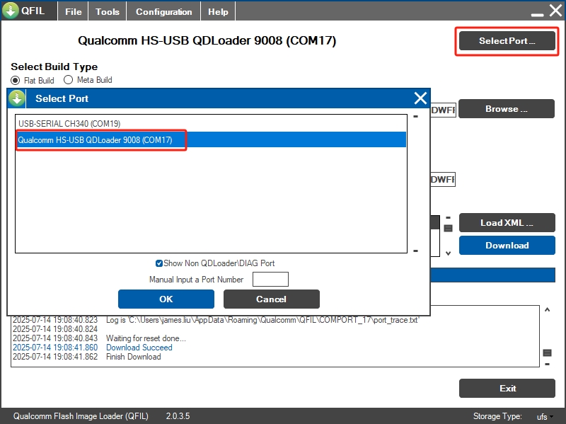

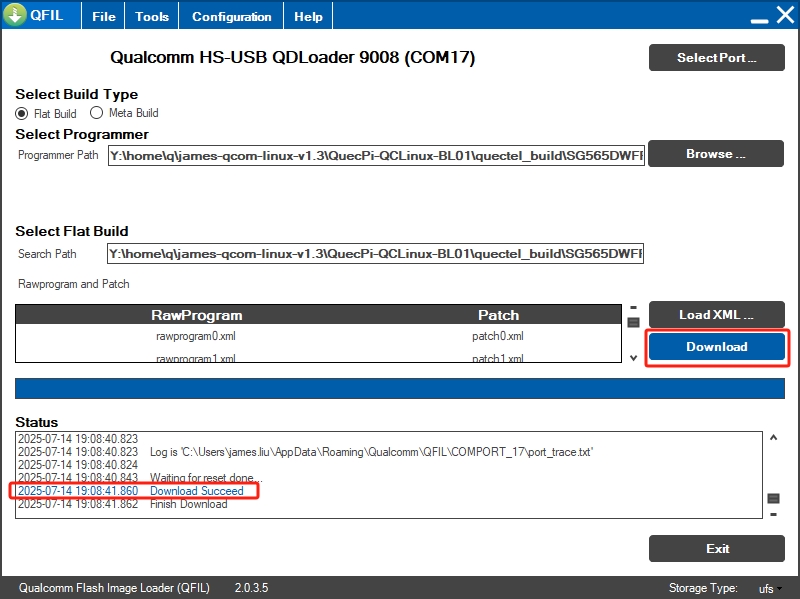

  1. Press and hold the "EMG_DOWNLOAD" button on Quectel Pi H1, power on the device, click the "SelectPort" button, select port Qualcomm HS-USB QDLoader 9008, and click the "OK" button.
  1. Click the "Browse" button and select the prog_firehose_Qcm6490_ddr.elf file.

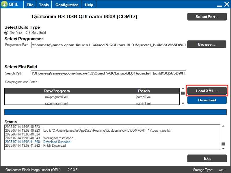

  1. Click the "LoadXML" button and select all rawprogram#.xml files and patch#.xml files.
  1. Click the "Download" button. When the words Download Succeed appear in the Status information box, it means that the flashing is successful and the system will automatically restart.
