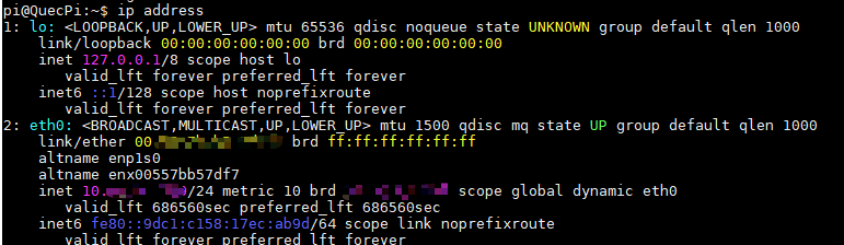

Get IP address of Quectel Pi H1 smart single-board computer
Enter the ip address command in the debug UART terminal to view the IP address of Quectel Pi H1.

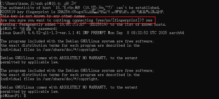

Enter the following command in the Windows console. You need to enter "yes" to confirm the connection during the connection process.
ssh <username>@<ip-address>
# Example
ssh pi@192.168.2.xxx

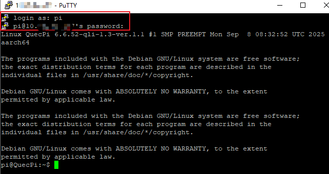

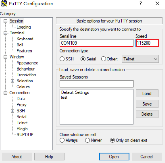

You can also use the PuTTY terminal software tool to enter the IP address of Quectel Pi H1 to log in.
Enter the username and password of Quectel Pi H1. The default user is pi.

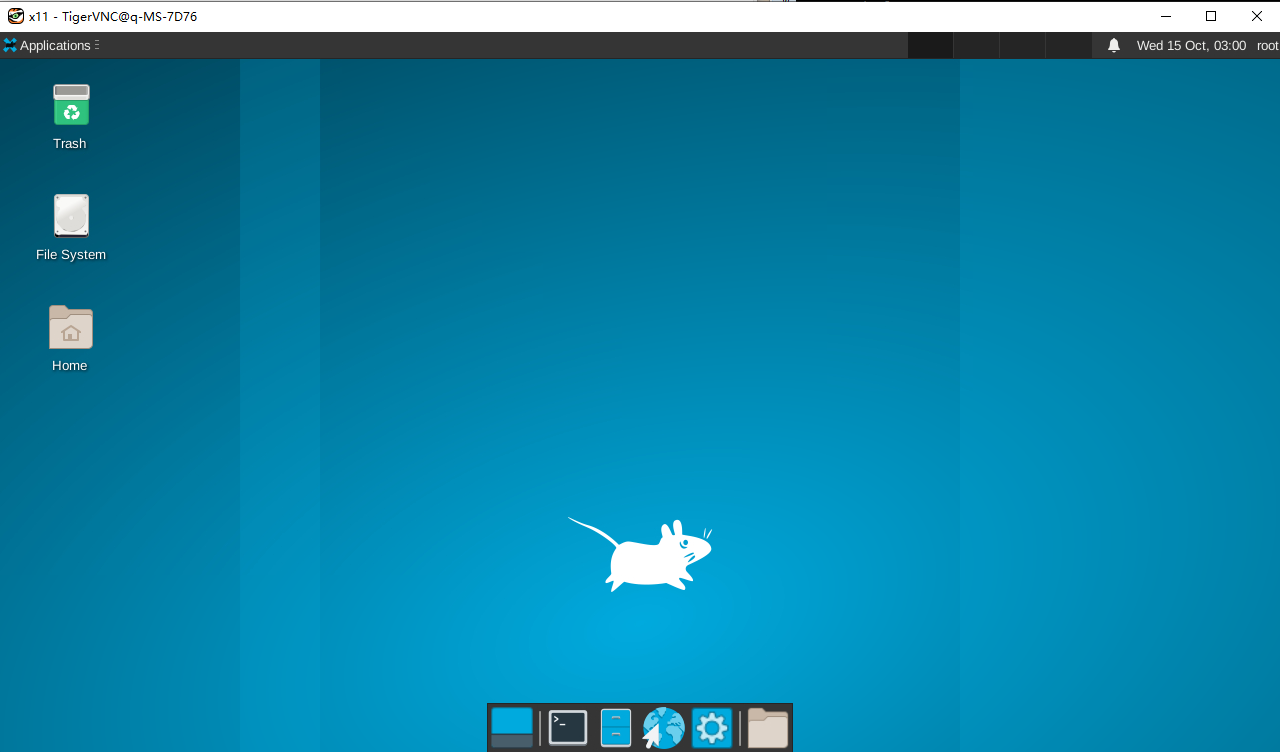

  • After successful connection, you will see the following screen.
