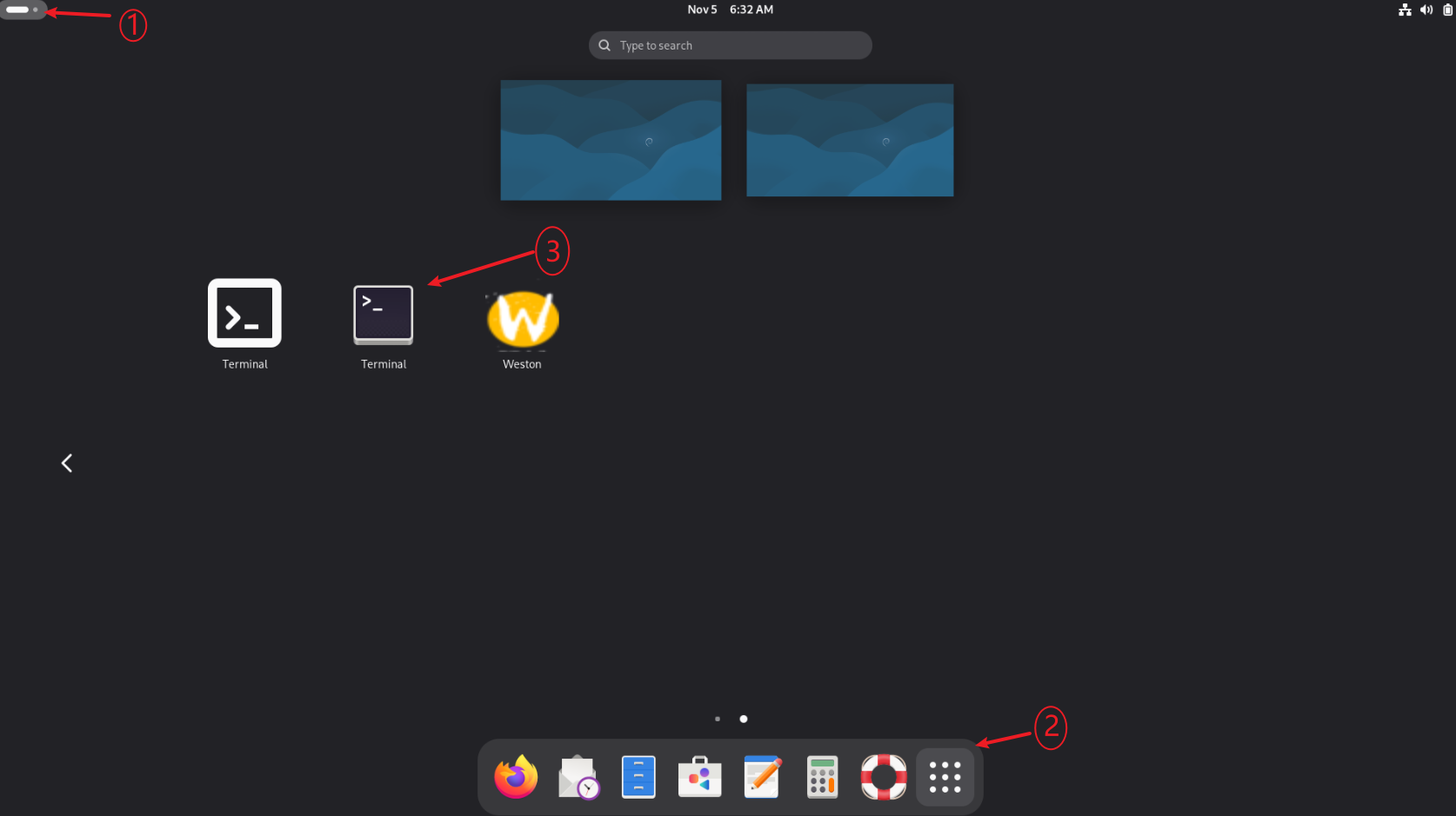

Operate on desktop of Smart Single-Board Computer
Open terminal in system applications

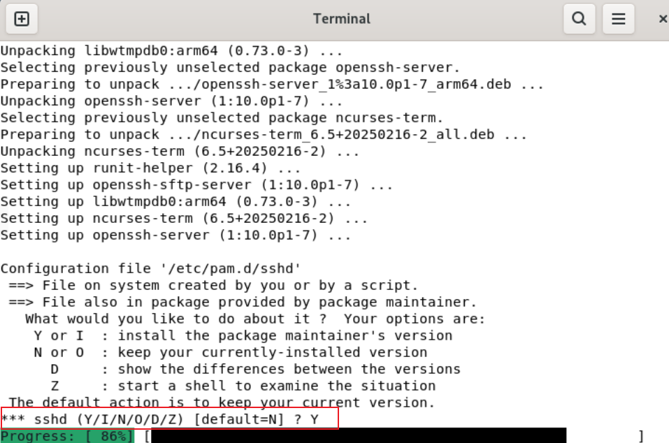

Install ssh-server service
sudo apt install openssh-server
  • If prompted as shown below, type "Y+Enter".
    image-20251108173642901

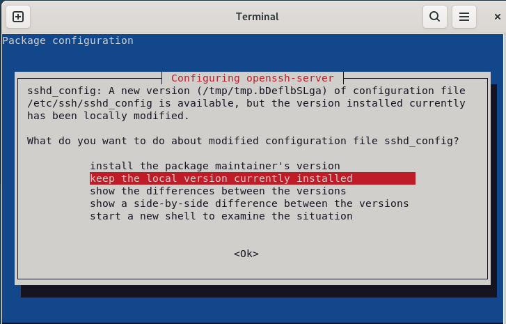

  • For any subsequent options, simply press Enter.

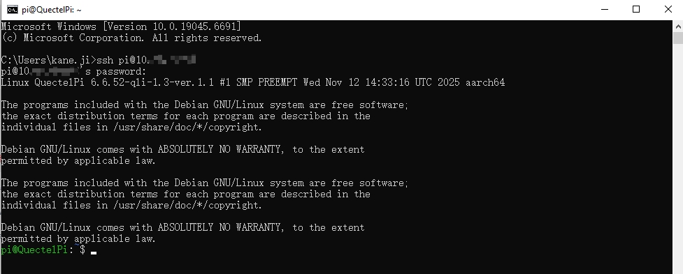

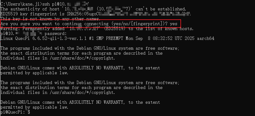

Enter the following command in the Windows console. You need to enter "Yes" to confirm the connection during the connection process.
ssh <username>@<ip-address>
# Example
ssh pi@192.168.2.xxx

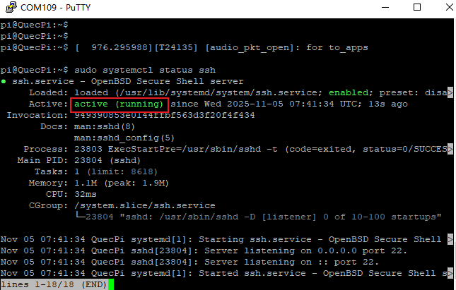

# Check service status
sudo systemctl status ssh
If the service status shows "active (running)", it indicates the service has started successfully. You can proceed to the next step.

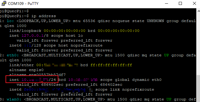

Get IP address of Quectel Pi H1
Enter the ip address command in the serial console to view the IP address of Quectel Pi H1.

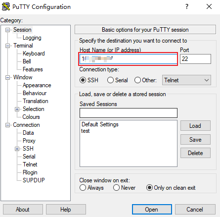

Configure SSH login

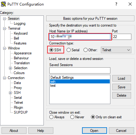

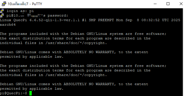

Reopen PuTTY, tick "SSH" and enter the IP address of Quectel Pi H1, then click "Open".
For the username and password settings used during login, please refer to the System Login chapter.
