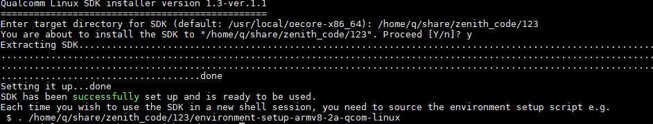

3. Select installation directory
After executing the script, the system will prompt you to enter the installation directory:
  • Default directory: Press Enter directly to use the default path
  • Custom directory: Enter your target installation path
After installation is complete, the script will prompt you with the SDK environment activation method.
4. Deployment example
Toolchain Deployment Example
