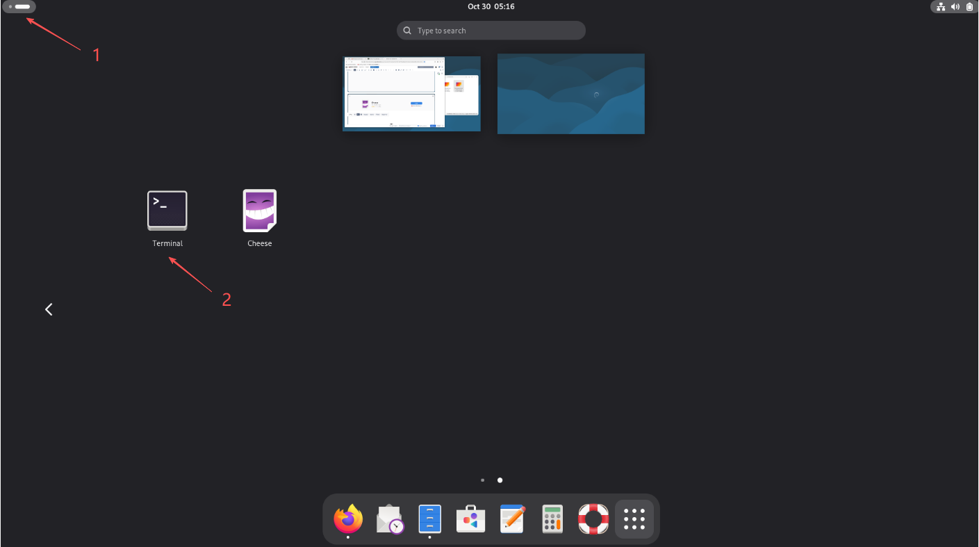

It can be installed through the terminal command line apt tool.
As shown in the following figure, click the corresponding icon in sequence to enter the terminal command window:

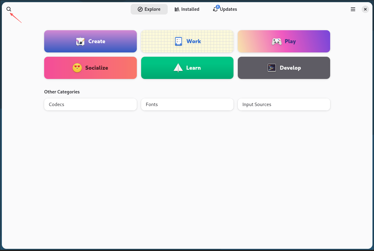

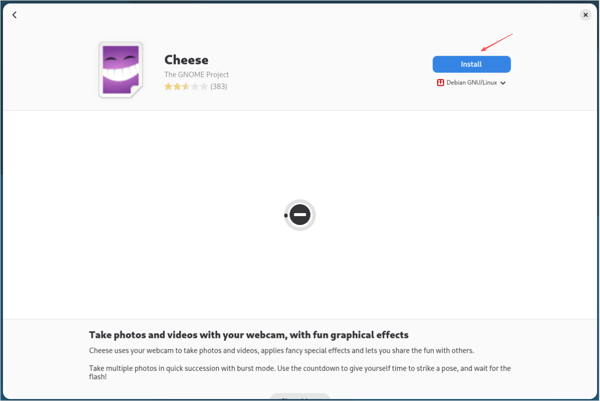

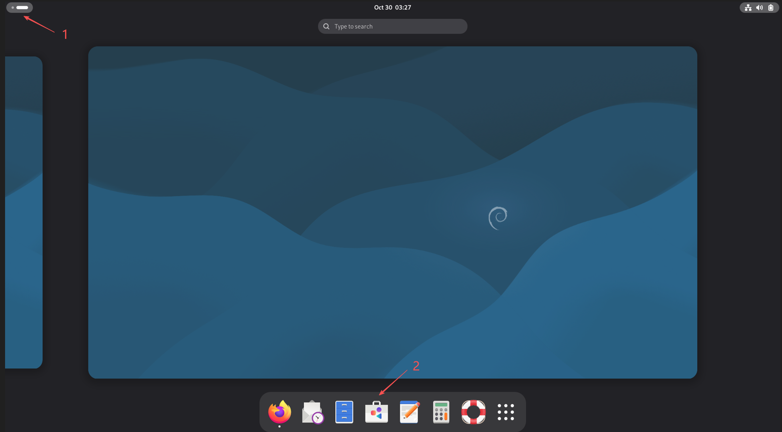

Software mall
Click on the desktop icons in the sequence shown in the figure below to enter the software package app. You can click on the search box to find the corresponding software package and proceed with the installation.
The installed app can be viewed by clicking "Installed" button at the top.
Upgradeable app can be viewed by clicking "Updates" button at the top.
