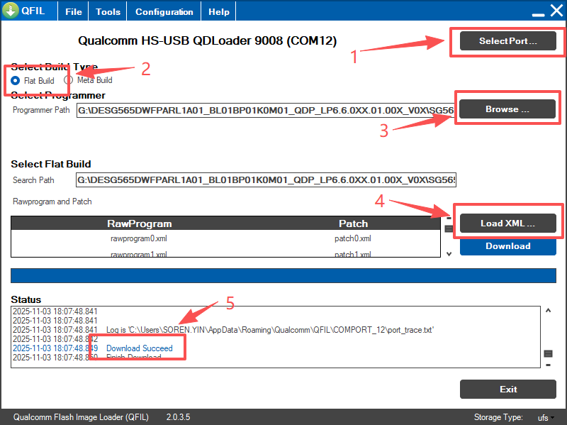

QFIL image flashing
If you have QFIL flashing software installed on your computer, you can use it to flash images.

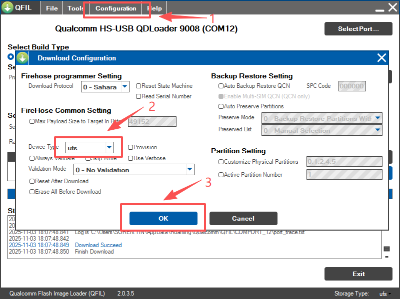

Configure QFIL
Click the menu bar ToolsConfiguration, and make the following settings in the configuration window:
  1. In Device Type, select ufs.
  2. In Validation Mode, select 0 - No Validation.
  3. Click OK to save the configuration.
Flashing steps
1. Select port
  • Long press the EMG_DOWNLOAD button on Quectel Pi H1 and power Quectel Pi H1 on at the same time.
  • Click the SelectPort button, select the 9008 port, and click OK.
2. Select build type
  • In Select Build Type, select Flat Build.
3. Select programmer file
  • Click the Browse button.
  • Select the prog_firehose_Qcm6490_ddr.elf file.
4. Load XML configuration files
  • Click the Load XML button.
  • Select all rawprogram*.xml and patch*.xml files.
5. Start flashing
  • Click the Download button to start flashing.
  • When the Status area displays Download Succeed, it indicates successful flashing.
  • The system will automatically restart.
